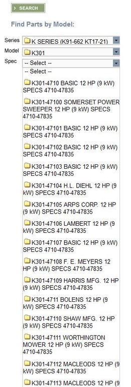

pfrederi 21,297 #3 Posted August 3, 2017 (edited) http://www.kohlerenginesparts.com/PartStream/Index click on the find parts by model then pick K series and then the model number. Use edit find to see the spec ## will say who it was made for. Edited August 3, 2017 by pfrederi 2 Share this post Link to post Share on other sites
