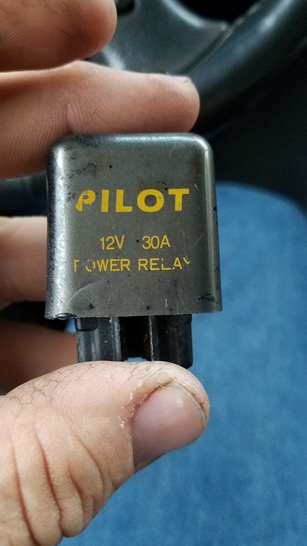

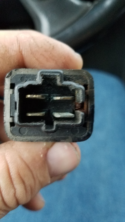

Docwheelhorse 2,992 #1 Posted August 2, 2017 Hello All, Im posting this here because its electrical... no its not related to W.H. so if mods move or kill it I understand... Long story short my best friend passed, his family gave me his boat. Went to get it running and no crank... Found this relay being used as starter assist --the voltage drops too much in 25' boat harness and starter solenoid wont kick in. So these relays are put in so when you turn key they activate and have a heavy guage wire that throws plenty of juice to starter solenoid. I got a replacement but the 4 terminals arent labled... I think its generic to all 4 post relays. But does anybody know for sure? The stupid relay is NLA and hard to find. I have 10 ga +12 volts, Ground, key switch power in to activate and finally the heavy wire going to starter... just dont know where each belongs. Thanks Tony Share this post Link to post Share on other sites
JPWH 6,544 #2 Posted August 2, 2017 You should have a coil that will show resistance with an ohm meter across 2 terminals this should be from the switch. and the other 2 terminals should read open for the battery to starter. Is there a diagram on one side? There should be numbers at the terminals. 4 Share this post Link to post Share on other sites
953 nut 68,179 #3 Posted August 2, 2017 It has a standard "Molex" socket that will only allow it to be inserted in the proper orientation. Goof proof unless some one has cobbled the wiring. You can get one at any good auto supply store for about $ 7.00. 3 Share this post Link to post Share on other sites
Docwheelhorse 2,992 #4 Posted August 3, 2017 Well, I wouldnt say "cobled"... boats original plug rotted and wiring ends replaced with high quality sealed 1/4 female terminals . So... does anybody know pinout for "standard molex connector" Share this post Link to post Share on other sites
953 nut 68,179 #5 Posted August 3, 2017 Terminals numbered 85 and 86 will be the coil, the other two are the switched terminals. One of them will go to ground and the other will be switched by the ignition switch. Since you don't have a socket to plug it into I would suggest you buy a relay and compatible pigtail socket. Any 30 amp single pole 12 volt relay will work for you. 4 Share this post Link to post Share on other sites

Docwheelhorse 2,992 #8 Posted August 3, 2017 Hi, I received 2 of this exact relay... both in sealed packages. No schematic anywhere... wanted to think it would be universal wiring. Guess Ill contact company and see if they will tell me... or... I found a dorman relay with 4 posts and a schematic. Siggghh why isnt anything easy. Tony Share this post Link to post Share on other sites

953 nut 68,179 #11 Posted August 3, 2017 You could just conduct a little experiment, take two wires with spade connectors on them that will fir the relay. Connect one wire to the "+" terminal of a 12 volt battery and the other to the "-" terminal of the same battery. Now systematically place the "-" terminal on one of the posts and touch the "+" terminal to each of the other posts. If you hear a click the two posts that produced the click are the 85 and 86 posts. If there is no click then randomly select another post for the "-" and repeat the process; may have to do this up to three times. If you don't get a click by the third time the coil in the relay is probably shot! 3 Share this post Link to post Share on other sites
N3PUY 1,031 #12 Posted August 3, 2017 Take the relay apart .... remove the cover .... see what terminals do what. Hook it up. replace cover. 2 Share this post Link to post Share on other sites

Rob XC700 75 #15 Posted August 20, 2017 (edited) I did a search for your relay. Go to this Honda forum. http://www.superhonda.com/forum/f13/bumper-light-conversion-yay-145446/ Scroll down "WaLLeYeMan", This looks like the layout of your relay. The connector shell has been cut away, but the terminal layout looks the same. Connect them like 953 nut suggests. and see if it works. Most relays are all laid out the same way. Typically with the numbers on them, and one terminal turned sideways (87). But, not yours, so this one may match yours. You can also do as JPWH suggests and use this diagram to test terminals with an OHM meter. Edited August 20, 2017 by Rob XC700 1 Share this post Link to post Share on other sites
