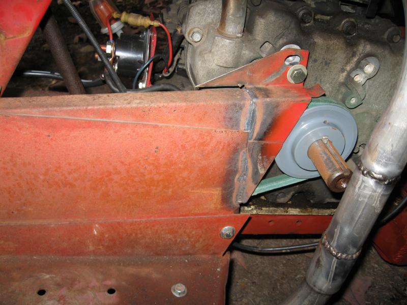

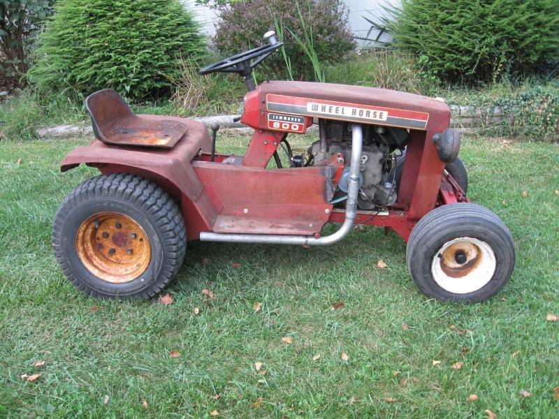

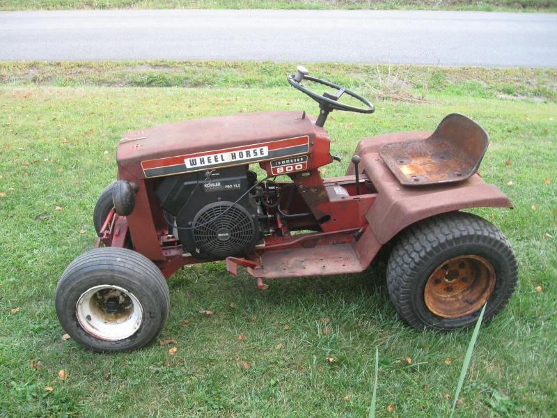

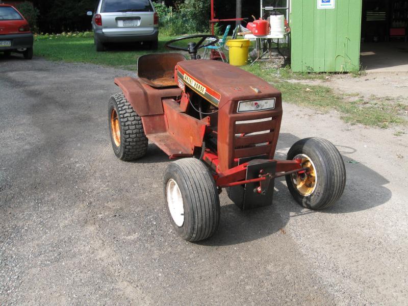

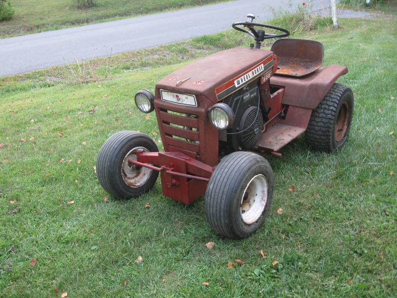

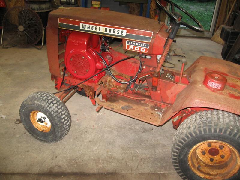

N3PUY 1,031 #2 Posted August 1, 2017 I put a Command 11.5 into a Commando 800. It fit without problems. Had to modify the belt guard a little. 1 1 Share this post Link to post Share on other sites
slim67 2,825 #3 Posted August 1, 2017 1 hour ago, N3PUY said: I put a Command 11.5 into a Commando 800. It fit without problems. Had to modify the belt guard a little. Thanks for the info. Cool tractor! Can I trouble you for some pics? 1 Share this post Link to post Share on other sites

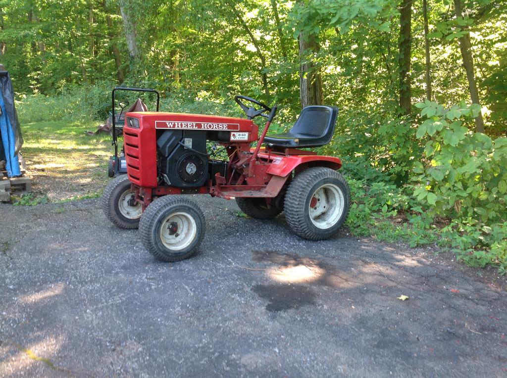

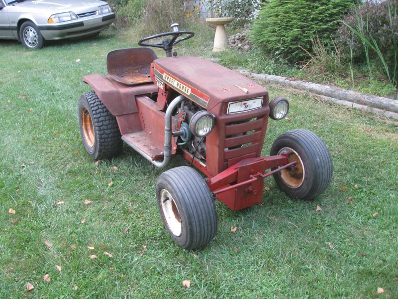

slim67 2,825 #5 Posted August 13, 2017 I did the engine swap and am quite happy how well it turned out. I was able to reuse everything that came off the cub except for the huge muffler I need to modify or search for something that will work. I need to hook up the throttle cable, wire the lights and cover the wiring with some corrugated wire sheath. I have a set of wheel weights to put on that are 105 lbs apiece and two more 40 lb plates that I can stack on top those. I recently picked up a nice set of 6-12 ags but they just don't look right on these style tractors with the wide front axle so I will wait for the rears to blow out from dry rot then replace them. This one is going to be a worker around my yard. 4 1 Share this post Link to post Share on other sites
