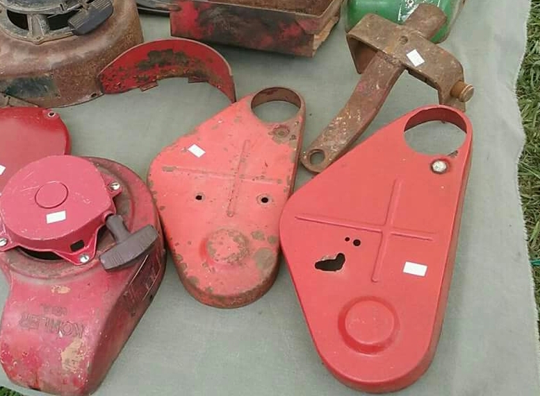

Tgtack 779 #1 Posted July 29, 2017 Take a look at the two triangular belt guards, what model tractor do they fit? Trying to find one for a model 401/551, but not sure which one it would be. Thanks Share this post Link to post Share on other sites
Racinbob 13,131 #2 Posted July 29, 2017 Those are the correct guards for the 401 and 551. Share this post Link to post Share on other sites
Tgtack 779 #3 Posted July 29, 2017 2 hours ago, Racinbob said: Those are the correct guards for the 401 and 551. Has to be one or the other, I am thinking is the small one. Share this post Link to post Share on other sites
stevasaurus 23,836 #4 Posted July 29, 2017 Maybe the small one is for the 401 and the larger one is for the 551?? Share this post Link to post Share on other sites

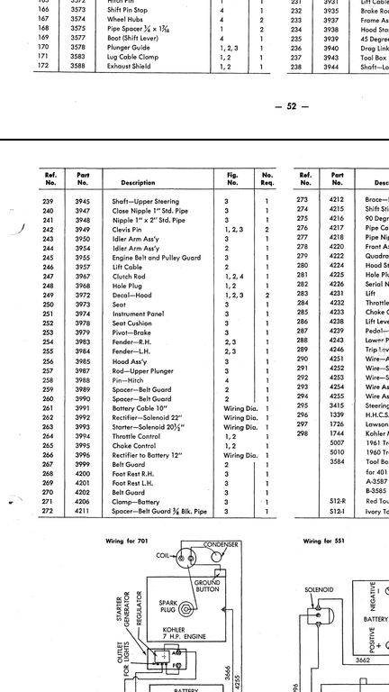

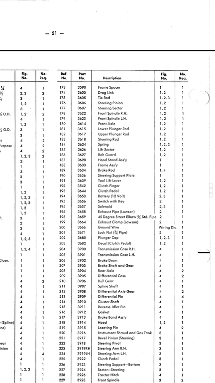

Tgtack 779 #5 Posted July 29, 2017 401 takes a 3627, and 551 takes a 3999, so I think Stevasaurus is correct. I thought they took the same, but not according to the parts drawing. Share this post Link to post Share on other sites
Racinbob 13,131 #6 Posted July 29, 2017 Interesting. I thought the picture angle made them look like different sizes and the different part numbers were because of the way they mounted with the different motors. Another first for me. 1 Share this post Link to post Share on other sites
Racinbob 13,131 #7 Posted July 29, 2017 You've got me curious. My parts list shows a 3955 for both 2 Share this post Link to post Share on other sites

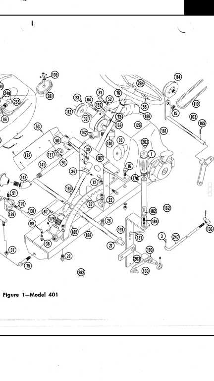

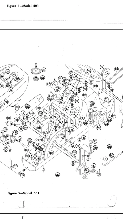

Tgtack 779 #8 Posted July 29, 2017 27 minutes ago, Racinbob said: You've got me curious. My parts list shows a 3955 for both Racinbob, the manual I looked at was the one that covers numerous models from I think 58 through 64 round hoods. See screen shots. Model 551 item 267 in first two pics. Model 401 item 186 in next two pics. Share this post Link to post Share on other sites

Racinbob 13,131 #10 Posted July 29, 2017 I think I need to get drunk That's not the first time there's been dueling part lists and numbers. The 3627 is the one for my 400. It measures 13" x 7.25". How about somebody measuring theirs. I always thought the only difference between the 60 and 61 guards is that the 60 just has one stiffening ridge and the 61 has crossed ridges. 3 Share this post Link to post Share on other sites
