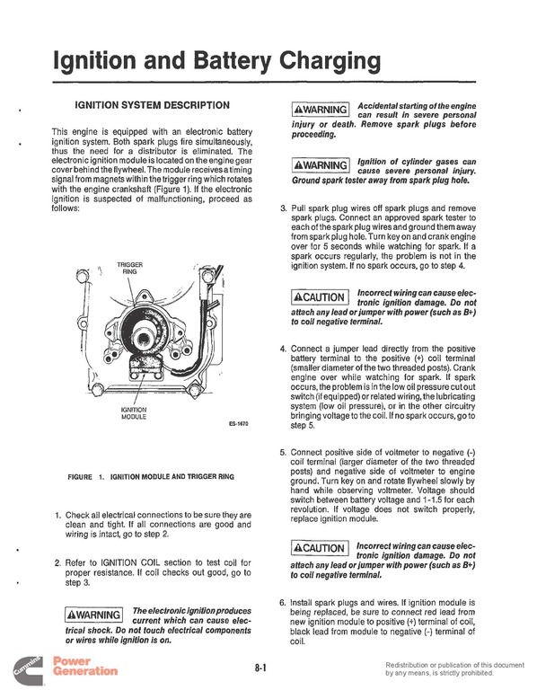

onanparts.com 185 #2 Posted July 28, 2017 Just now, budman2 said: Hi yall! can anyone tell me the part numbers for the 1995 20hp onan modual and rotor? Have tried everything, for over a month, but replacing these! hear they are very pricey! Thanks in advance, budman2 Sure can! Rotor is a 166-0767 and the module is a 166-0785. Have you done the module test in the manual? Ignitiontest.pdf 2 Share this post Link to post Share on other sites
