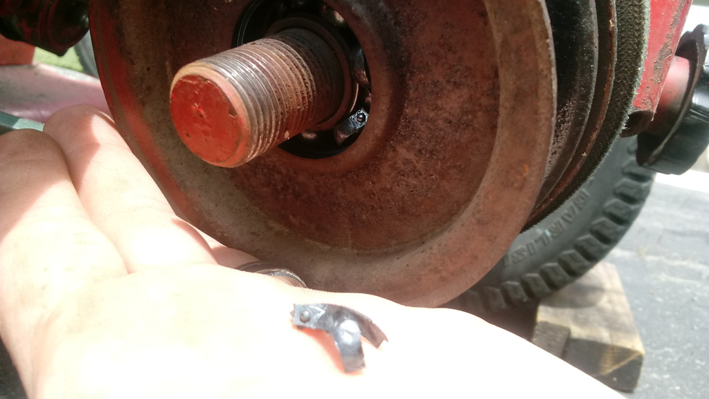

Mt Zion 520H 43 #1 Posted July 27, 2017 Anyone ever have this happen? Noticed belt smoking.. Investigated pulley spin difficulty and this one was rough. Dismantling shows pc's of twisted metal.. I put new deck belt couple weeks ago. I have new blades coming today in mail and now this crap. It's being a pain to remove also. Any tips? And what brand or part number? It's a 97 520H Share this post Link to post Share on other sites
Thisguyisnew 114 #2 Posted July 27, 2017 If you don't have a puller bust and pry out the bearings contents. This should allow you to slide off the flat idler pulley's housing... Then put a pipe wrench on what is left on shaft and twist it off with penetrating oil 1 Share this post Link to post Share on other sites
Mt Zion 520H 43 #3 Posted July 27, 2017 Thanks newguy. Lol. Bearing says TPI 6203LU TAIWAN Can i order just a bearing n press into pulley or better to just buy whole thing new?? Share this post Link to post Share on other sites
Thisguyisnew 114 #4 Posted July 27, 2017 (edited) kind of? You'd have to split it at the spot welds and weld it or bolt it back together after install. I'd buy one complete Edited July 27, 2017 by Thisguyisnew 1 Share this post Link to post Share on other sites

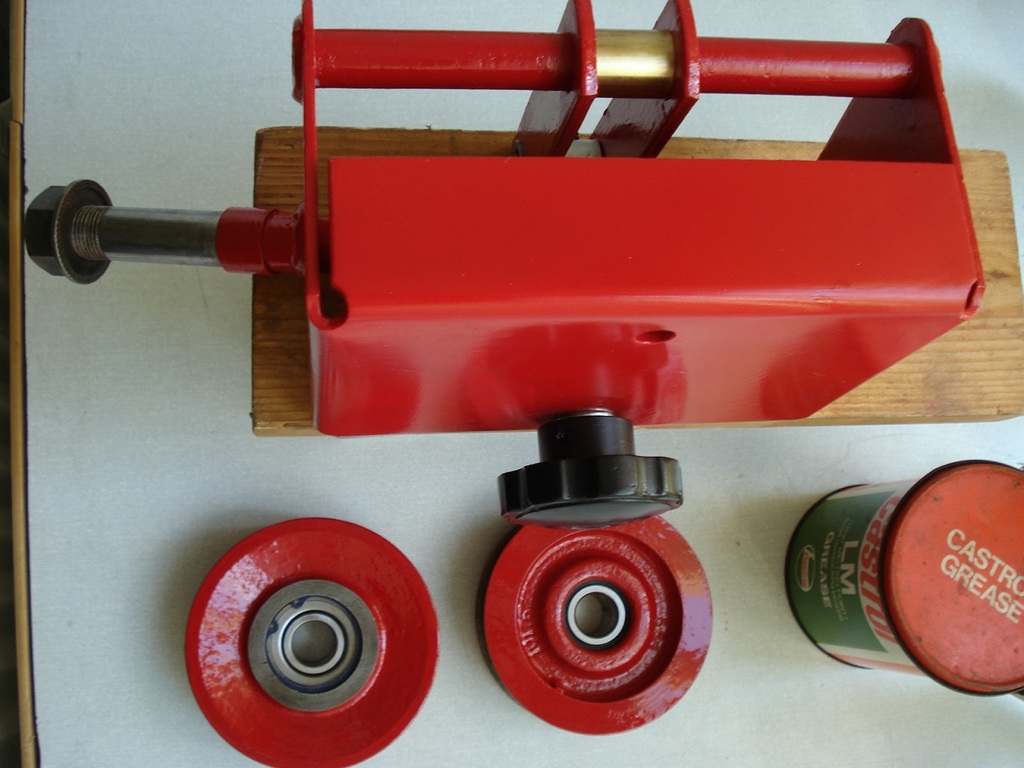

Anglo Traction 761 #5 Posted July 27, 2017 Look's like you have the Pressed Steel with Captive Bearings. Older versions were Cast Iron with replaceable Bearings like this- You will probably be wise to replace both, in which case you'll need examples in this -LINK- Regards 2 Share this post Link to post Share on other sites
Mt Zion 520H 43 #6 Posted July 27, 2017 Thanks again. Since i needed to finish up the lawn.. I pulled the broken pc's i could see out. Put everything back together and ran her again around the property mowing. After 1 lap; pulley locked up again. Lol. Pulled apart again and saw more broken metal pc's.. So i pulled the rest of em out. Nothing left in there but some ball bearings. Guess the metal i pulled were some sort of ball dividers... But i ran it again and managed to finish the other half of the 2 acre property with it and no issue. At least i got to finish and can now order the part needed. Lol. Thanks Anglo. Much appreciated. 1 Share this post Link to post Share on other sites
