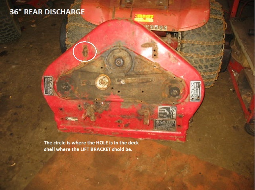

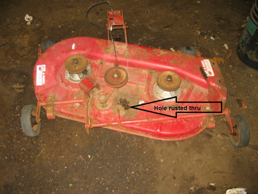

daveoman1966 3,884 #3 Posted July 24, 2017 If the deck has 3 spindles (blades), then it is a 36" deck. If only 2 spindles (blades), then it is a 37" The 37" also has the deck spindles on TOP of the deck...36" decks, the spindles are bolted onto the bottom side. Here is a 36 and a 37 deck 1 Share this post Link to post Share on other sites
