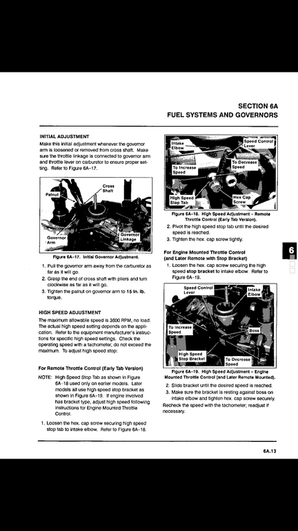

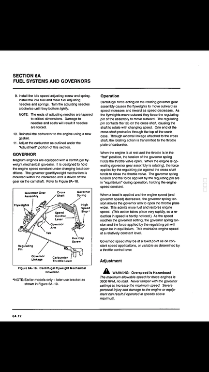

Tgtack 779 #2 Posted July 23, 2017 Here is the link to the service manual. See section 6A. Also three screen shots of the 3 pages. http://www.wheelhorseforum.com/files/file/35-engine-kohler-magnum-m18-m20-sm-tp-2204-bpdf/ 1 Share this post Link to post Share on other sites

roy 13 #7 Posted July 25, 2017 Thanks for the welcome all, I tried to print those pages/pics you posted, but, so small I just can't make em out & if I put size up to 150%, the printed letters get all distorted! I will try & print those pages directly from the manual, see if this works. I know its a governer issue, I had a guy, who seemed to know what he was doing, adjust it, big mistake! I will post a pic. of throttle related hook up, when home Again, Thanks for the tips, 2 Share this post Link to post Share on other sites
