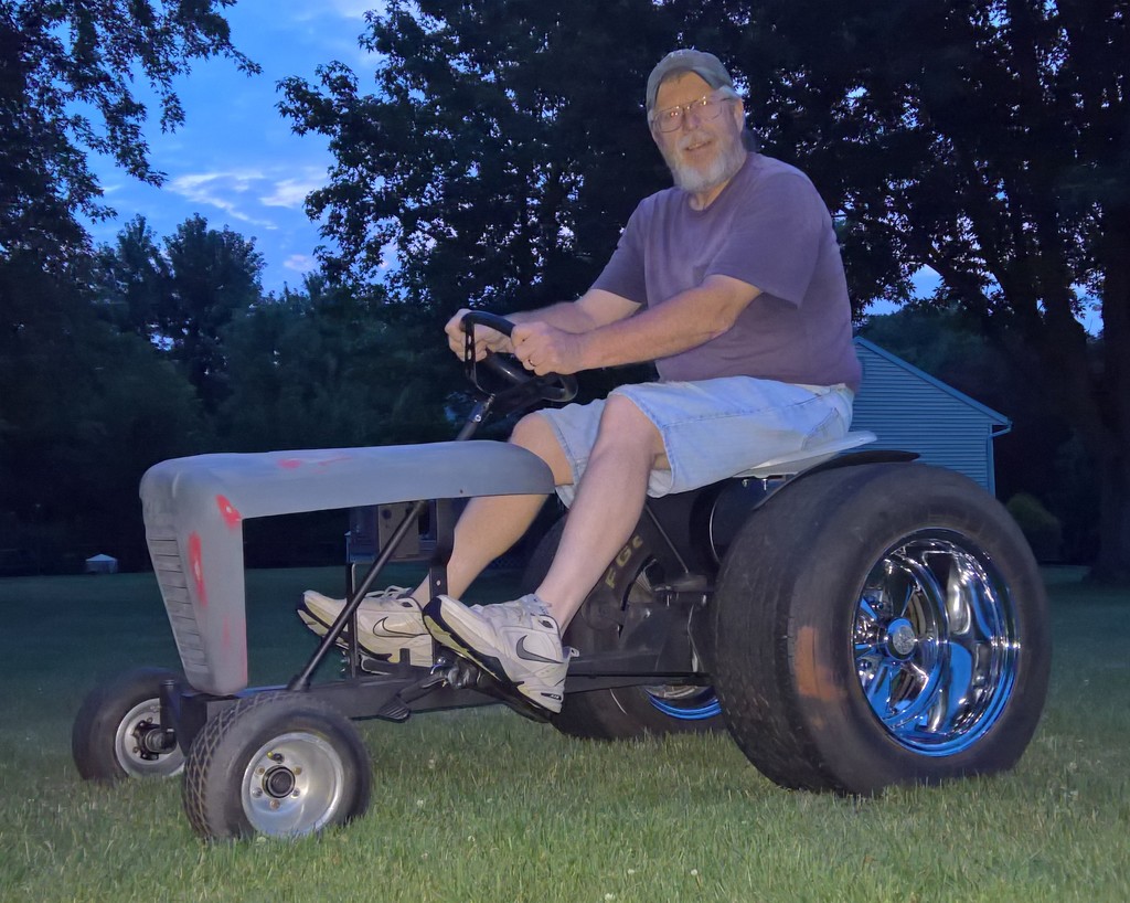

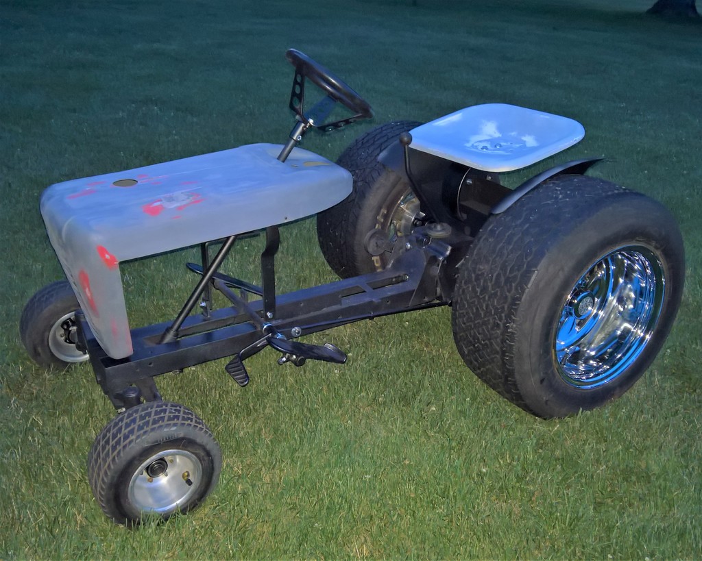

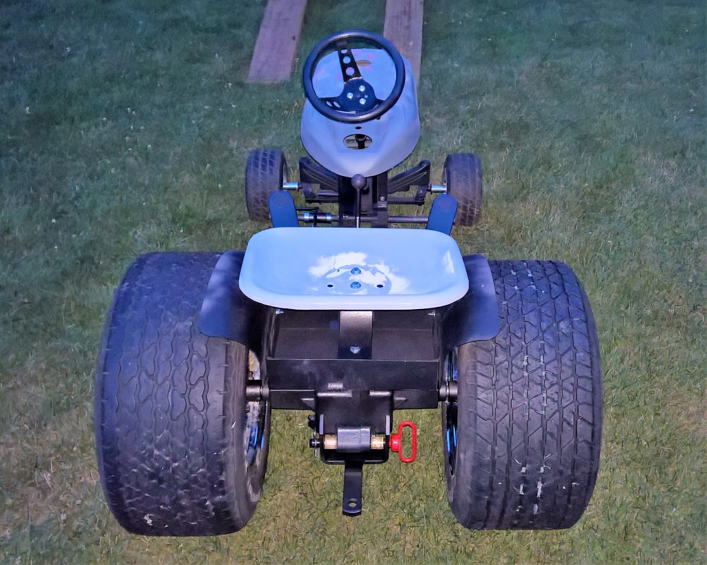

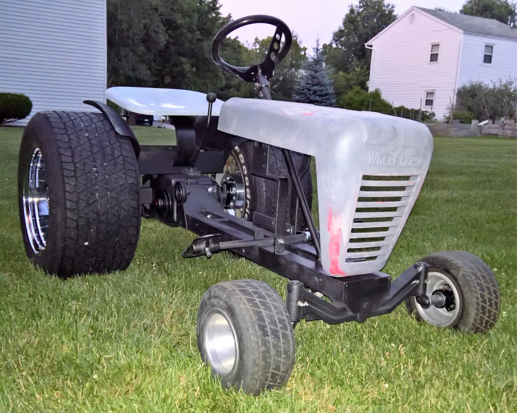

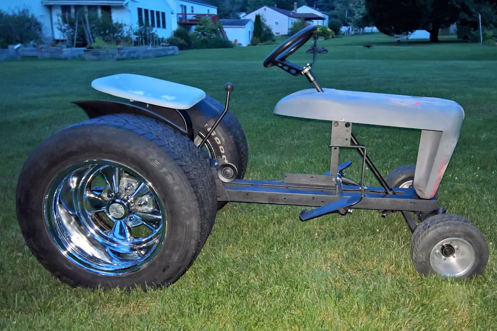

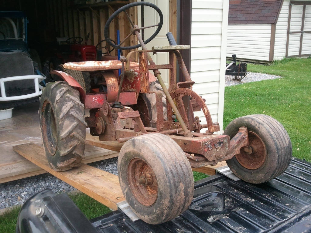

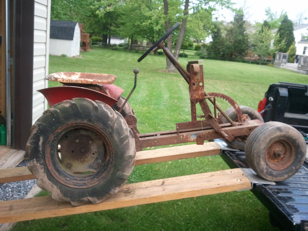

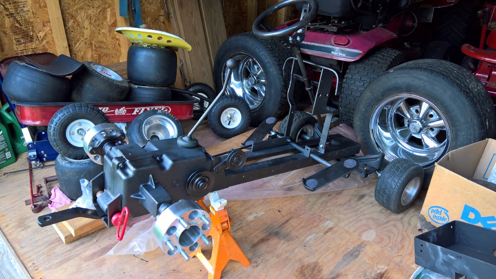

cruisnblue48 880 #1 Posted July 21, 2017 (edited) I previously had another thread going when I started my hot rod project. But here now is an updated thread. I pulled what was left of a 1961 model 551 Wheel Horse out of a wooded lot about five years ago, May 2012... Craigslist find about 30 miles from my home... Since then, I been working off and on rebuilding this tractor into a hot rod project. This past year, I completely disassembled the transaxle and replaced all internal bearings and seals. Anyway, this is where I am now... The frame and transaxle are now painted metallic black. The frame was "stretched" about 4". Custom items mounted so far include a go-kart racing steering wheel, quarter midget front wheels/tires, and aluminum rear wheel spacers for mounting Cragar rear wheels. Just yesterday, I temporarily bolted on the seat, fenders and hood to check for fit and clearance before those items get a final coat of metallic red paint... So, this project is now on the front burner and I am hoping to get more done to it in the coming weeks. Stay tuned... Edited July 21, 2017 by cruisnblue48 26 Share this post Link to post Share on other sites

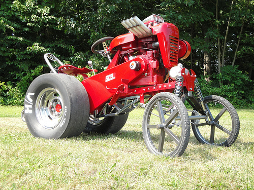

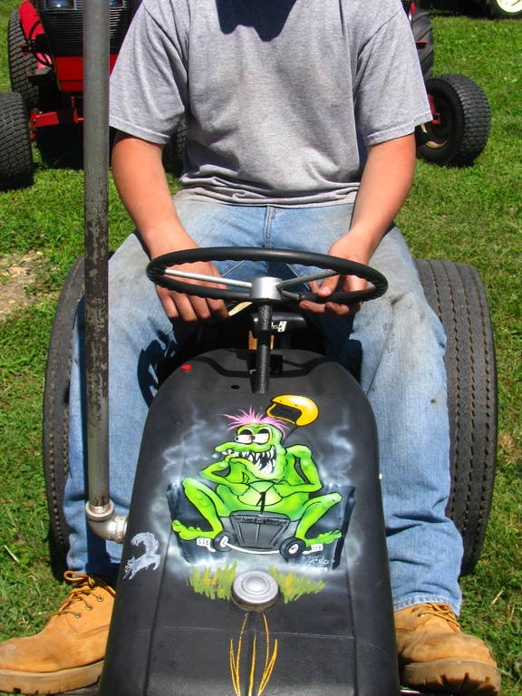

Electro12WH 50 #20 Posted July 26, 2017 On 7/21/2017 at 8:32 AM, cruisnblue48 said: So, this project is now on the front burner and I am hoping to get more done to it in the coming weeks. Stay tuned... This is looking an awful lot like a Rat Rod build that was on here some years ago. It had a blown engine and a high stick shift inspired by Daddy Roth. Oh yeah! 2 Share this post Link to post Share on other sites
squonk 47,998 #21 Posted July 26, 2017 6 hours ago, Electro12WH said: This is looking an awful lot like a Rat Rod build that was on here some years ago. It had a blown engine and a high stick shift inspired by Daddy Roth. Oh yeah! RATFINK! 1 1 Share this post Link to post Share on other sites
AMC RULES 37,259 #22 Posted July 26, 2017 Was thinking of that one too. 4 Share this post Link to post Share on other sites
Electro12WH 50 #23 Posted July 27, 2017 Yeah, I remember that one, too. But the other one was red and was jacked up high with a chrome front axle. Share this post Link to post Share on other sites
19richie66 17,932 #24 Posted July 27, 2017 (edited) This one? Wasn't that Horsefeather's? Edited July 27, 2017 by 19richie66 4 1 Share this post Link to post Share on other sites
Electro12WH 50 #25 Posted July 27, 2017 Yeah! That's it. Amazing build. Share this post Link to post Share on other sites
