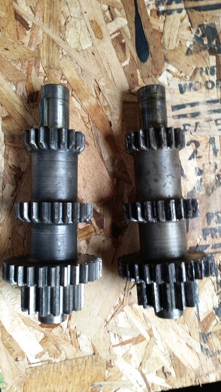

Racinbob 12,043 #5 Posted July 21, 2017 I had a little plumbing job to do today. I told my wife I'd only have the water off about an hour. Well.......six hours and three trips to Lowes later I got it back on Finally it was time to go 3525 cluster gear hunting. I've got two of them. They are both usable but do have some wear. Check them out and see if they are better than what you have. 2 Share this post Link to post Share on other sites
stevasaurus 23,355 #6 Posted July 21, 2017 The one on the right looks pretty good Bob!! 1 Share this post Link to post Share on other sites
Michigandog 0 #7 Posted July 23, 2017 On July 21, 2017 at 2:57 PM, Racinbob said: I had a little plumbing job to do today. I told my wife I'd only have the water off about an hour. Well.......six hours and three trips to Lowes later I got it back on Finally it was time to go 3525 cluster gear hunting. I've got two of them. They are both usable but do have some wear. Check them out and see if they are better than what you have. The one on the left looks pretty much what I have, the on one the right looks good. I have one coming from ebay, if it doesn't work I will buy yours... Share this post Link to post Share on other sites

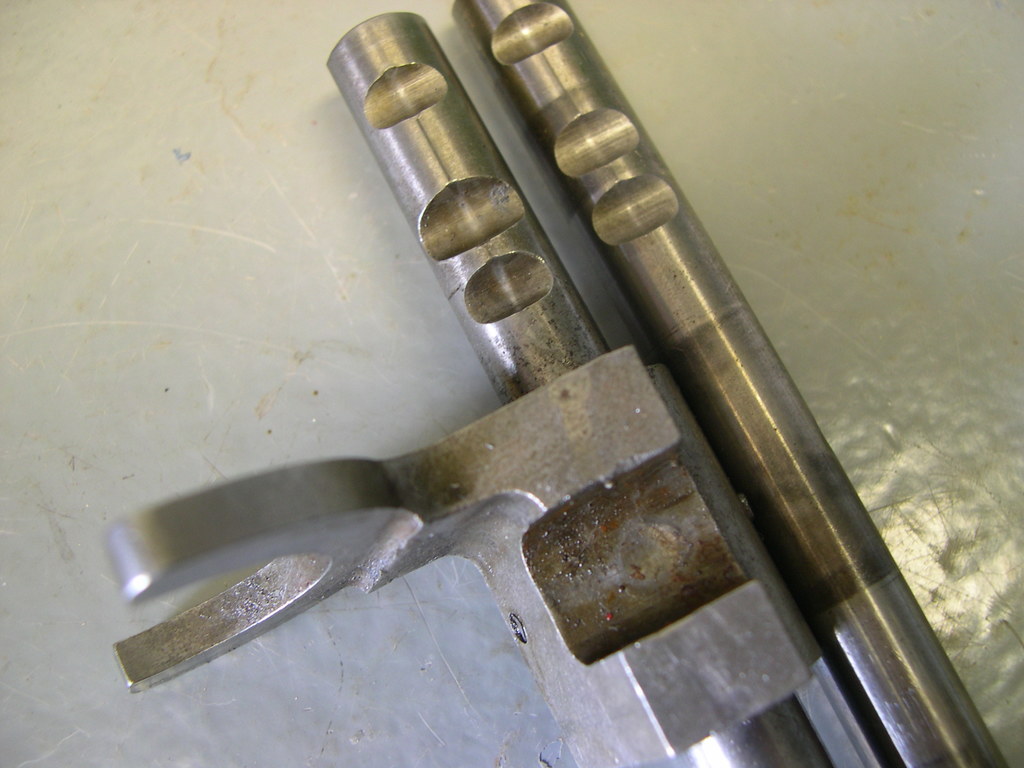

Racinbob 12,043 #8 Posted July 24, 2017 Just a suggestion since you have it apart. Check your shifter rails. If the three detents are the same depth I would scrounge up some later rails that have a deeper neutral detent. Install those as well as a 3/4" stop pin in lieu of the 11/16" that you'd have if all the detents were identical. Later on they went to rails with the detents going all the way around the rail. Those would work as well. 1 Share this post Link to post Share on other sites
