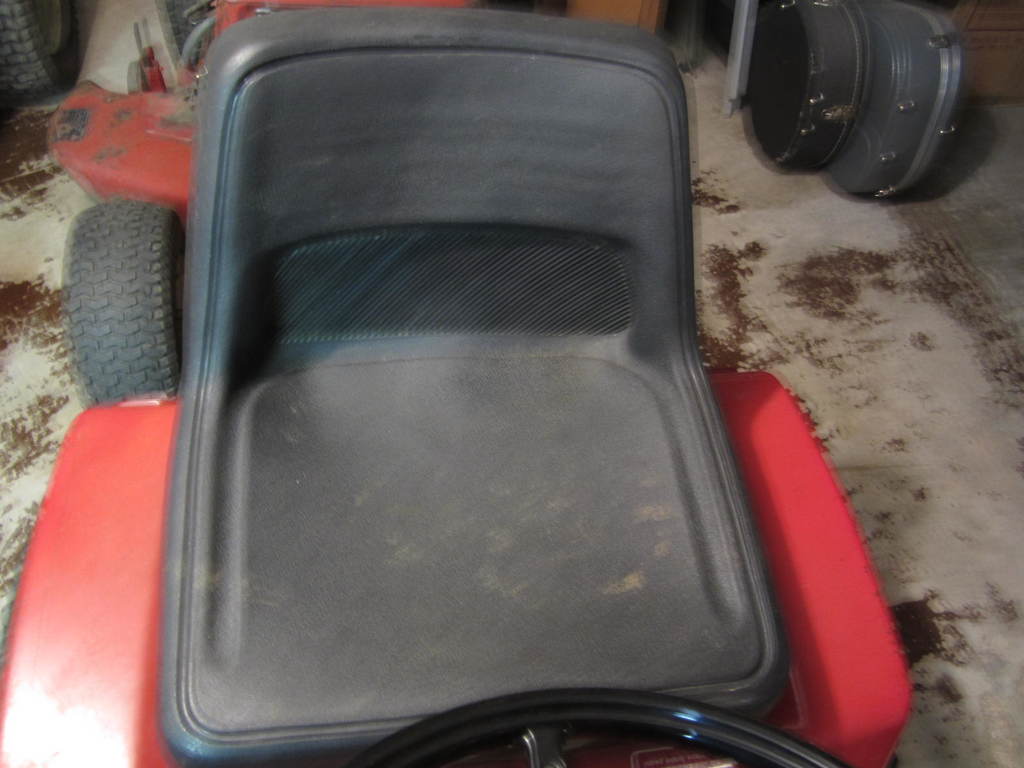

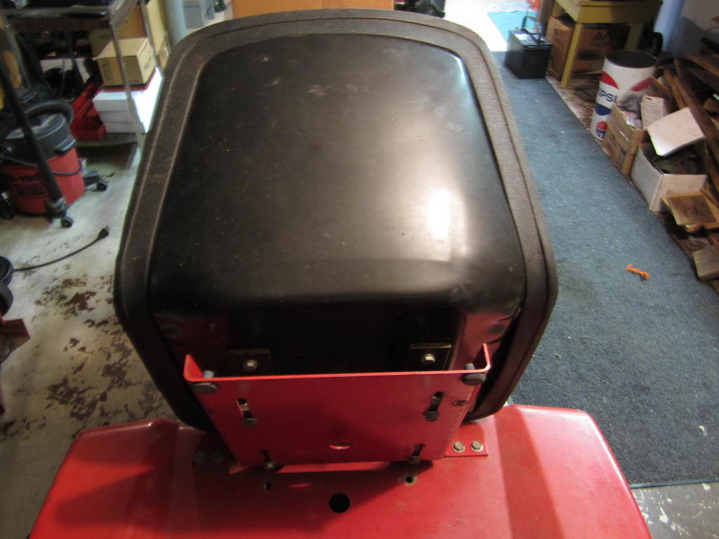

TDF5G 2,074 #3 Posted July 19, 2017 (edited) 2 hours ago, Sarge said: If that model doesn't already use them , I use the C-series U-shaped seat springs and either re-drill them back further or add an extension plate . Some seats have multiple bolt patterns in the seat bottom - maybe yours can be moved back that way . It's amazing how much just an inch or two helps , adding height changes it even more . I'm in the same boat and have had more than enough knee surgeries done ( each, twice) so I totally get where you're coming from . Due to lower back issues and just generally a spine that's falling apart I'm headed down the road of a suspension seat no matter what the cost - or I can't run the tractors here in the near future , something to consider . Sarge Some after market brands of seats have mounting holes in different spots also. I attached a pic of a seat that was on one of my tractors from PO and it sets back farther than the original seats. I don't know the brand of it though. I have to have it adjusted all the way forward to reach the pedals, as the seats, I have to adjust them all the way back. It also shows the u-shape springs that sarge mentioned. Edited July 19, 2017 by TDF5G 3 Share this post Link to post Share on other sites
