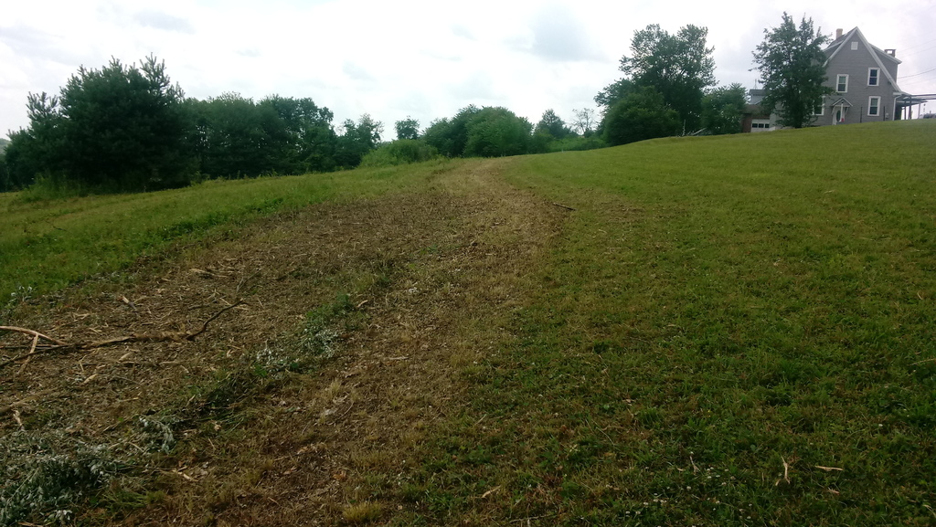

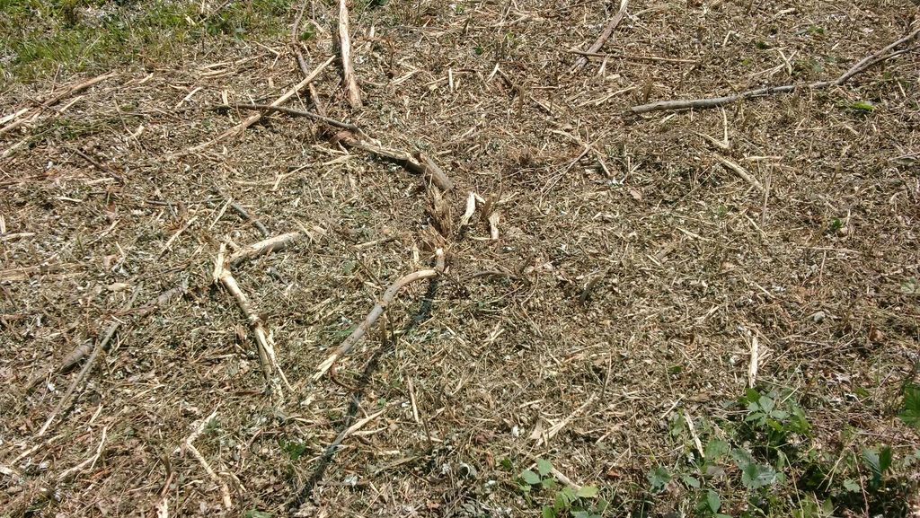

Mt Zion 520H 43 #1 Posted July 18, 2017 So; i've got a few questions. Lol. Neighbor across street got permission to level off some brush behind me and i'm wondering if it's now safe to go over it with my 520-h?? Pic being posted to give an idea of what ground looks like now. Can the horse handle it safely?? If so; the slower the better i'd imagine right?? I'd imagine probably best to shave off 1 - 2 ft at a time instead of trying to run the whole 48" over at once right?? Sharp blades to cut or not so sharp to whack/chop?? Any tips or tricks and advice greatly appreciated brothers. Share this post Link to post Share on other sites
WVHillbilly520H 10,378 #2 Posted July 18, 2017 I wouldn't hesitate to "chop" that up with my 520/48" combo, but only with a set of used blades that was ''sharp" that way if you do find something "hard" it's not ruining your "best" set of blades, and yes go slow deck gauge wheels to highest level and not a full swath then go back over it lowering the gauge wheels in steps to where it's acceptable to you, just my , Jeff. 3 Share this post Link to post Share on other sites
Sarge 3,470 #3 Posted July 18, 2017 When clearing lots , it's not a bad idea to have someone ahead of you walking the area you're going to cut to watch for large, heavy debris - that can destroy deck spindles and break blades . I've cleared quite a few overgrown lots over the years and it's tough to see exactly what the deck will hit from the seat of the tractor . Slow and light passes is best to chop the stuff up and I've even had to use a second unit with a blade to push piles out of the way to get through the stuff it was so heavy . Unknown properties that are overgrown become garbage collectors and can have anything you can imagine hidden in that brush/grass - pieces of steel , concrete and things like that can destroy a deck and potentially hurt someone nearby - even across a fair distance when a blade shatters so be aware of those things . I hit a steel coil "load lock" made from 1/4" flat iron once , broke 1/3 off a blade and shot that through the deck as well as a steel building on the neighboring property - thankfully no one was hurt . Used to have pictures here of mowers brought over by friends and neighbors for repairs after hitting hard objects , water shutoff curb valves are always the worst as they are hard cast steel and capable of bending a crankshaft in a push mower , not to mention the hole in the deck from the broken blade and it's owner with an ER visit . Just some heads up stuff , there's a reason to use industrial brush mowers to clear lots like this and avoid damaging equipment not designed to do this work . Be safe and might want to wear safety glasses to avoid the ricochet of stuff hitting the front tires and getting you in the face - just had a small rock hit my glasses last week and left a nice chip in an expensive lens . Sarge 4 Share this post Link to post Share on other sites
Mt Zion 520H 43 #4 Posted July 18, 2017 Thank you WVHillbilly520H for your input. Thank you also Sarge; for your experience, cautions and dangers. Maybe i'll just ask neighbor to make another pass or 2 with his machine to ground it up a little more. Maybe set it on fire after to turn it to ash and i can pick out any debris after a few good rainy days wash it out. Lol. 3 Share this post Link to post Share on other sites

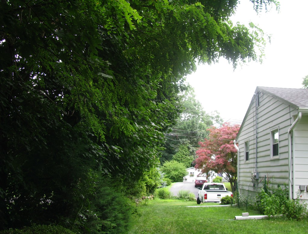

ohiofarmer 3,389 #6 Posted July 18, 2017 (edited) The biggest problem you have with so much vegetation is that you use so much power spitting the excess out of the mower. It is pretty hard on belts as well I have had luck with using a large leaf blower clearing the already cut stuff away or piling it up and then dragging it away with tarps on to a trailer. Maybe there is even room on the lot to make a compost pile? When it is just lawn grass, I mow it high and then use the blower to move it after drying out for a day. The next mowing usually finishes the job. What you Don't want to do is mow wet grass high and then try to chop it up fine right away. Makes a mess. I have the biggest blower that Stihl makes, but that just means that I can make bigger piles. Good luck. I am sure you can figure out what to do. I recently mowed a lot with grass higher than the hood. First pass was holding the mower with the handle raised all the way up in the transport position. I found that I was going over hidden fallen limbs as much as 2" in diameter . i was able to then pick up the limbs and get the lot mowed without getting caught in the blades Edited July 18, 2017 by ohiofarmer 3 Share this post Link to post Share on other sites

EricF 589 #9 Posted July 18, 2017 Myself, I'd be inclined to go skim over those loose branches, partially-embedded roots or saplings and general trash with a 'dozer blade first and build up a couple of piles to haul away or burn, if it's allowed. Just skim over the ground, don't dig in. Heaven knows the 520H has the power to push stuff around all day. It'll help save your blades and deck from wear and damage you really don't want. Even after pushing the big trash away, you'll probably still wind up with a lot of small stuff that's not great on the blades -- great if you can rake some of that up and haul to the rest of the piles in a wagon. If not take it slow and make a pass with the deck all the way up, then another pass with it lower to take it easy on your equipment. 3 Share this post Link to post Share on other sites
Mt Zion 520H 43 #10 Posted July 20, 2017 Sarge.. I have a lot of space bit wonder how i'd keep the fire under control.. Keep from lighting the whole feild. Lol. ohiofarmer.. Thanks for the tips and pic. Wow. Lol. I have just over 2 acres adjacent the freshly chopped field. No divider.. So compost pile would be easy. I just don't have anything to do the work with. Just have the 520h with 48" deck. Would have to ask neighbor if he'd do it all for me with his machines. Thanks littleredrider.. Will keep sharp blades and keep away the buildup. tunahead72.. Where do punctures usually happen.. Sidewalls or tread? Think i'll buy some ride-on for the tires. EricF.. Yeah; like i said just above.. I will have to rely on neighbor for all of that because i don't have any of that equipment. Lol. He could run thru my property easy and might even have a tiller and rock collector. Lol. I'll get a hold of him and see what he can and is willing to do for me here. Lol. Share this post Link to post Share on other sites

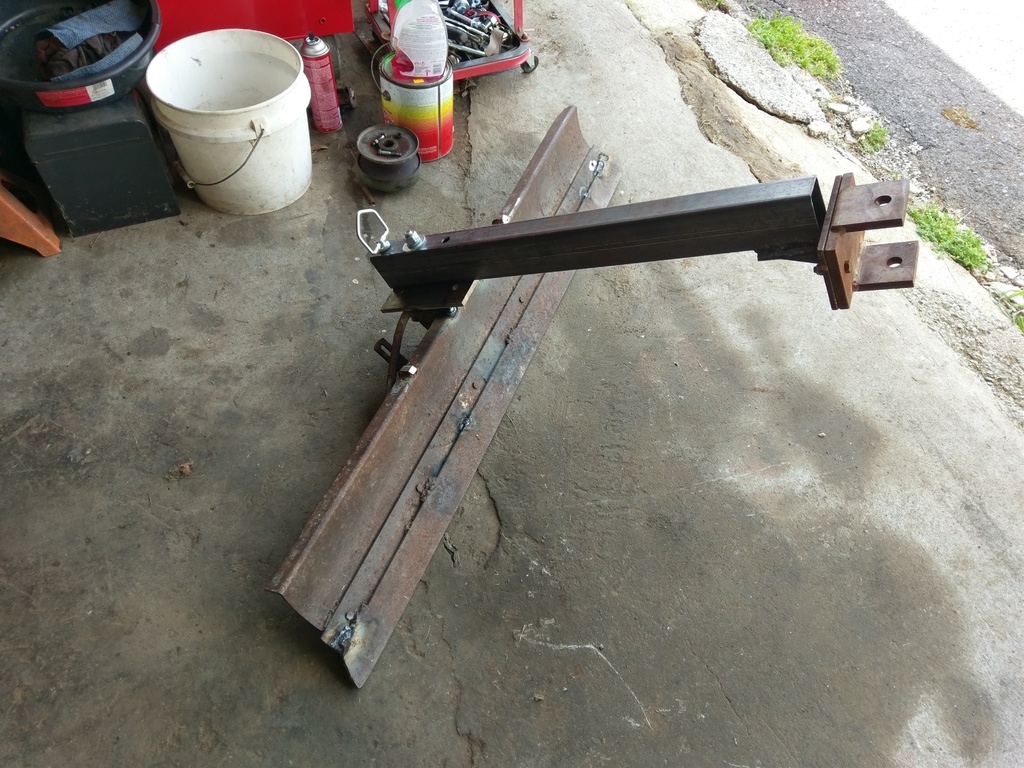

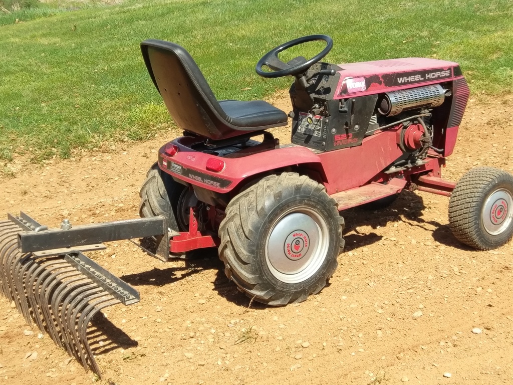

WVHillbilly520H 10,378 #12 Posted July 20, 2017 (edited) If you have the rear rock shaft and lift cable with the clevis hitch then you could buy/rent yourself a "york" rake like mine it does a fairly good job, plus I have the rear scraper blade dad built when I was a child, and the front snow/dozer blade does ok but doesn't lift very high unlike the older Cub Cadets, Jeff. Edited July 20, 2017 by WVHillbilly520H 2 Share this post Link to post Share on other sites

Mt Zion 520H 43 #14 Posted July 20, 2017 EricF.. That's interesting about the bed spring.. Lol. I'll have to see if i can find some youtube vids on that. Lol. Thanks for the info and tips. I have a feeling he may do it for me.. And maybe get him to turn everything up to seed. I'll look out for him somehow in return. One hand washes the other. WVHillbilly520H.. I'm not sure if my rear has the lift mechanism or not.. Will check but don't think so. Hmm.. Like your pops build though. Haha. Sarge.. Yes; i too wish to someday built my stable with more horses and implements. Lol. Sure would be nice.. But til then.. I think neighbor will look out and assist. He's been talking about how he wish he could bring more farmsoil up at a time because his truck holds only so much.. I can haul some more for him on trailer and save him some trips. My property is just over 2 acres but the area of it that was brush was about 250' x maybe 30' - 40'... And the rest of the brush was on other property. So i only really need to do the long strip.. Attaching a pic.. I have a lot of weed growing thruout the property though.. Think tilling and reseeding would help? Or should throw richer topsoil on too? Share this post Link to post Share on other sites
Mt Zion 520H 43 #15 Posted July 20, 2017 I'm like only halfway to the end at road. That's my house on right of pic. Share this post Link to post Share on other sites

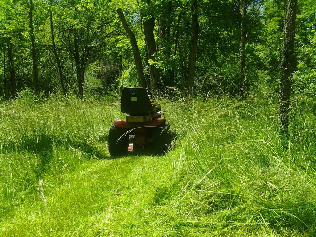

AMC RULES 37,256 #20 Posted July 21, 2017 (edited) Edited July 21, 2017 by AMC RULES 4 Share this post Link to post Share on other sites
ACman 7,717 #21 Posted July 21, 2017 (edited) Great videos and pics @AMC RULES love to see a hard working horses ! If my old RanchKing 18hp 46"cut can clear out 3 acres of 4' tall weeds and brush , that 520 should have no problems . Like others have said you just have to be couscous. Edited July 21, 2017 by ACman 1 Share this post Link to post Share on other sites
