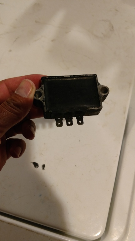

slammer302 2,157 #2 Posted July 17, 2017 Is it a 3 wire flat plug? If it's a Kohler engine the regulator should look like this the two wires from the engine plug into the two outside terminals and the middle one goes to the positive. Hope this helps 2 Share this post Link to post Share on other sites

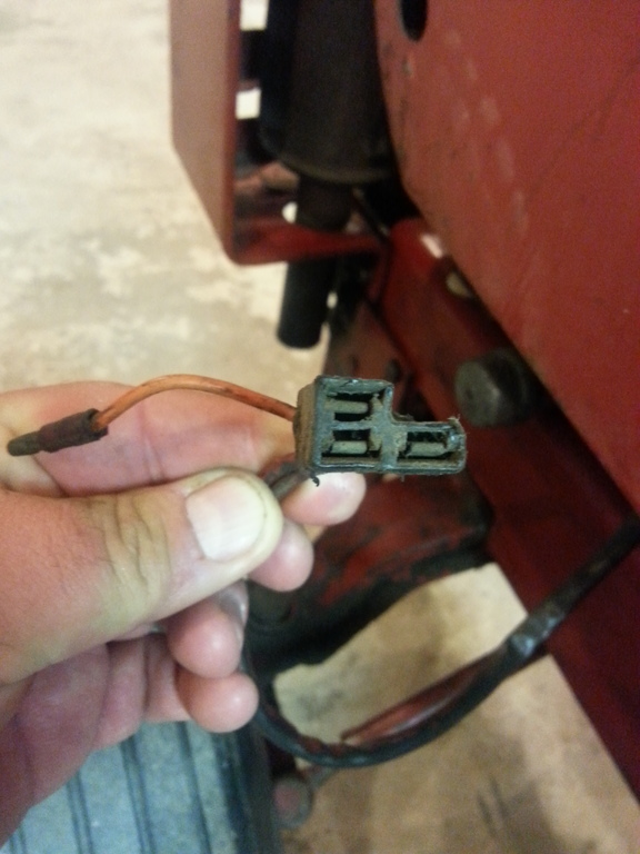

BMW1 44 #6 Posted July 18, 2017 Pacer, I looked this evening and I can see the regulator. I have no idea why PO unhooked it. The plug coming from the engine is not melted and looks ok to me. It is a 3 wire plug but it is not flat. See below. I guess next step would be to test it with a multi meter. 1 Share this post Link to post Share on other sites
pacer 3,180 #7 Posted July 18, 2017 BMW, yes that is indeed it and it does look OK, but I would strongly suggest to remove the wire ends from the plastic housing/connector and clean them good. They look pretty cruddy and that can cause a poor connection which will cause heat and first thing you know it'll be melted - along with the wiring! 1 Share this post Link to post Share on other sites

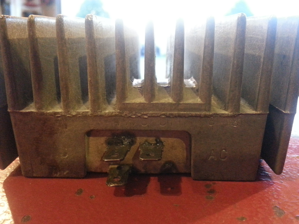

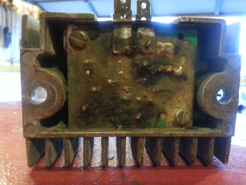

gwest_ca-(File Mod) 12,418 #13 Posted August 5, 2017 Is this an aluminum finned solid state rectifier/regulator or a set of coils and points under a tin cover? 7 minutes ago, BMW1 said: I thought I saw a post about testing regulators but I can't find it now. How can I test it to make sure it's working correctly? A tractor model number and serial number or the numbers off the engine decal should identify which type you have. Garry Share this post Link to post Share on other sites
BMW1 44 #14 Posted August 6, 2017 1979 D200 Model 91-20KS02. It's aluminum finned. Pictures below Share this post Link to post Share on other sites
gwest_ca-(File Mod) 12,418 #15 Posted August 6, 2017 A week or so ago I posted a procedure for testing a five or six wire Kawasaki regulator I think it was because I had never seen it before. That is likely the one you are thinking of. The one you have can not be tested. If everything else in the charging system meets the specs and the charging system still does not work it is assumed the regulator has failed. A couple of things I have learned but you won't see in the manuals. One of the regulator's AC terminals is connected directly to the DC terminal inside the regulator. You can verify this using an ohmmeter. If that one AC terminal is rusted off as they sometimes are you can connect one AC wire from the stator to the DC wire and it will work as normal. I does not matter which AC wire goes where. Don't think this will apply to you because your terminals are still there for the most part. Sand the surfaces so the wire terminals get a good clean tight contact. If the regulator now works coat the terminals with dielectric silicone grease so they can not corrode again. The aluminum body of the regulator needs a good ground to the battery negative post. Adding a ground wire to one of the regulator's mounting screws will guarantee that. As these tractors get older the chassis grounds deteriorate. The regulator needs to see the battery voltage before it can regulate the charge current. With the regulator installed back on the tractor and wires connected turn the key to the RUN position with the engine not running. Check the voltage across the battery posts and record it. Now move the red test lead to the DC terminal on the regulator. You should have the same voltage. If not the same voltage the path the charge current takes to get to the battery is compromised and needs to be corrected. I have cleaned the potting material off the regulator and found failed diodes. Was able to replace them for a few cents and still working 20 years later. That regulator was originally mounted with the terminals up. I replaced it with the terminals down thinking the heat it generates would be better dissipated with the aluminum fins above the source of the heat. I don't know how valid that thought is but it still works hours at a time. Garry 3 Share this post Link to post Share on other sites
