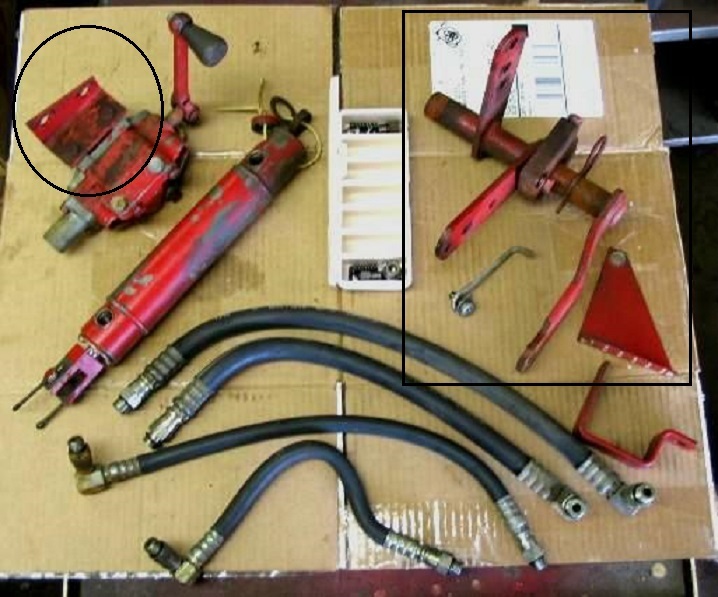

daveoman1966 3,884 #2 Posted July 16, 2017 There is a kit available to add the hyd lift to the C-120 Sundstrand power unit. I have most of it in my shop...here are a few pics. to pursue this, send me an off-forum email... I am : daveoman@windstream.net 4 Share this post Link to post Share on other sites

953 nut 70,342 #4 Posted July 16, 2017 did all the calculations years ago, all you need is the lift system from a Sundstrand "C" . Share this post Link to post Share on other sites
