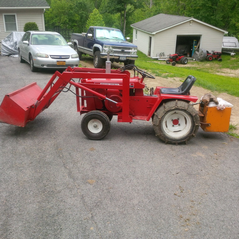

953 nut   67,519 #3 Posted July 14, 2017      I presume you have a front end loader and are attempting to overcome the added front weight and resulting steering difficulty. In addition to the stiffer tires weight box behind the rear of the tractor will be helpful. Also you could install a pair of thrust bearings with thrust washers on the front spindles. 1 Share this post Link to post Share on other sites

fast88pu   3,393 #15 Posted July 16, 2017 On July 14, 2017 at 6:22 PM, Aldon said: In my opinion yes.  @fast88pu has them as well. I can't recall if he has them on his loader GT14.  He may chime in later about the Vredsteins 5 ribs from that perspective. They are slightly harder to steer on a loader tractor then the stock ones but still easy. 2 Share this post Link to post Share on other sites
