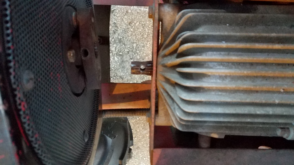

Sarge 3,473 #11 Posted July 12, 2017 Just as an example - pulled the contents of my small shed on my 6.5'x12' utility trailer , or about 5,000lbs of stuff including the sand blaster and all it's blasting media (450lbs of it) . D-180 pulled it fine at first , until the front half was in the street to make the lap to position the trailer to re-load the stuff in the shed - and promptly broke the engine coupler/pump shaft on the Sundstrand pump . Now , I've got a crippled tractor with a stuck tow valve , and a heavy trailer sitting on the 3pt hitch , raised up nice and high . So, get the High Lift jack out of the other shed , lift up the trailer and get it off the tractor - check . Drove a 1/4" hitch pin through the hole that was drilled in the coupler/shaft last winter the last time it broke/stripped to replace the grade 8 bolt so I could limp it out back , vibrating like mad the whole time at idle....check. Jump in the Dodge pickup , go around out front and back up to the trailer - check . Trailer too high and Hi-Lift is in the way , lower trailer jack and remove Hi-lift - check . Start backing up truck watching the hitch in the rear camera , almost got under the ball but the ball seems to be moving away to one side ....wtf ? Check Mate....duh . The front frame and tongue of the trailer couldn't take the weight sitting off on one member where the jack was holding it up (2x2 angle iron , really ??) - so the whole thing slowly twisted until the trailer jack was laying on it's side , on the ground . Stand there for a minute and assess the situation , utter several choice words and drive chocks under front/rear of the trailer tires . Go back to shed , get the stupid Hi-Lift and pick up the nose of the now mangled trailer - check . Take 3 attempts to hook up the truck , got it the 3rd time and set it on the ball hitch , latched it down and removed the Hi-Lift - then tossed the jack on the trailer and leave rubber halfway around the block with the Hemi - check . Back what's left of the trailer , and the slew of stuff strewn around it up to the shed - time for a beer or three and reflect on my own stupidity . Unload the trailer into the shed , reminding myself the whole time just how much this stuff weighs and swearing heavily the whole time - wife asks at dinner what all the commotion was about - "don't ask , you don't want to know" .... Waiting for the local steel supply to get my 2x3x1/4 rectangular tubing to build a new tongue along with a new coupler - and a much heavier jack . Pretty sure when I'm done that will never bend again....lesson learned . Still working on the D and it's pump problem , that turned out to be a whole other can of worms...ugh . Btw- shed has a very nice , stout new floor under it , which is what started all this in the first place . Sarge 6 Share this post Link to post Share on other sites

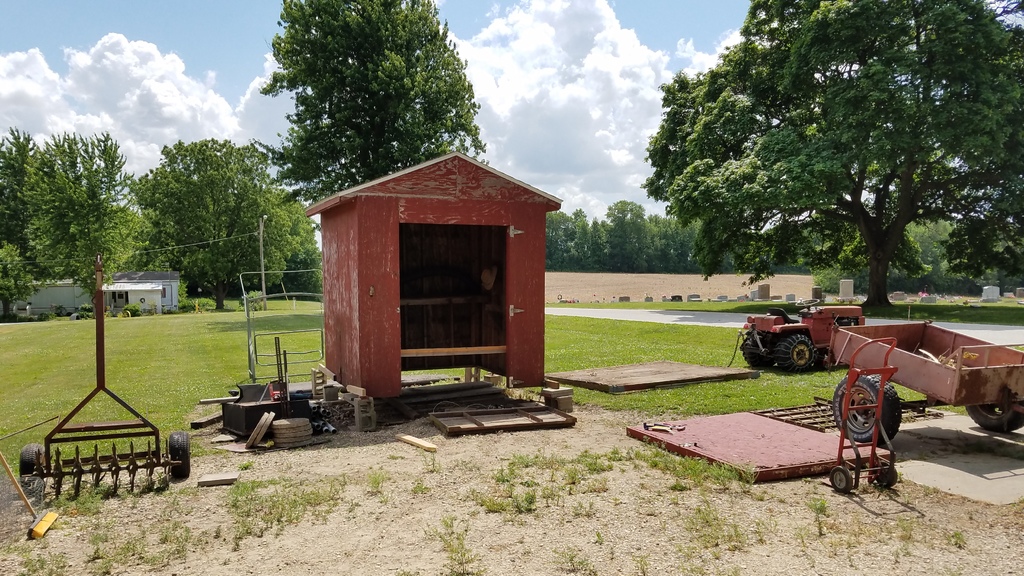

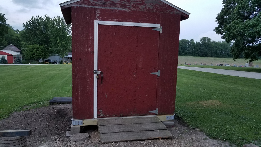

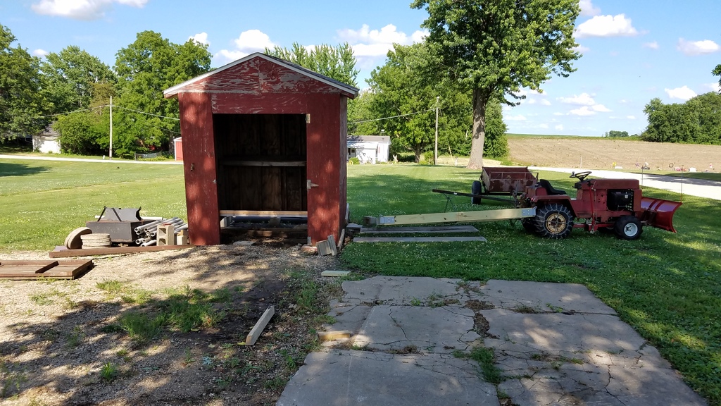

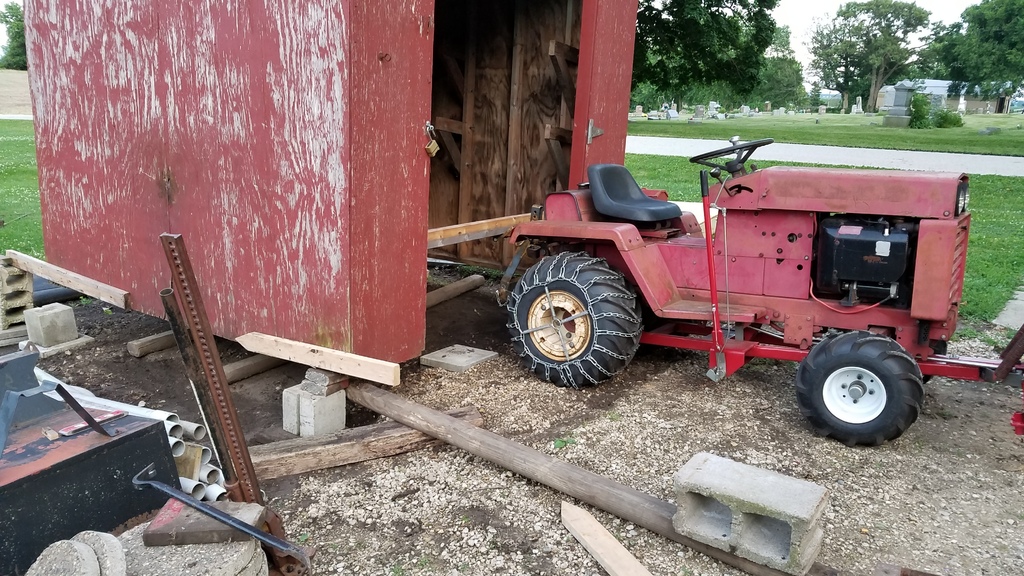

Sarge 3,473 #13 Posted July 13, 2017 Well , it's quite a trip , and we're gonna need a lot bigger jack to pick it up . This was a simple 8x8 shed that a previous neighbor built and had used 5 - 2x4's as floor joists . Needless to say , the little Green lawn tractor was fine , but when the 16 Auto got parked in there , it just kept going dowwwnnnn....grrr . Wasn't a fun job and as most sheds the floor sheathing was under the wall plates - so I cut it apart with a sawzall and angle grinder , added some supports and jacked the whole thing up off the floor . The D came in really handy to help remove the floor , lift one end of the shed and other tasks . The replacement could hold my pickup easily - so that won't happen again . Had to do most of the work alone , but I got it done and only had one incident where it fell off the blocks due to a heavy storm/wind here - that ruined one whole day picking it back up . Sundstrand pump carnage - Some lessons come harder than others - buy you learn either way . Sarge 2 Share this post Link to post Share on other sites
ebinmaine 81,145 #14 Posted July 14, 2017 Nice job on that shed floor ! Share this post Link to post Share on other sites
