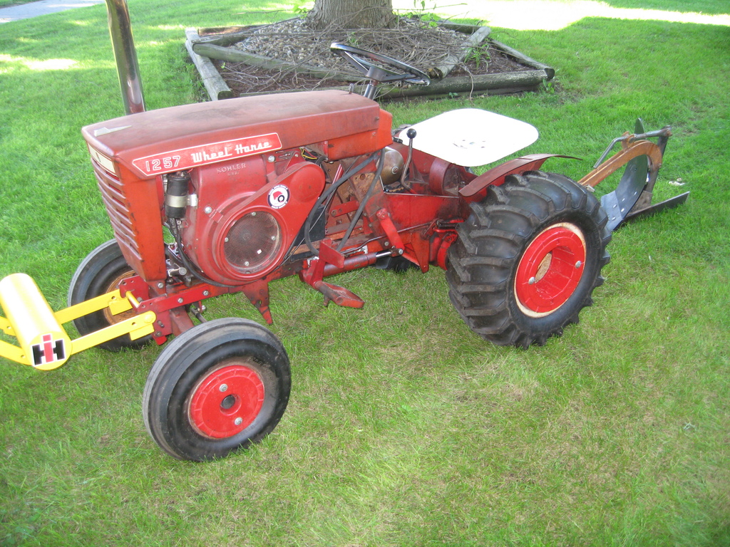

Shynon 7,545 #4 Posted July 12, 2017 I use after market I see no difference except cost, but it's your money. The Machine pulling a plow for 3 consecutive years and no issues built with aftermarket piston and rings. 7 Share this post Link to post Share on other sites
