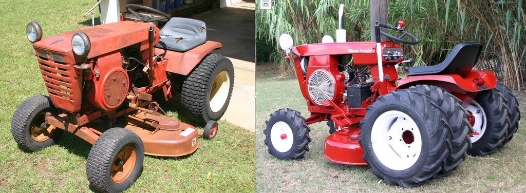

Mikey the Monkey 701 #1 Posted July 9, 2017 Hay everyone. I'm in the middle of my first restoration on a 701. I've got it all tore apart. Now I want to paint it and put it back together. I was hoping to glean some tips and tricks from the experts, like best ways to clean and prep everything? Do you paint pieces separate and then put together, or put them together then paint? Best way to clean oil and crap off engine that's been there for 40 years. Share this post Link to post Share on other sites

953 nut 67,517 #8 Posted July 9, 2017 2 hours ago, Mikey the Monkey said: clean off w diesel, carb cleaner and paint? If you want a good smooth finish that will last you can't take shortcuts. If you just want it to have a so-so paint job that will look OK from a distance then yes, get most of the crud off and cover the rest. 1 Share this post Link to post Share on other sites
Mikey the Monkey 701 #9 Posted July 9, 2017 OK...what's the long cut? Share this post Link to post Share on other sites
953 nut 67,517 #10 Posted July 9, 2017 7 minutes ago, Mikey the Monkey said: OK...what's the long cut? The proper way is to do as Jay did, remove all paint and other surface coatings down to bare metal, use an etching primer and build up with a couple of coats of primer then wet sand to a smooth finish prior to application of the color coat. 1 Share this post Link to post Share on other sites
RandyLittrell 3,944 #11 Posted July 9, 2017 I find the best way to clean things up before painting, is to use ez off oven cleaner. Spray it down, wait the recomended time, then haul it to the car wash and pressure wash it off. It will get all the grease off and sometimes a little paint. So, don't use it if your not gonna be painting it. I also will the tires cleaning setting at the car wash too. The two things combined will really get things clean. Randy Share this post Link to post Share on other sites

Digger 66 3,530 #13 Posted July 9, 2017 1 hour ago, RandyLittrell said: I find the best way to clean things up before painting, is to use ez off oven cleaner. Randy EZ Off is a great degreaser , but it is also very corrosive / caustic . If you go this route , be sure to THOROUGHLY RINSE every single part this may come in contact with with the hottest water you can find . I use EZ Off on the radiator of my wheeler every fall but it's out of the bike and after it has sat the recommended time it gets submerged and rinsed in the wash tubs . The stuff works great but it's N A S T Y ! 1 Share this post Link to post Share on other sites
953 nut 67,517 #14 Posted July 9, 2017 3 minutes ago, Digger 66 said: very corrosive / caustic It is mainly Sodium Hydroxide (caustic soda), use eye protection and a face shield as well as long rubber gloves. It will pull all of the oils out of your skin and make some nasty burns if you get it in your eyes. It works, but be cautious. 5 Share this post Link to post Share on other sites

Texas Todd 1,026 #20 Posted July 15, 2017 (edited) I would power wash or use simple green (some degreaser) or something to get the worst of it off and then blast or wheel. The blast media will take it off, but if in a cabinet, it will just recycle it back through the gun. And go from this to that! Edited July 15, 2017 by Texas Todd 2 Share this post Link to post Share on other sites
