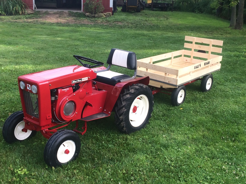

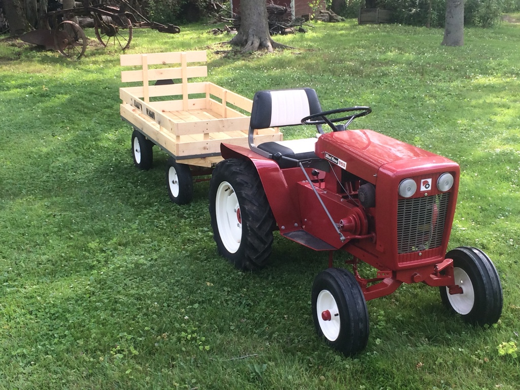

Borncountry10 28 #1 Posted July 8, 2017 (edited) I am almost finished redoing a 953 that has been in my family since very early in its life. I have been searching for the factory headlight housings for appx 1 year. Hoping to make its first show at the end of this month but I cannot locate these darn housings. Any one have ideas. I did buy new lenses off of glen but no housings to put them on. Thanks in advance For any help! Edited July 8, 2017 by Borncountry10 11 Share this post Link to post Share on other sites

SylvanLakeWH 32,783 #4 Posted July 9, 2017 Looks Great! Share this post Link to post Share on other sites

Borncountry10 28 #10 Posted July 22, 2017 Alright, just an update in case anyone else is looking for these light housings. Like I said before, I have been searching for one of these for about a year. I have been searching for a wheelhorse specific part. I ended up looking on the side of the one that I did have and it is made by dietz. Light number 107. So I started to search for one of those. I found one in Texas from a "light guy". $24 sent to the house. It fit perfectly but here is the only difference. It was made with a cut out in it for a license plate light and takes a slightly different bulb. I just painted the clear plastic silver and otherwise you can't tell a difference. It fits the hole in the grill and the wheel horse lenses snap right onto it. It will work good and get us to our local tractor show this weekend with a complete tractor! 7 Share this post Link to post Share on other sites
953 nut 70,076 #11 Posted July 23, 2017 Glad you were able to find one, good information to have. Wonder what it was used on? 1 Share this post Link to post Share on other sites
Borncountry10 28 #12 Posted July 23, 2017 The best I can tell they were some sort of vintage trailer lights. It was painted black so I had to paint it but easy to make it work. Guess it would be good to mention that it was a two wire light and the factory wheel horse light was a one wire light so I just had to ground it. 2 Share this post Link to post Share on other sites

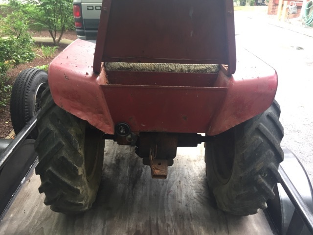

953 nut 70,076 #14 Posted July 23, 2017 1 hour ago, Big_Red_Fred said: do 953 come with a tail light Too ? Yes they do and replacement lenses are available. 1 Share this post Link to post Share on other sites
Borncountry10 28 #15 Posted July 23, 2017 Yes a single red bullet style rear tail light. I bought the replacement rear lense, both front headlight lenses and orings and the replacement ivory throttle and choke knobs from glen pettit and had very few dollars invested. Thank you glen!!!! 1 1 Share this post Link to post Share on other sites
