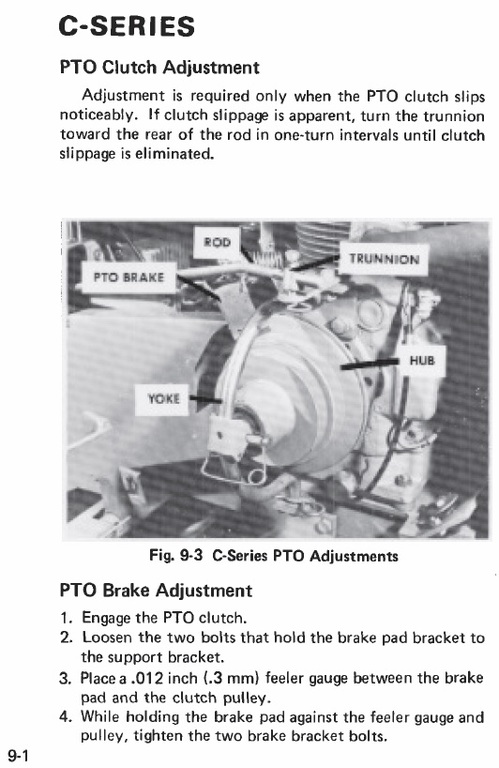

gwest_ca-(File Mod) 12,460 #7 Posted July 22, 2017 The C-Series in this later service manual is similar to your B-80. Here is the pto adjustment from Section 9 of the manual Garry Share this post Link to post Share on other sites
Jamie Darian Brown 9 #8 Posted July 23, 2017 I have the trunnion adjusted all the way. Still slips. The clutch facing is about a 1/4 inch thick. Is this too wore Share this post Link to post Share on other sites
