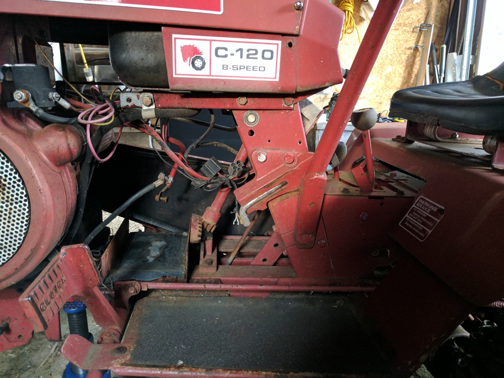

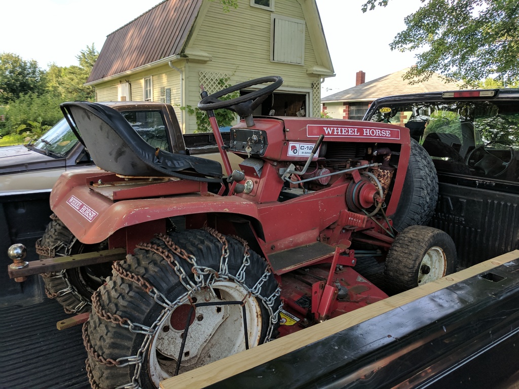

Boonelynch 8 #1 Posted July 6, 2017 Just purchased my first Wheel Horse yesterday. I'd like to restore it to its original glory. I'm sure there is plenty of parts information out there. Any help you guys could provide would be great. The I have says C-120 on the side but the previous owner says it's a c-100. It does not have a data tag anywhere that I can find. Is there any distinguishing features I should look for to help determining exactly what year/model it is. 8 Share this post Link to post Share on other sites
520hC-120 136 #2 Posted July 6, 2017 (edited) Looks to be a 1975 or around there, use this link to help: http://www.tractordata.com/lawn-tractors/000/4/4/447-wheel-horse-c-100.html Edited July 6, 2017 by 520hC-120 1 Share this post Link to post Share on other sites
WHX?? 56,850 #3 Posted July 6, 2017 Boone.... get us some numbers off the engine, that will tell us C-100 = 10 hp should be a K241, if it is a 120 should be a 12 hp K301. Congrats on your 1st horse! 2 Share this post Link to post Share on other sites
Boonelynch 8 #4 Posted July 6, 2017 It has the 10hp Kohler. Share this post Link to post Share on other sites
Tuneup 1,459 #5 Posted July 6, 2017 I wonder why the tag would be removed? It should be attached on the left. Opposite from where the right side lever would go if it was on the left. I couldn't find mine but that's cause a former owner covered it with tape when he sprayed it. 10HP makes is a C-100, right? So, replacement engine or replacement decals? I'm thinking the former. Everything else is the same. Share this post Link to post Share on other sites

Boonelynch 8 #8 Posted July 7, 2017 41 minutes ago, Tuneup said: I wonder why the tag would be removed? It should be attached on the left. Opposite from where the right side lever would go if it was on the left. I couldn't find mine but that's cause a former owner covered it with tape when he sprayed it. 10HP makes is a C-100, right? So, replacement engine or replacement decals? I'm thinking the former. Everything else is the same. I assume replacement decals, though not sure why they chose 120, availability perhaps Share this post Link to post Share on other sites
ericj 1,580 #9 Posted July 7, 2017 (edited) I always thought that the ID tag was under the rectifier center of the tractor eric j P.S. I'm sorry I looked at the first picture and realized that the rectifier was mounted on the removable plate so the tag would not be there, it was down by the lift handle, my bad eric j Edited July 7, 2017 by ericj 1 Share this post Link to post Share on other sites

paxz71usa 173 #12 Posted July 7, 2017 Nice. I'd like to get a better view of how the trailer ball draw bar is attached if possible. It's exactly what I've been looking for to pull a log splitter. Thanks Boonelynch, Gary Share this post Link to post Share on other sites

WHX?? 56,850 #14 Posted July 7, 2017 That's an easy one Gary, get yourself or build an axle hitch with a 2 in receiver. All kinds of them out ther. Then get a high/low drop ball mount and good to go. Brings the log splitter right up to level height. Share this post Link to post Share on other sites
paxz71usa 173 #15 Posted July 9, 2017 Thanks Jim, I'll look into that. Kind of new to this. Gary Share this post Link to post Share on other sites

Racinbob 12,996 #17 Posted July 9, 2017 It kinda looks like an ID tag was never pop rivited in place. In any case, 100 or 120 it's a nice machine. Based on the fixed rear fender and flip forward seat vs a flip back fender it would be a 76 or 77. I don't think it has a hood ornament either which would indicate those years too. 1 Share this post Link to post Share on other sites
Boonelynch 8 #18 Posted July 9, 2017 Thanks for that input. It's nice to narrow the year down a little bit more Share this post Link to post Share on other sites
