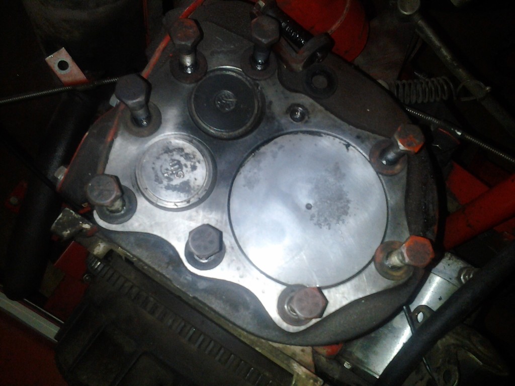

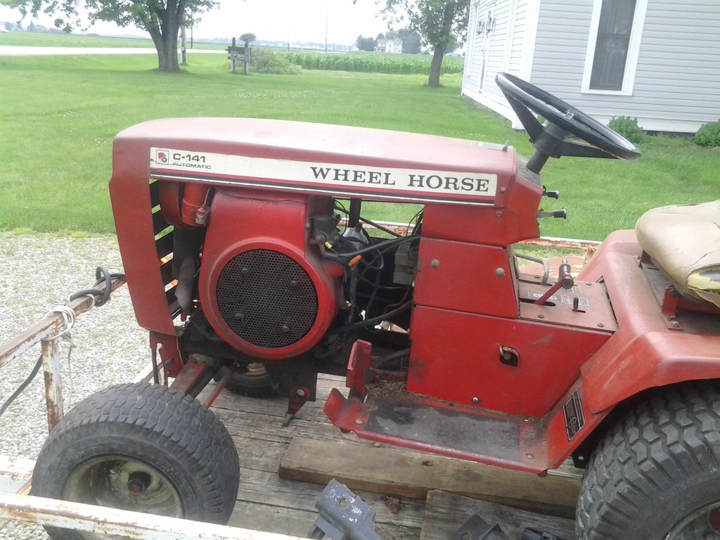

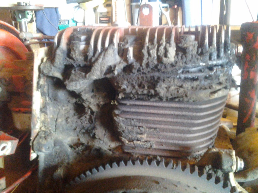

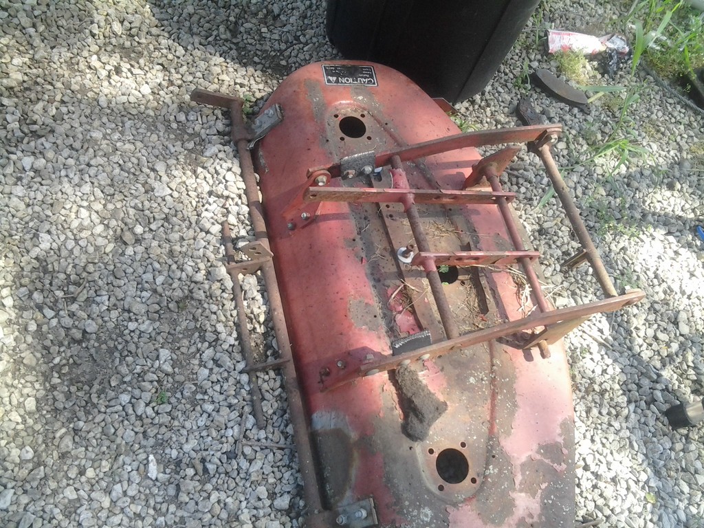

ohiofarmer 3,495 #1 Posted July 2, 2017 I got a c-141 yesterday that had been garage kept and the owner inherited it with his house. A very exciting find for $200 as it includes a solid deck and a very nice pusher blade. It also looks very nice and clean for its age. Like any non-running tractor, you can expect a few problems. First, the starter nose gear is heavily worn and so will not engage. It is a Massachusetts built Bosch starter, and I have borrowed one from another tractor, I thought it a good idea to remove the engine tins to check for mice nests, but there was a great deal of dried oil gunge suggesting a blown head gasket. i found the only head bolts that were anywhere near tight were the two closest to the exhaust. There are no scratches in the piston bore, but at TDC, the valves can be rotated . I have cleaned the engine and plan to adjust and lap the valves. The front of the piston top has eroded a bit and you can see a bit of the top piston ring. I suppose it could be due to all that grunge build up on the cooling fins from the loose head bolts I did notice that the tractor has an electric fuel pump. I used the pump to empty the tank and the gas was pretty good as it appeared to have Sta-Bil in it. In any case it still smelled pretty much like it should, but i pumped it out anyway and used it to clean up the engine. Does this sound like a good plan? I know some of you would just do a complete rebuild, but i already have one tractor in pieces to paint 6 Share this post Link to post Share on other sites

ohiofarmer 3,495 #5 Posted July 3, 2017 (edited) Well, I do not like what I see....... The eroded area of the piston showing the ring edge is pretty slight at the top of the bore, but the gap gets visually larger as the piston descends into the bore. My perception is that the piston ring has got to wear the piston grooves somewhat wider leading to blow-by and when you consider the ring is changing size back and forth at each RPM, ---The wear rate will probably accelerate in a more or less geometric progression.. i will buy the gauges for the knowledge of just how bad the problem has become. The valves seal tight at TDC as they held penetrating oil in them for at least a half hour until I rotated the engine I still need to get the tractor running if possible as I want to check out the transmission and see how the lower end of the engine sounds...It is a shame because it is such a pretty girl in original condition and not repainted. Edited July 3, 2017 by ohiofarmer 2 Share this post Link to post Share on other sites

ohiofarmer 3,495 #10 Posted July 6, 2017 (edited) I got a bore measuring tool and locked it in on the wrist pin side of the cylinder. I rotated it around to the thrust side and the biggest gap I could get was about 1/32" . There was a deposit of carbon on the front side of the cylinder that was moving the ring just a bit at the top of the stroke. That might account for a little oil loss. I removed the carbon and the cylinder did not show enough wear from the rings to even catch a fingernail. The large engine tin has some issues from a mounting nut and some surrounding metal being gone and a large crack running quite some distance The valves were not even close to spec. they had almost no gap at all and now are set according to the manual. Hopefully, I can get it running soon and see what this $200.00 machine will do. I was not able to read the piston stamping Edited July 6, 2017 by ohiofarmer 1 Share this post Link to post Share on other sites
953 nut 69,555 #11 Posted July 7, 2017 2 hours ago, ohiofarmer said: rotated it around to the thrust side and the biggest gap I could get was about 1/32" 1/32", if accurate, is .003" which is the maximum out of round according to Kohler. 1 Share this post Link to post Share on other sites
oldredrider 2,553 #12 Posted July 7, 2017 1/32"=.03125. Major piston slap at the least! WAY past time to bore to the appropriate size. You can use your bore gauge to determine where cylinder is now. 1 Share this post Link to post Share on other sites
953 nut 69,555 #13 Posted July 7, 2017 1 hour ago, 953 nut said: 1/32", if accurate, is .003" which is the maximum out of round according to Kohler. 55 minutes ago, oldredrider said: 1/32"=.03125. Major piston slap at the least! WAY past time to bore to the appropriate size. You can use your bore gauge to determine where cylinder is now. Seem my math was off, way off! 1 Share this post Link to post Share on other sites

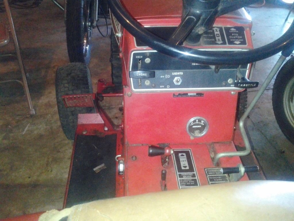

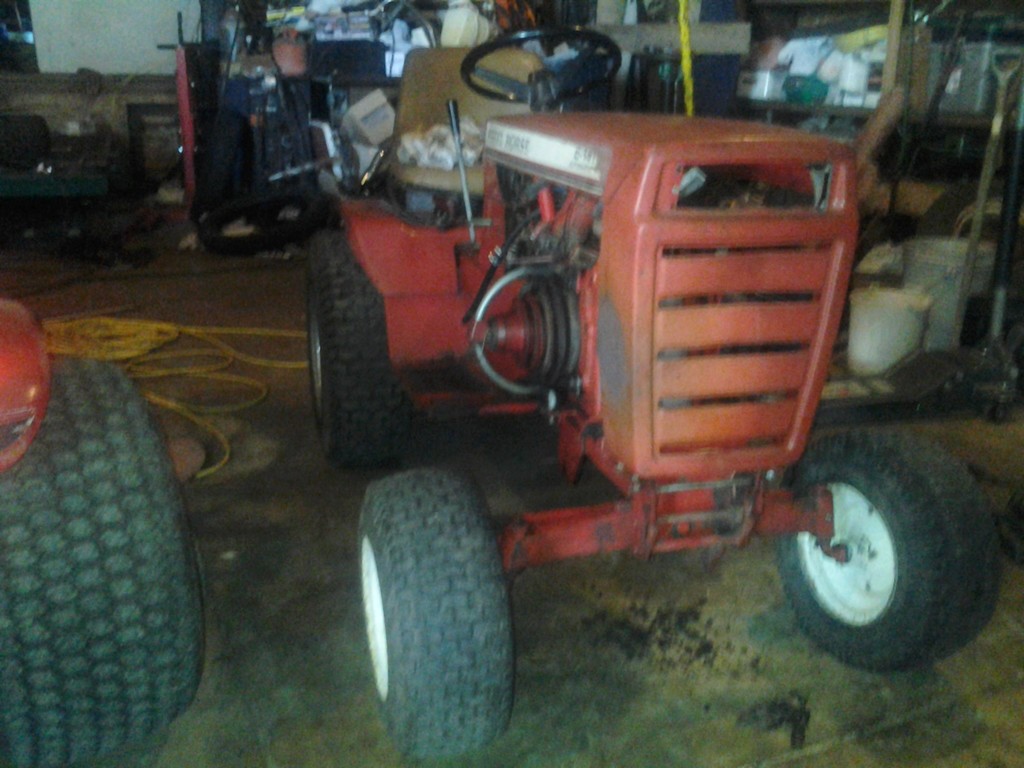

ohiofarmer 3,495 #15 Posted July 11, 2017 (edited) Here are the piccs It is pretty difficult to tell, but there is a great deal of shine left to the paint. After sanding the hood down with 600 and 800, I sprayed some Rustoleum 2x clear over it and it bloomed a sort of white translucent color. I sanded that some more and now nearly all the little blems are nice and flat. I tested some lacquer in an inconspicous spot and the results are sort of a pleasing dark cherry red with clarity and depth that celebrates the patina on the top of the hood and seat pan. Pictures do not give it justice I am gonna try the same thing on the raider10 with its quick rattle can touch up by the previous owner. I have a 1057 roller for practice that might proove whether or not i am on the right track with this. Even though this tractor will probably be a re-bore the results will probably be worth the money. The pusher blade might nearly pay for the rebuild It still needs to run by some means to test the transmission. Edited July 12, 2017 by ohiofarmer 2 Share this post Link to post Share on other sites
