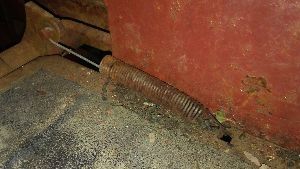

Rustyred 63 #1 Posted July 1, 2017 Hi folks, Please see the attached picture. We are putting our C-81 back together and we have two issues with the clutch return spring. First, is the routing of the spring which is pictured below correct? Should it really be hooked into that little hole on top of the footrest? Second, when I ordered a new spring it looks completely different - see second picture. Does this mean the former owner installed an incorrect spring or is my new spring incorrect? Thanks guys for your continued assistance. Rustyred Share this post Link to post Share on other sites
N3PUY 1,031 #2 Posted July 1, 2017 I don't think it should be on the clutch pedal. 1 Share this post Link to post Share on other sites
cschannuth 3,821 #4 Posted July 2, 2017 The pdf is correct and it looks like the correct spring. 1 Share this post Link to post Share on other sites
TDF5G 2,074 #5 Posted July 7, 2017 On 7/1/2017 at 6:23 PM, N3PUY said: I don't think it should be on the clutch pedal. I might be wrong, but I think you're right. Share this post Link to post Share on other sites
