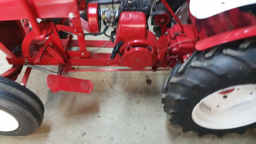

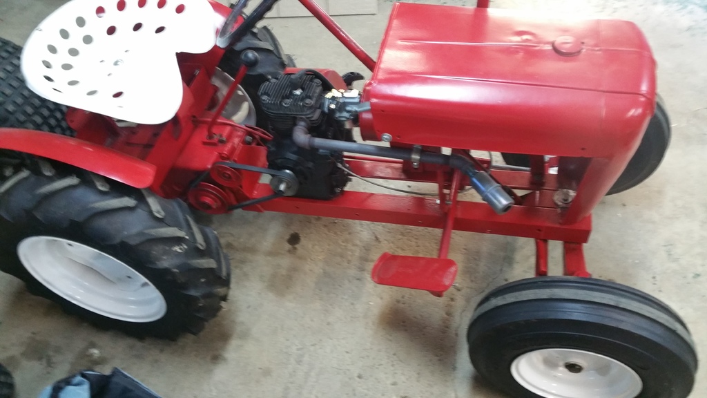

Matt1961 4 #1 Posted July 1, 2017 I have a 1961 WH I think rj58 maybe Suburban 1st and rev. Is fine, no 2 and 3rd goes in but pops out of gear... Share this post Link to post Share on other sites
gwest_ca-(File Mod) 11,664 #2 Posted July 1, 2017 Your tractor was most likely a 1961 model 551 originally. Garry 2 Share this post Link to post Share on other sites
Racinbob 12,164 #4 Posted July 1, 2017 Definitely a 1961 551, The 2 piece transmission case gives it away. What you need is the 3523 gear and possibly the 3424 input gear/shaft. Since you're going to open it up I'd suggest that you do that first so you can inspect things. You can get the 3523 here https://wheelhorsepartsandmore.com/ I'm sure you'll need seals and possibly some bearings and you can get those from him too 3 Share this post Link to post Share on other sites
