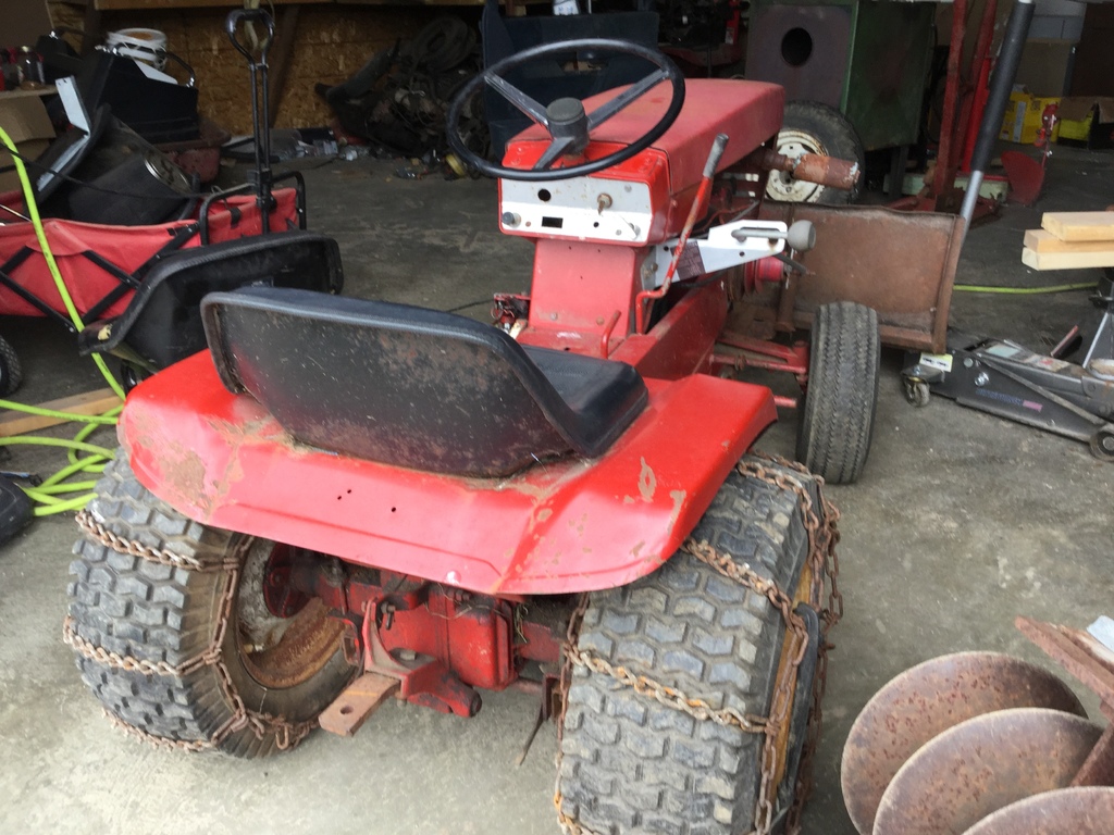

ACman 7,741 #1 Posted July 1, 2017 (edited) Ok guys , need some help here . It looks to be a 12 hp and the id badge is missing. Sorry i couldn't get around in barn ...it's a disaster . Edited July 1, 2017 by ACman 4 Share this post Link to post Share on other sites

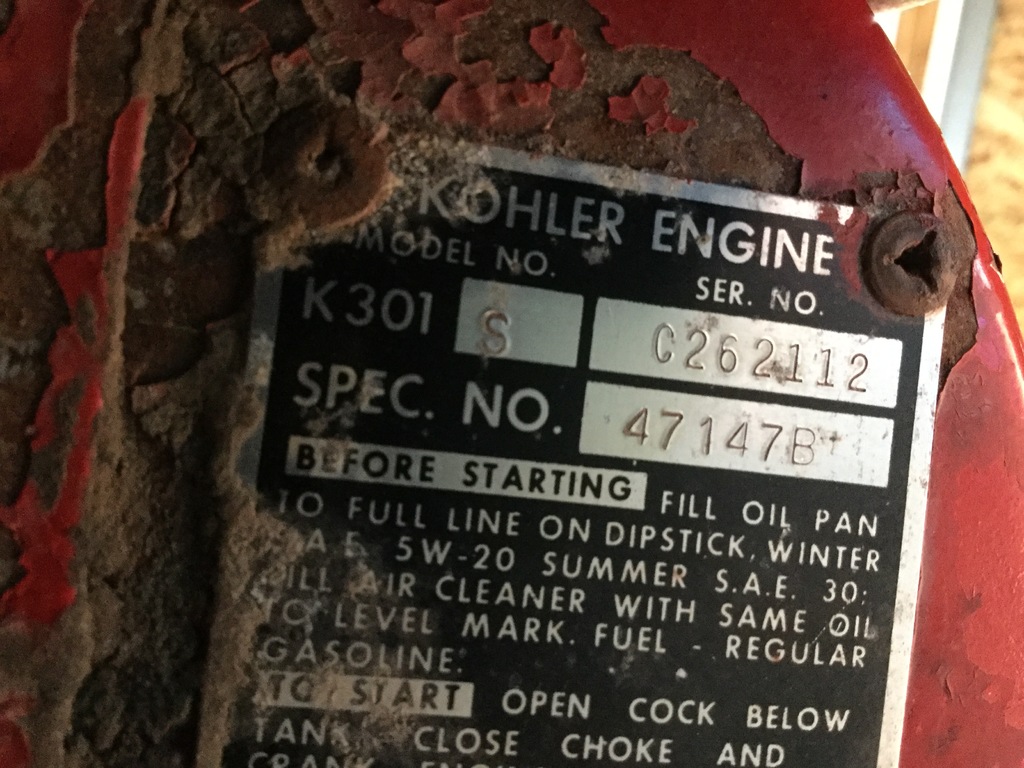

BOB ELLISON 2,983 #4 Posted July 1, 2017 68 Electro 12 is what I found for that engine number 2 Share this post Link to post Share on other sites

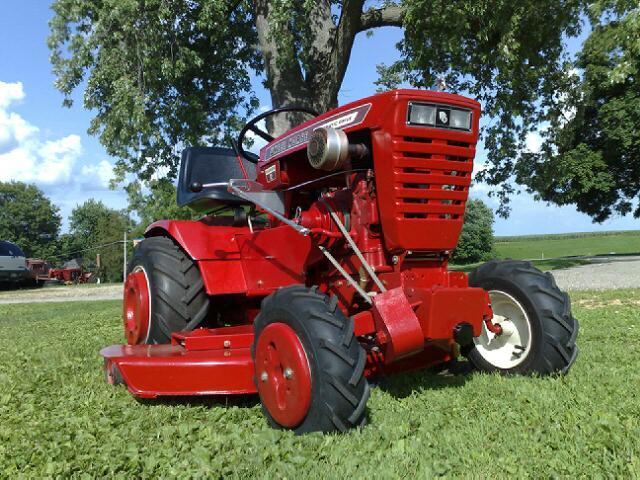

wholdguy 73 #6 Posted July 1, 2017 This one looks similar to our Charger 12. Not sure of your year though. This does not show the electric clutch so it must be a Charger 12? G. 1 Share this post Link to post Share on other sites
squonk 48,056 #7 Posted July 1, 2017 I think Electro should have E-clutch. so either it failed and someone converted it to manual or I'd say it was a Charger. 1 Share this post Link to post Share on other sites
gwest_ca-(File Mod) 12,483 #8 Posted July 1, 2017 The online info at Toro is not correct for all these models. They went from starter/generator to Bendix starter with stator but the tractor model number stayed the same. Kohler built serial C262112 in 1967. Garry 1 Share this post Link to post Share on other sites
ACman 7,741 #9 Posted July 1, 2017 So are we still thinking 68 Charger ? Share this post Link to post Share on other sites
pfrederi 21,143 #10 Posted July 1, 2017 The difference between Charger and Electro. Electric PTO and standard Hydraulic lift plus Chrome Hub Caps on Electro. Hydro lift was an option on Chargers and many electric PTOs failed and were replaced by a manual. Hub caps could have disappeared Hard to tell from your picture but eh Electric PTO switch would have been just to the left of the throttle. Hole would be plugged on a Charger.... 3 Share this post Link to post Share on other sites
daveoman1966 3,884 #11 Posted July 1, 2017 (edited) Had one like that.... Charger 12. Here they are: 1-7231 1968 Charger 12 Automatic Kohler K301S-4712B 12 Sundstrand 10 90-2046 1-7241 1969 Charger 12 Automatic Kohler K301S-47147C 12 Sundstrand 10 90-2046 1-7251 1970 Charger 12 Automatic Kohler K301S-47371C 12 Sundstrand 10 90-2046 1-7252 1970 Charger 12 Automatic Kohler K301S-47147C 12 Sundstrand 10 90-2046 1-7253 1970 Charger 12 Automatic Tecumseh HH120-120129C 12 Sundstrand 10 90-2046 1-0400 1971 Charger 12 Automatic Kohler K301S-47407C 12 Sundstrand 10 90-2046 1-0401 1972 Charger 12 Automatic Kohler K301S-47421B 12 Sundstrand 10 90-2046 1-0402 1972 Charger 12 Automatic Kohler K301S-47407C 12 Sundstrand 10 90-2046 OOOPS.... Dummy me...listed wrong spec #.. here is corrected list: 1-7235 1968 Electro 12 Automatic Kohler K301S-47147B 12 Sundstrand 10 90-2046 1-7245 1969 Electro 12 Automatic Kohler K301S-47147C 12 Sundstrand 10 90-2046 1-7255 1970 Electro 12 Automatic Kohler K301S-47371C 12 Sundstrand 10 90-2046 Edited July 1, 2017 by daveoman1966 3 Share this post Link to post Share on other sites

BOB ELLISON 2,983 #13 Posted July 1, 2017 I looked at that engine spec number 47147B 1968 Charger 12 Automatic Kohler K301S-4712B 1968 Electro 12 Automatic Kohler K301S- 47147B 1969 Charger 12 Automatic Kohler K301S-47147C 1969 Electro 12 Automatic Kohler K301S-47147C 1 Share this post Link to post Share on other sites

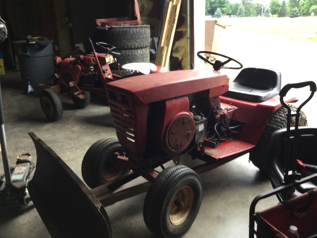

Sarge 3,473 #14 Posted July 2, 2017 I'd say it's this , just a bit more of a sad state... Sarge 2 Share this post Link to post Share on other sites
pfrederi 21,143 #15 Posted July 3, 2017 I went up and looked at my Charger 12 (she gets summers off and is resting). I am the second owner and 99.99% sure the engine is original. Tractor model # 1-7241 Spec number on the engine is 47147B. 1 Share this post Link to post Share on other sites
