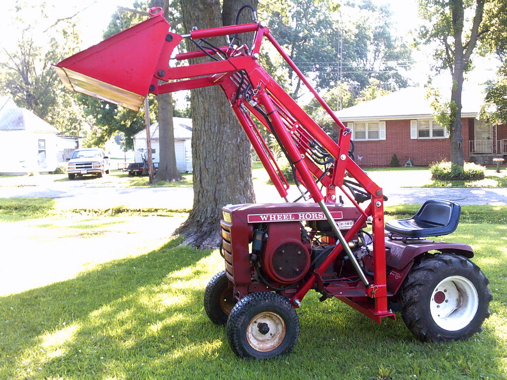

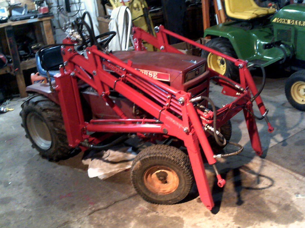

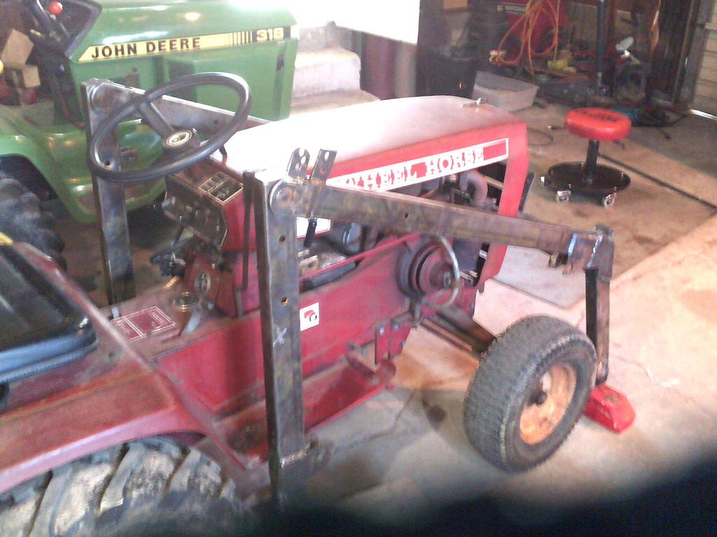

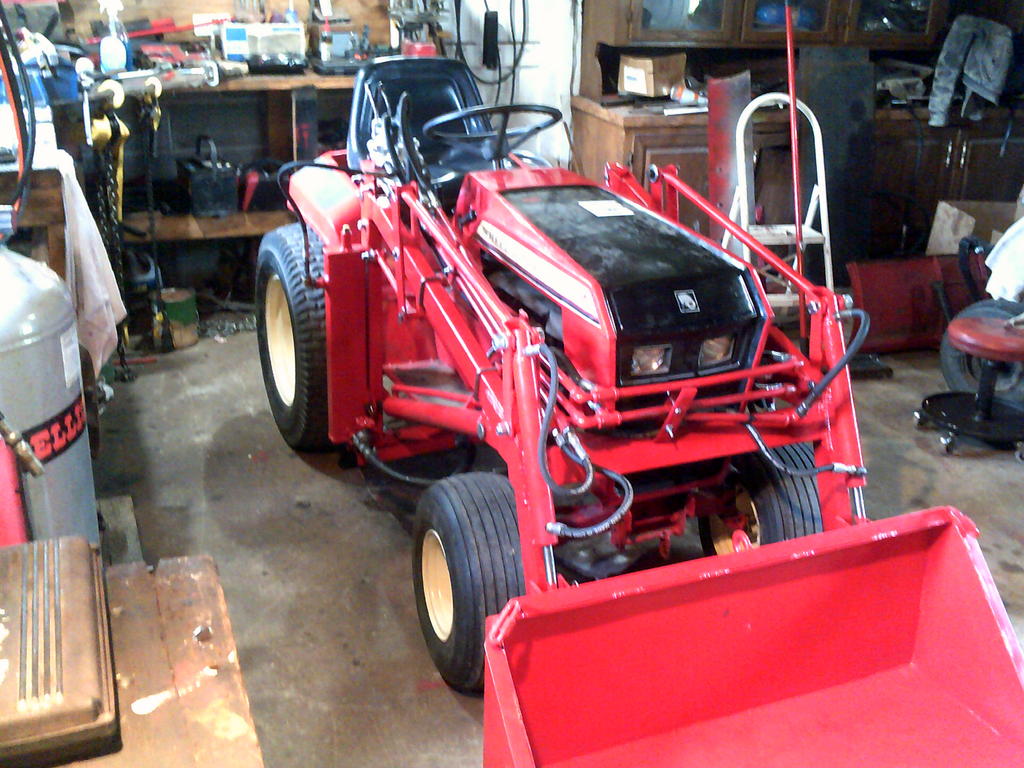

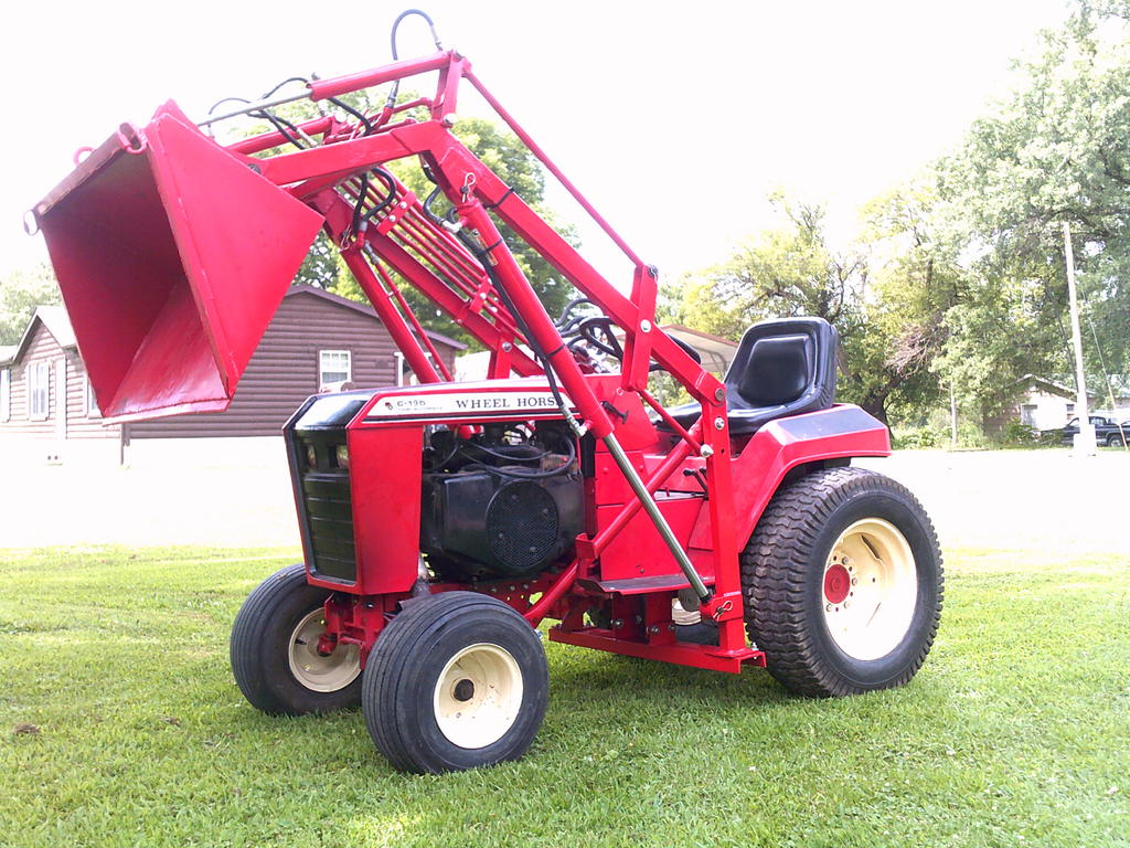

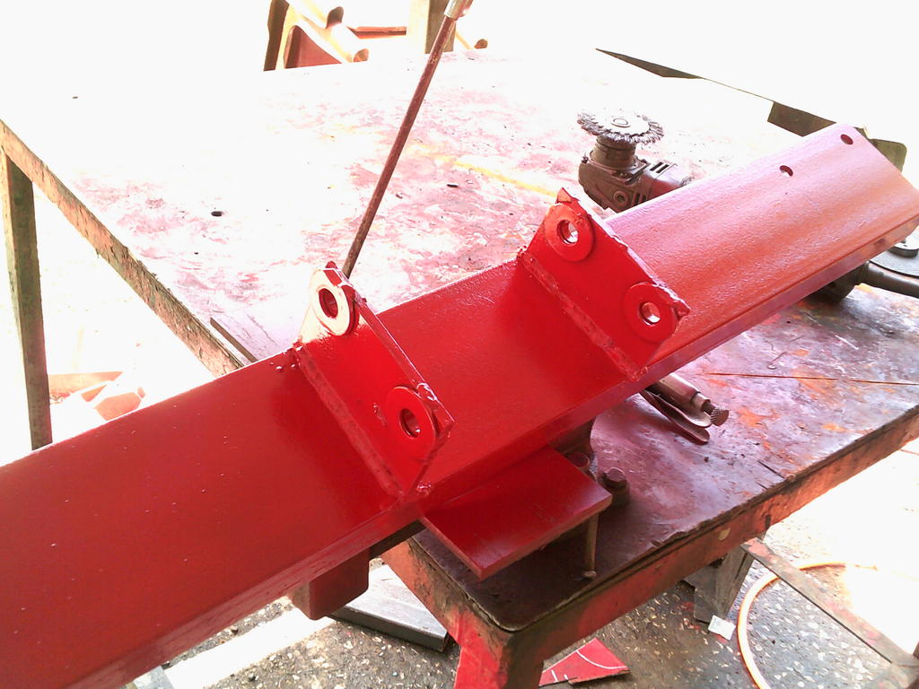

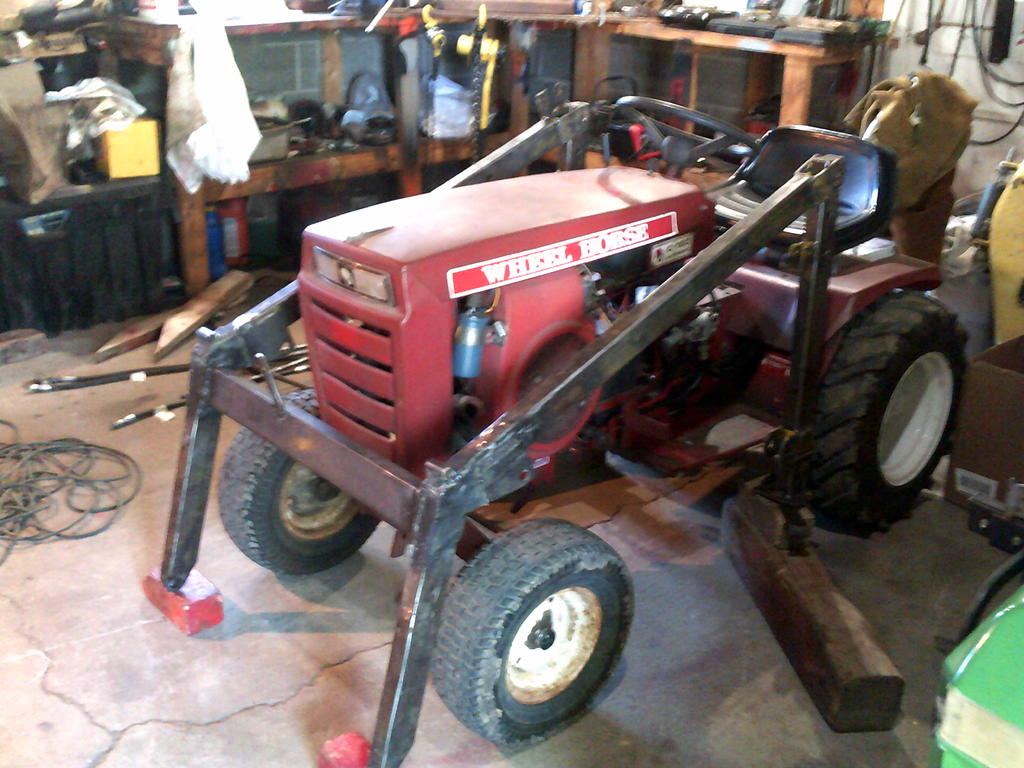

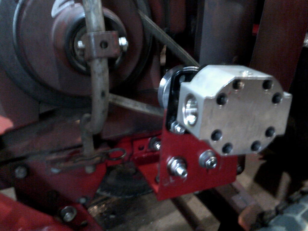

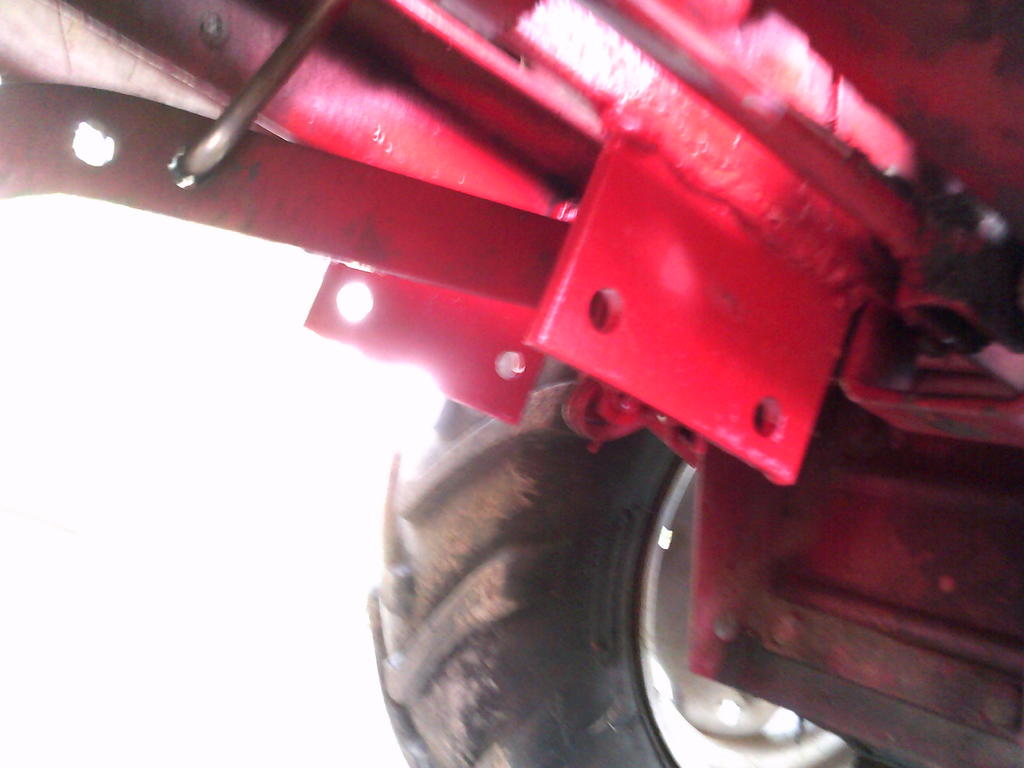

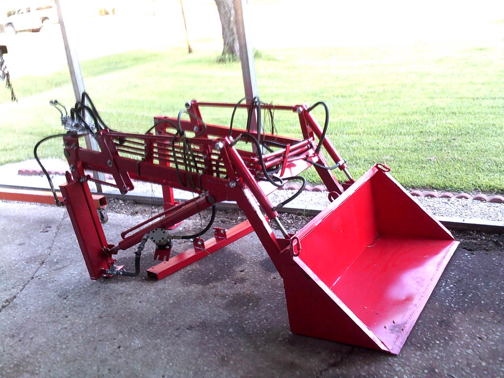

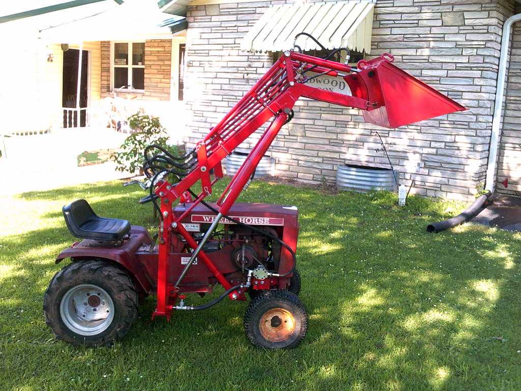

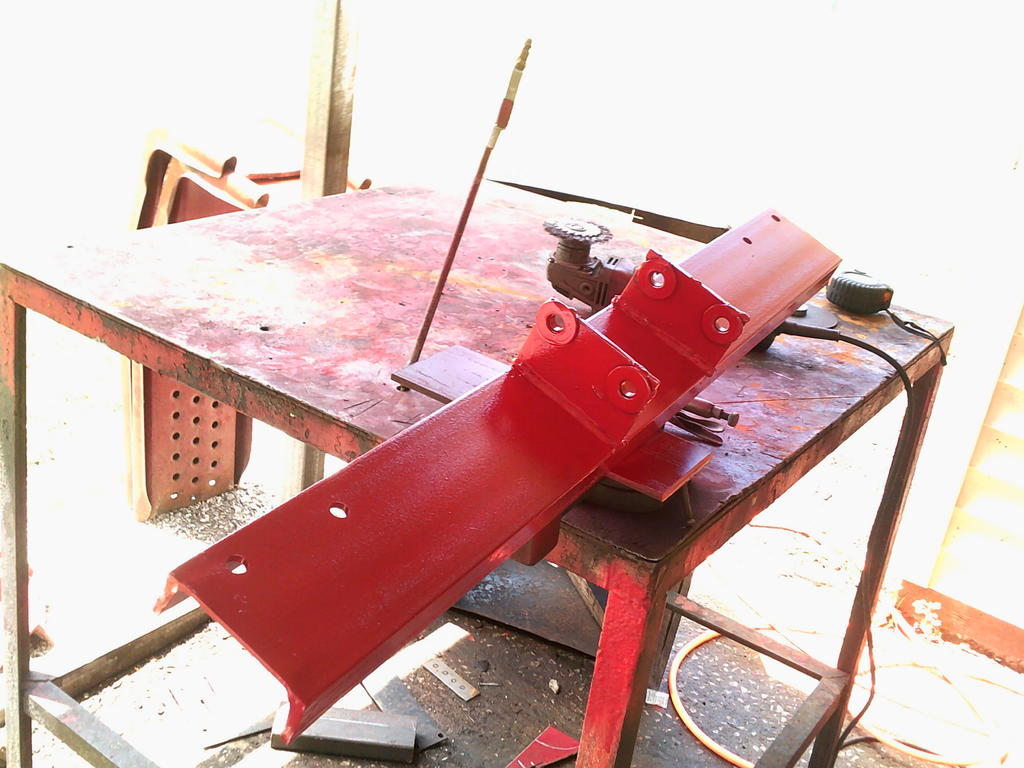

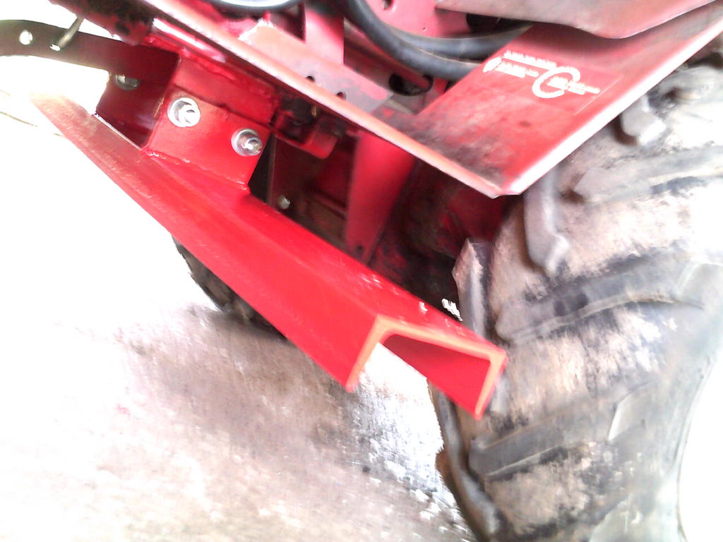

elliot ness 1,916 #1 Posted June 28, 2017 (edited) Started another loader the other day. going to put it on a C160. Will keep everyone up on pics. this will be for sale when complete. Call if interested 573-473-6944 I will make someone a great deal on just the loader , fare less then I go in it. Edited July 13, 2017 by elliot ness mounted it on a C-160 and then a C195 22 Share this post Link to post Share on other sites
WHX?? 57,810 #2 Posted June 28, 2017 Looks like you picked a good foundation! 4 Share this post Link to post Share on other sites
slammer302 2,157 #3 Posted June 28, 2017 Looks great so far. 2 Share this post Link to post Share on other sites
slammer302 2,157 #4 Posted June 29, 2017 What made you decide to go with the C-160? That 318 parked next to it would make a good candidate. 1 Share this post Link to post Share on other sites

12 hp Kohler 1,020 #7 Posted June 29, 2017 Looks great can't wait to see your progress as the project goes on 3 Share this post Link to post Share on other sites

elliot ness 1,916 #9 Posted June 29, 2017 9 hours ago, slammer302 said: What made you decide to go with the C-160? That 318 parked next to it would make a good candidate. The 318 is what my garage cat sleeps on, and she said no. 1 Share this post Link to post Share on other sites

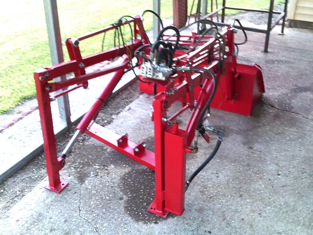

RedWheelz 149 #13 Posted July 13, 2017 Looks very well built!! Do you have plans for this loader ? 2 Share this post Link to post Share on other sites
Popasmurf 17 #14 Posted July 14, 2017 Plans for that loader would be a great thing. I'm sure a lot of folks would like to build one. Myself included. 1 Share this post Link to post Share on other sites

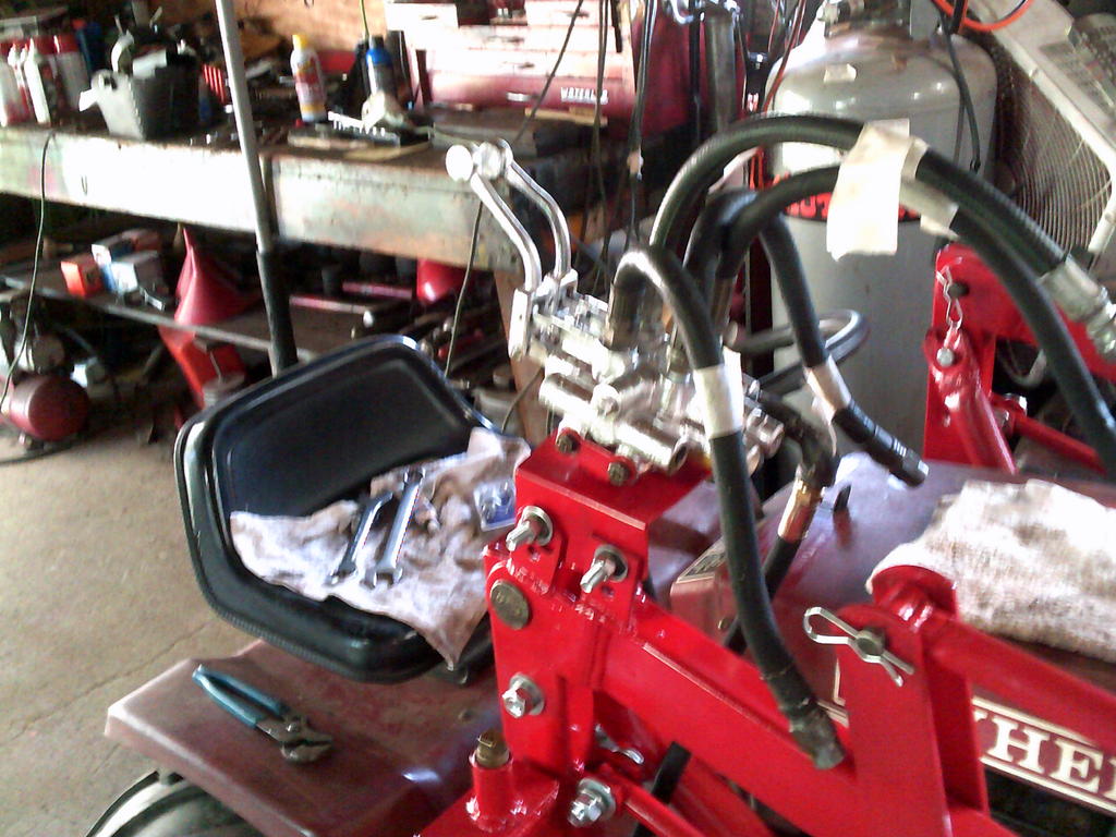

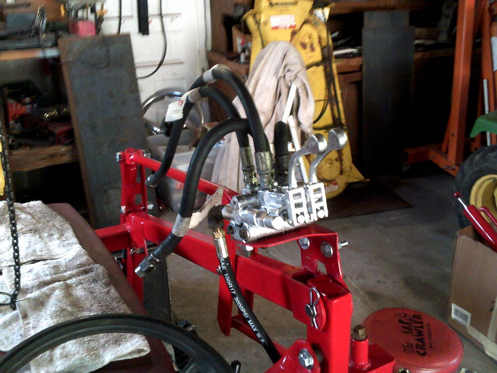

Duramax7man7 506 #17 Posted July 18, 2017 I'm curious why people don't choose to go with a 4 way joystick valve? 2 Share this post Link to post Share on other sites
Popasmurf 17 #18 Posted July 18, 2017 Is the cost less to go with the joy stick? Is it easier to control? 1 Share this post Link to post Share on other sites
Duramax7man7 506 #19 Posted July 18, 2017 From my inquiries, it seems that the cost of 4 way joystick is more than a 2 spool valve but it a lot easier to use and smother to operate. 1 Share this post Link to post Share on other sites
elliot ness 1,916 #20 Posted July 18, 2017 On 7/12/2017 at 9:13 PM, RedWheelz said: Looks very well built!! Do you have plans for this loader ? The plan will be to sell it. 2 Share this post Link to post Share on other sites
Popasmurf 17 #21 Posted July 18, 2017 15 minutes ago, elliot ness said: The plan will be to sell it. After it sells can we get plans? Lol great job! Share this post Link to post Share on other sites

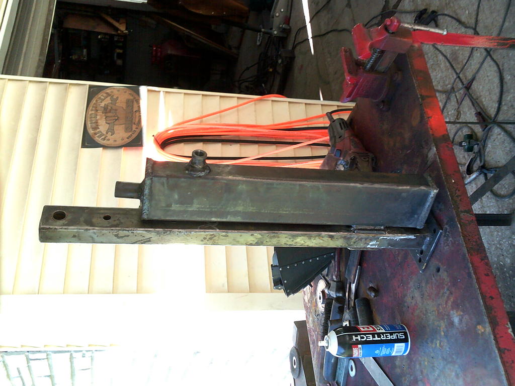

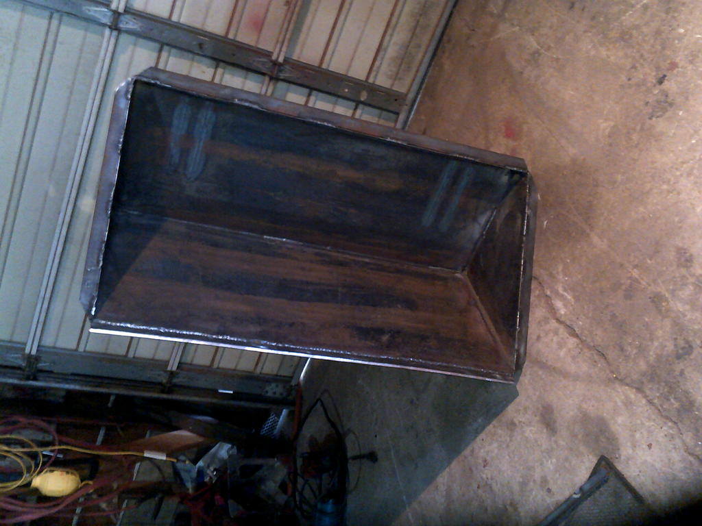

elliot ness 1,916 #22 Posted July 18, 2017 (edited) 19 hours ago, Popasmurf said: After it sells can we get plans? Lol great job! I never use plans, I start with square tubing set two pieces on a table and find the angle that looks right, mark it and cut it and weld it, and make a double for the other side. Then make a bucket using 1/8 plate, and 1/2 cutting edge, make the mounts for the cylinders, then comes the fun of getting the hoses and metal lines where you need them. I have made many loaders and everyone turns out different. I go to the metal shop and try to buy all the short cut pieces they got to save money. Hope this helps, If you start on one and have questions, PM me and I will try to help. some where in red square I have put a few of the loader that I built. Edited July 19, 2017 by elliot ness 3 Share this post Link to post Share on other sites

DennisThornton 4,773 #24 Posted July 19, 2017 I learned on a joystick and very quickly. I'm guessing I'd look like an idiot on a two spool. Same on a backhoe only worse! 1 Share this post Link to post Share on other sites
Duramax7man7 506 #25 Posted July 19, 2017 I've used to multi-spools on other equipment so I'm sure I would be fine but I really love the idea of joystick. when I make a loader I'll be doing my best to use a joystick. Share this post Link to post Share on other sites
