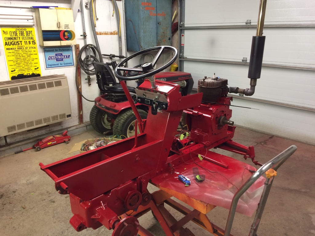

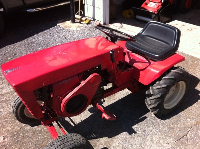

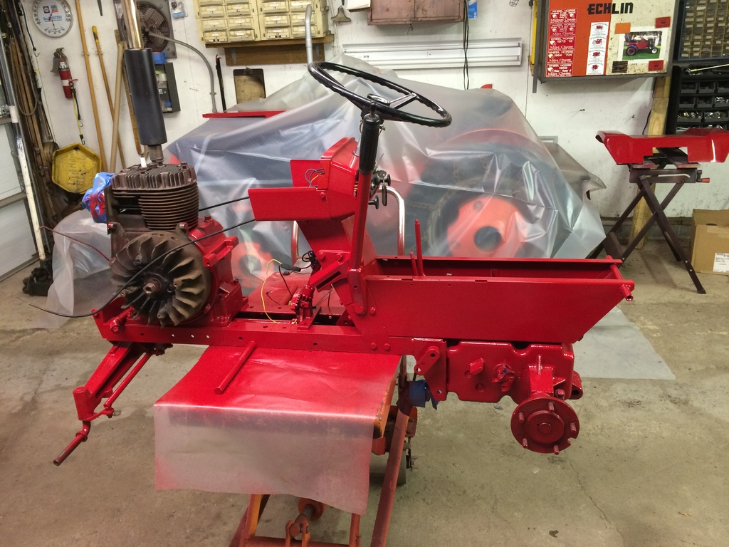

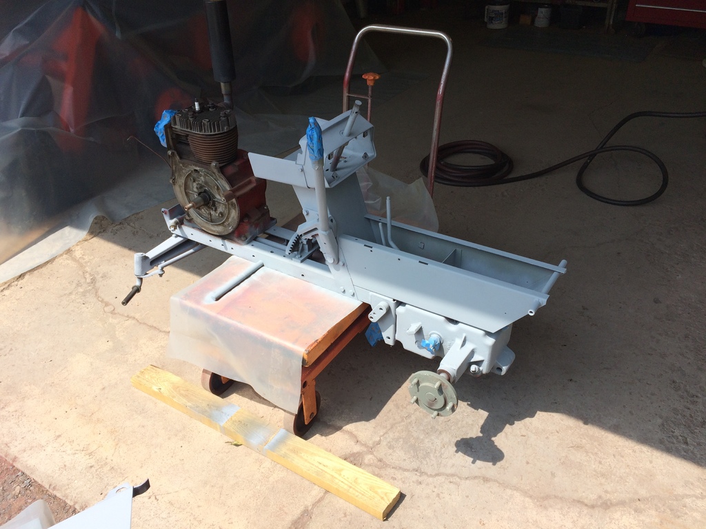

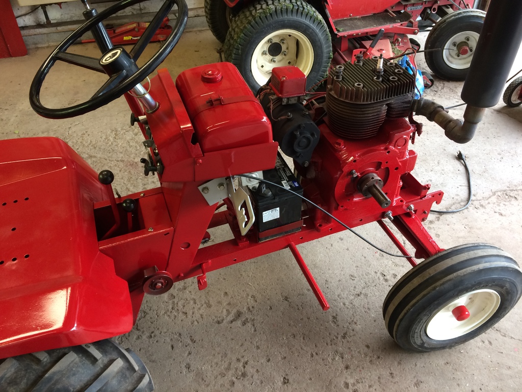

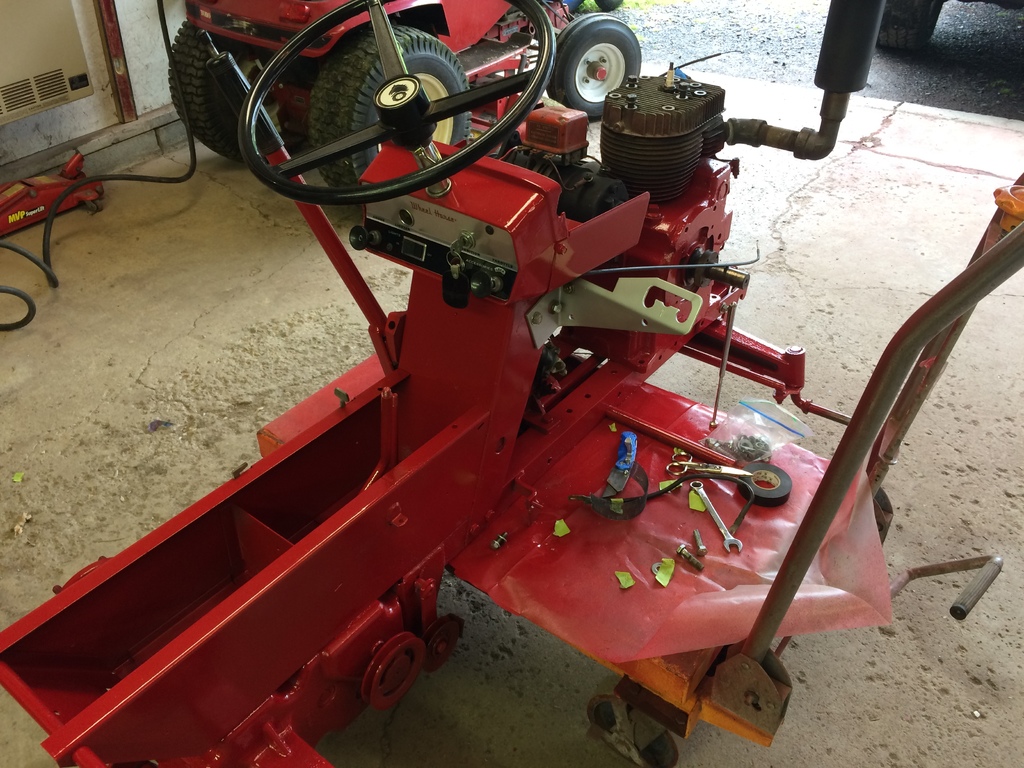

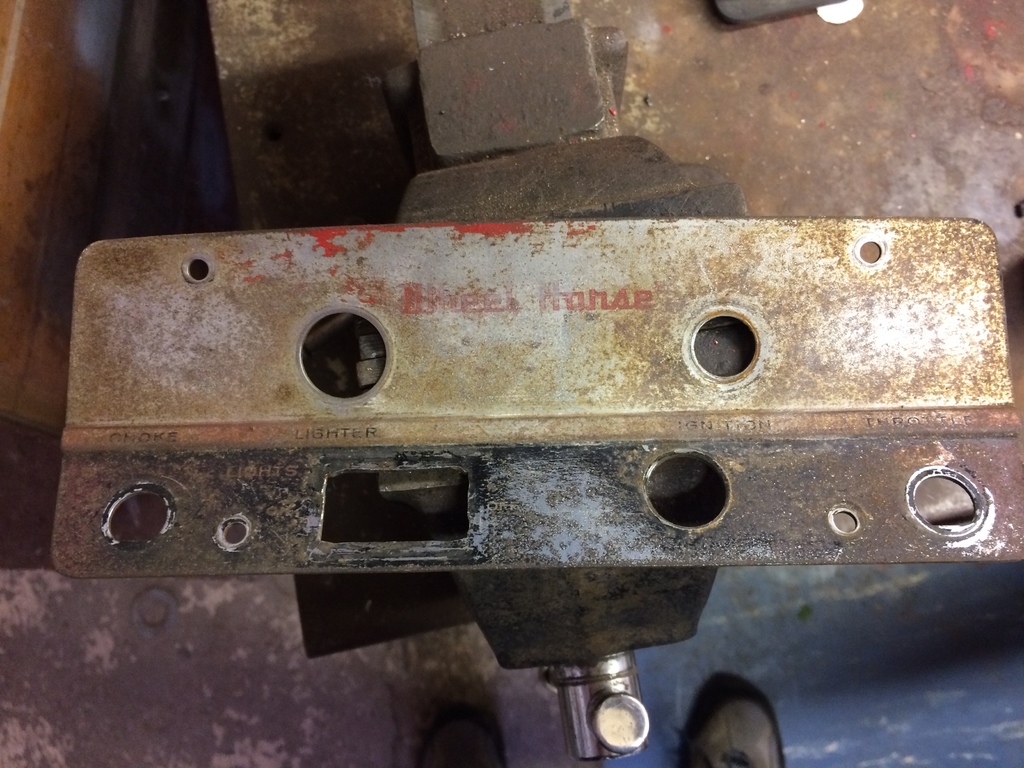

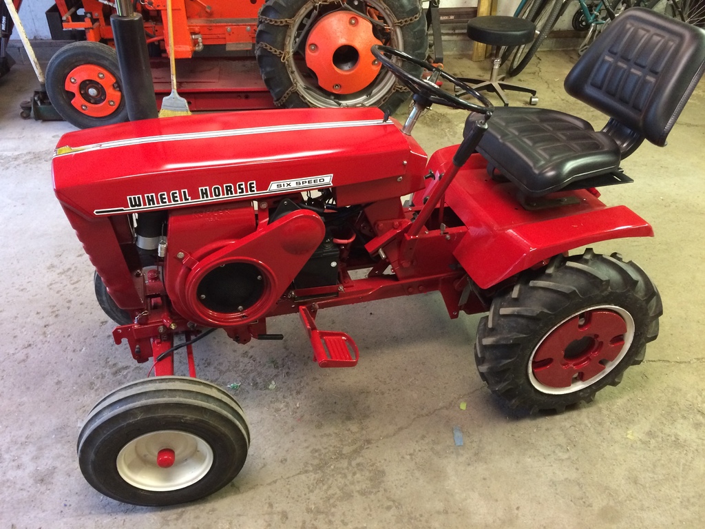

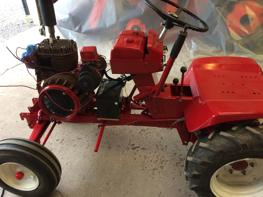

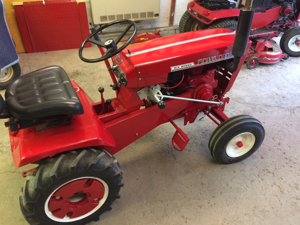

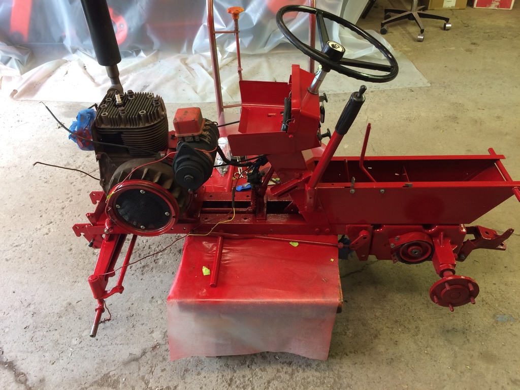

squonk 43,761 #1 Posted June 26, 2017 I kept this under wraps to unveil at the big show. Got tired of a pinkish tractor. Decals wouldn't be enough. i didn't want to go crazy as this is my snowplow tractor. The hood was bought at last years show and redone last fall. But everything else was done starting mid-April of this year. Started out with this: Torn down to it's skivies and primed: New dash decal: Finished: Skonk has been terribly loud. I tried about 4 different mufflers. I got it better but it was still pretty annoying. During this refresh I decided to change the points. I found the timing was way late and after setting the points correctly the engine is much quieter. you can hear the "Kohler Whine" now! 22 Share this post Link to post Share on other sites
