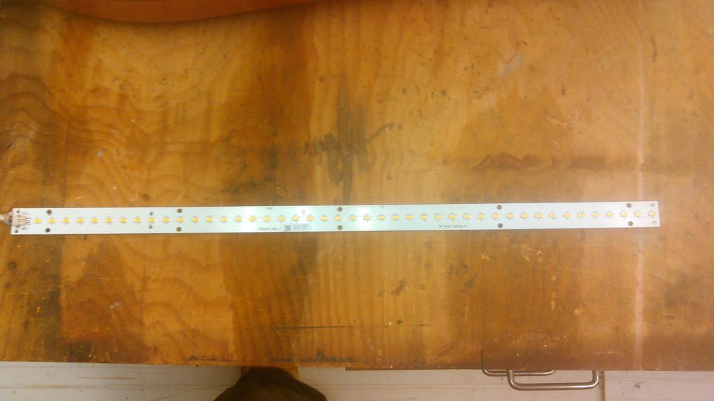

JPWH 6,544 #108 Posted March 14, 2018 I have the shop like I want it now so I can start working on tractors again. Today I was playing with adding more light in the blast cabinet. I have been rescuing led strips and drivers from the trash bin at work. This is what I'm adding. Before After 5 1 Share this post Link to post Share on other sites

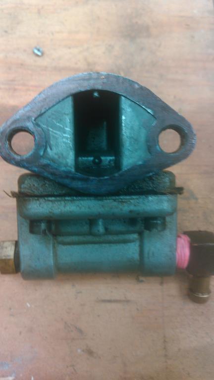

JPWH 6,544 #112 Posted March 18, 2018 I installed the led lights in the blast cabinet, hooked all the airlines back together so I could work on the 854 hoods and one of the air line quick connects was leaking and I didn't have a spare so I turned off the air compressors and decided to install the fuel pump on the 854 6 speed. Ran the fuel lines put gas in the tank and started it up. Runs great but now I have one oil leak instead of several. The fuel pump is not sealing I'll address that later. 3 1 Share this post Link to post Share on other sites

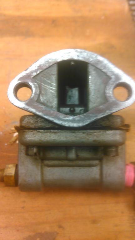

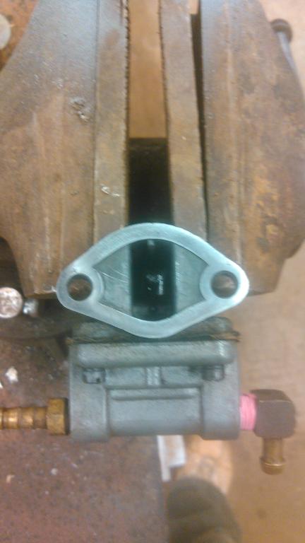

JPWH 6,544 #113 Posted March 21, 2018 Air line repaired and oil leak taken care of. Marked the surface with a Sharpe. After sanding with 220 grit. Remarked and sanded again with400. 8 Share this post Link to post Share on other sites
