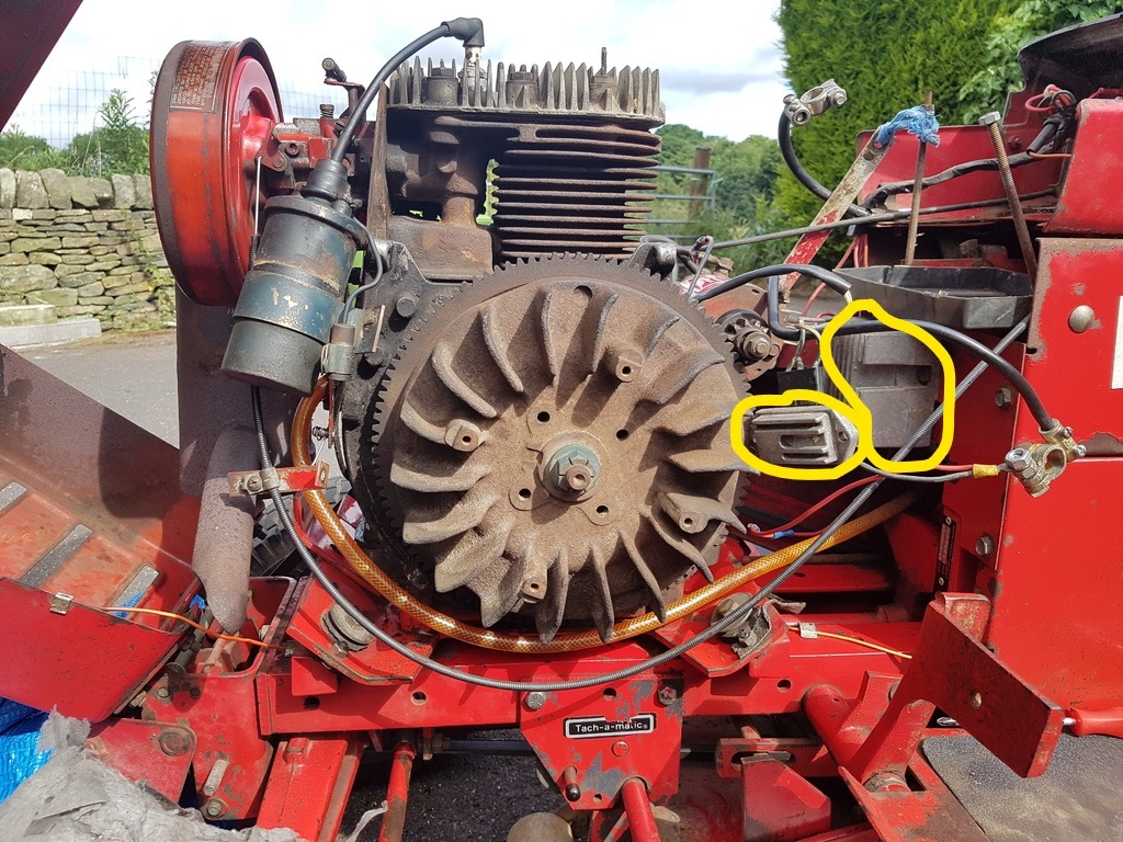

Bertie 314 #10 Posted June 26, 2017 Took off the air shroud this morning lots of gunk to clen following storagr etc all sorted now. Let me know if you spot anything else that needs sorting out in the pics.... 2 Share this post Link to post Share on other sites

pfrederi 20,251 #16 Posted June 28, 2017 You have 2 voltage regulators...Guess the big one died??? The small one has to be mounted in the air shroud for cooling purposes. 2 Share this post Link to post Share on other sites
Bertie 314 #17 Posted June 28, 2017 49 minutes ago, pfrederi said: You have 2 voltage regulators...Guess the big one died??? The small one has to be mounted in the air shroud for cooling purposes. I havent yet yet got to the electrics and the secondary smaller VR is now attached to the shroud as suggested...I want to revert to an original set up so hope they are available when I get time to sort it.. I have a few parts on their way from the USA but with handling and postal charges it makes for a big cost figure so need to find more parts if possible in the UK dealer network.... If not it will still get what it needs as I can't stand messing about with shortcuts... It's just the way I'm made 😉 Thanks for taking the time to post your thoughts/observations it's a great help to the new guy...👍 Share this post Link to post Share on other sites
gwest_ca-(File Mod) 12,146 #18 Posted June 28, 2017 See in your last photo below the bolted-on regulator on the vertical part of the hoodstand is the original Wheel Horse ID plate. Mind posting those numbers? Garry Share this post Link to post Share on other sites
