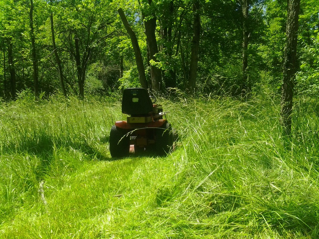

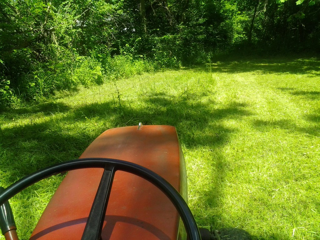

ohiofarmer 3,516 #11 Posted June 22, 2017 (edited) Edited June 22, 2017 by ohiofarmer Add text--10 Horsepower 42" SD two passes 2 Share this post Link to post Share on other sites

Ed Kennell 47,619 #17 Posted July 5, 2017 On 6/22/2017 at 6:21 AM, AMC RULES said: Here Ya go Craig.....I found this while deleting some old pics. That is my Raider 12 w/ 42"SD mowing the two year growth. 2 Share this post Link to post Share on other sites
