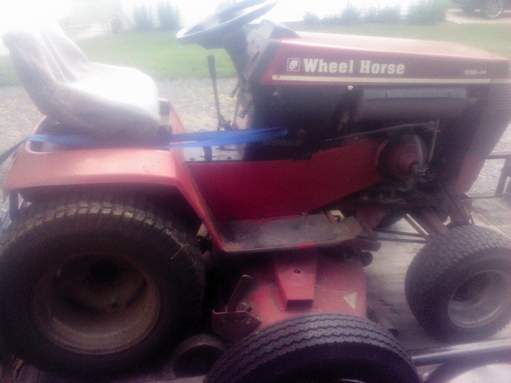

Big_Red_Fred 1,548 #1 Posted June 20, 2017 I just bought this 516H today, Tuesday June 20th, It ran Fine at a Collectors home in Dover Pa, tiny bit of rust, i'm hoping for a easy Build, Took it to a friends home, went to mow to see how it cut, under load after a hour it started Dieseling, up & down RPM, so i backed out of it and it smoothed out, it was never serviced in a while, Wednesday ill try a tune up & new fuel line & filter, this Onan doesn't have a Oil Filter ? Thought they all did, the collector said this model was only built 1 year ? What are your thoughts ? Bad Governor ? Bad gas ? or over all tune up, Newbie Big Red Fred putting out the call who is ever home & not hauln to the big show Share this post Link to post Share on other sites

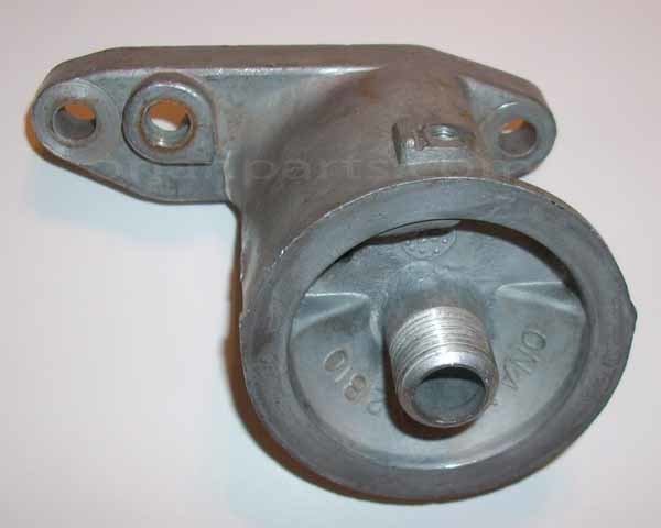

onanparts.com 185 #14 Posted June 27, 2017 15 hours ago, ericj said: the 88 516 DID NOT come with an oil filter, and from what I've seen it can not be added, my 516 that I had at the big show for sale, but now have decided to keep has a black rubber blank cover at the filter location. Not sure why it didn't have a filter, but I have seen several 516 and none have had the filter. eric j I did find two Onan production orders for Wheel Horse with the oil filter deleted. Onan model P216G-I/10538B & P216G-I/10691B, Very rare, as already stated filters were standard on all the P series from 1987 and up. There "should" be a block off plate bolted to the block. If removed, the oil filter adapter, part # 122-0814 can be installed. It will bolt right up. Only reason to omit the filter is possibly a clearance issue due to the engine mounting location? Difficult or impossible to remove/replace it. If so, that's a lousy engineering design! However, if there are no clearance problems then adding the filter would be a no brainer. All Onan production orders I have located so far are here: http://www.wheelhorseforum.com/topic/63296-onan-engine-unit-production-orders/#comment-597935 1 Share this post Link to post Share on other sites

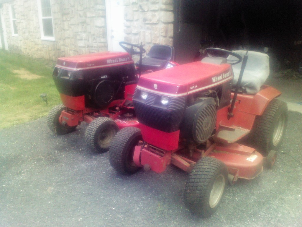

Big_Red_Fred 1,548 #16 Posted June 27, 2017 Id sure like a Full Pressure Lube System, i missed the Big Show, Being a 1 Man Diesel Mechanic makes it hard, i seen the traffic heading towards Pittsburg, Pa, I wanted Info on my 516H, If i write that part number down & go to Cummins, maybe they can get 1 for me ? Son went to get The 417-8 out so i shot this pic, Hey its a Parade ! Share this post Link to post Share on other sites

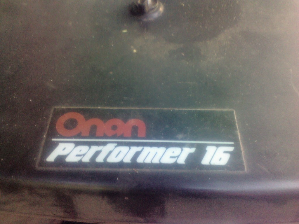

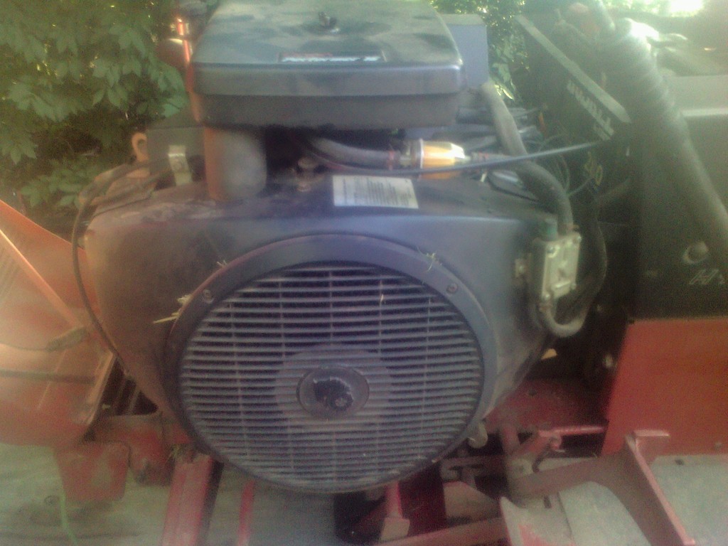

onanparts.com 185 #17 Posted June 27, 2017 New filter adapters discontinued long ago. Used ones available. First, can you make out the Onan ID sticker info on the top of the engine shroud? If so, what are the full model and spec numbers? Second, pull the plastic plug from the side cover and take a look. Can you see the block off plate? Two bolts holding it. Should be an oil sensor screwed into the plate. Share this post Link to post Share on other sites
Big_Red_Fred 1,548 #18 Posted June 28, 2017 I saw the sensor, i will bring home my snapon scope to see better around the corner, didnt have my lite, tried to get my hand in the hole but to large, its at my sons home, check it out & send you the numbers, thanks. I always thought too they came with a filter, My Miller 170 stick welder at my shop has a 20hp onan with a filter Share this post Link to post Share on other sites
