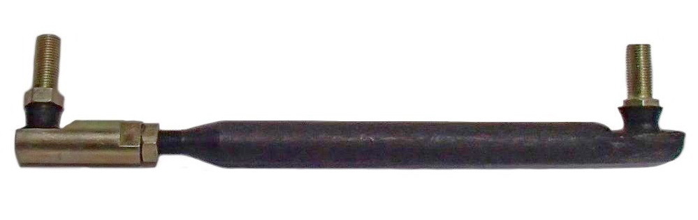

Amcwheel85 2,060 #1 Posted June 18, 2017 My daughters C81 has had very bad toe out and I'm wanting to fix it. I'm thinking these tie rods are to short measure 10 inches. So are they right? Looks like I need atleast half inch on each one. If these are not the right ones I will be putting wanted ad out for longer tie rods. Thanks for any info guys! Share this post Link to post Share on other sites
rmaynard 17,509 #2 Posted June 19, 2017 The tie-rods for the C-81 are part number 78-2900. Because it is adjustable, that single part number is good for either side. The overall length is approximately 10". However, that will vary due to the adjustabilty of the length to correct toe-in. Mine are approximately 9-7/8", but can be adjusted from about 8-1/2" to 10-1/2". 3 Share this post Link to post Share on other sites
Amcwheel85 2,060 #3 Posted June 19, 2017 Well mine measure 10 but it has crazy toe out.. is there something I could be doing wrong? Adding 1/2 inch to both tie rods would maybe make it perfect Share this post Link to post Share on other sites

gwest_ca-(File Mod) 12,430 #7 Posted June 19, 2017 Try switching them left and right. The non-adjustable style have a left and a right. Mounting them on the opposite side of the front steering shaft/arm will change the toe-in. Garry 2 Share this post Link to post Share on other sites
