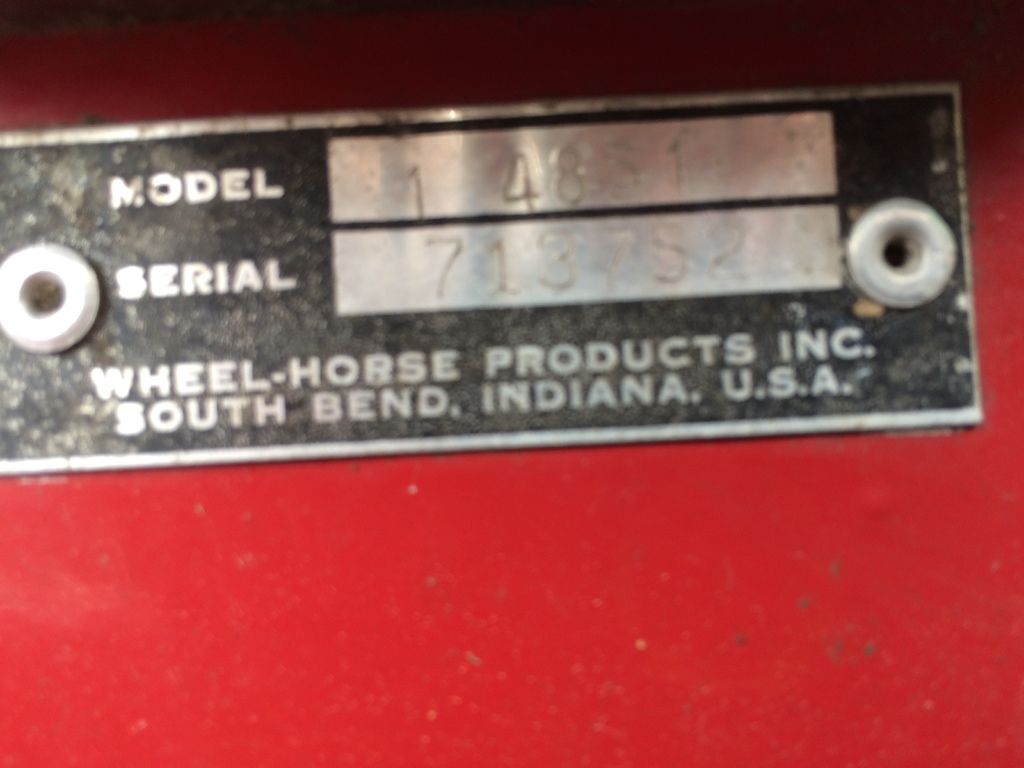

gwest_ca-(File Mod) 12,533 #2 Posted June 18, 2017 Is the serial number 713752? Here is a 1969 manual Garry 1 Share this post Link to post Share on other sites

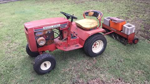

AMC RULES 37,260 #9 Posted June 19, 2017 Click on this link above...yours looks like this one? 1 Share this post Link to post Share on other sites
Popasmurf 17 #10 Posted June 19, 2017 53 minutes ago, AMC RULES said: Your model # says it it is a Kohler powered unit. 1-4851 1970 Lawn & Garden Tractor Commando V8 4-Speed Kohler KV181S-37116B 8 Wheel Horse 5066 Mine is a 3 speed, the motor doesn't say Kohler any place on it. I will take some pictures and post them tomorrow. Thanks for all the help 45 minutes ago, AMC RULES said: Click on this link above...yours looks like this one? My unit has headlights, the hitch is different, and my motor is different. 1 Share this post Link to post Share on other sites

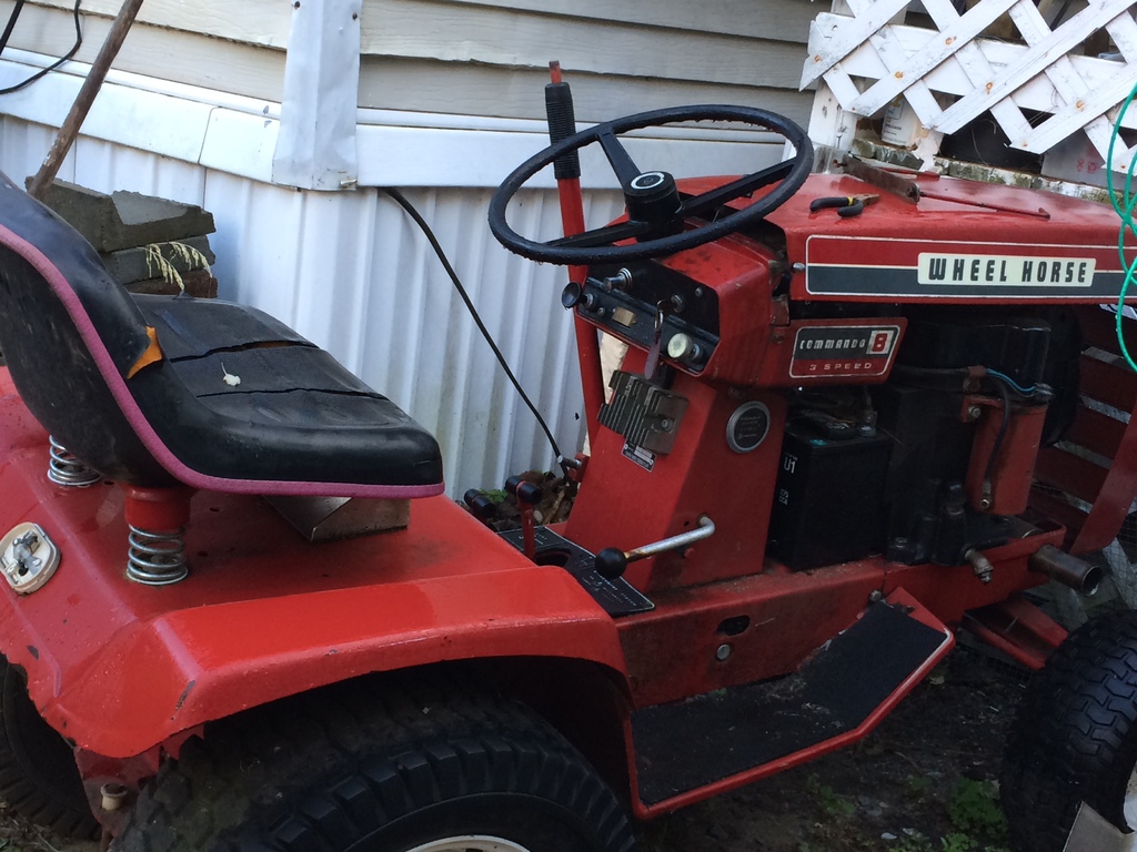

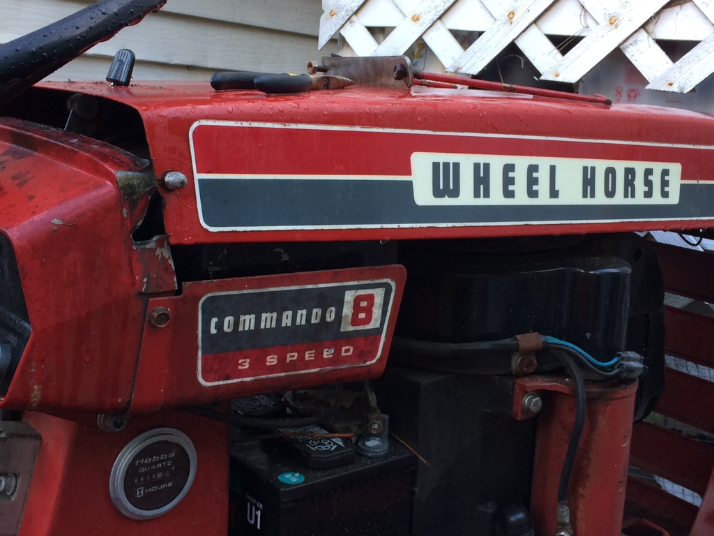

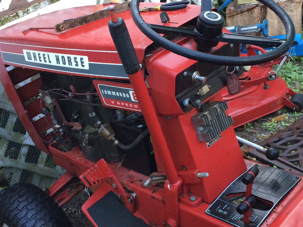

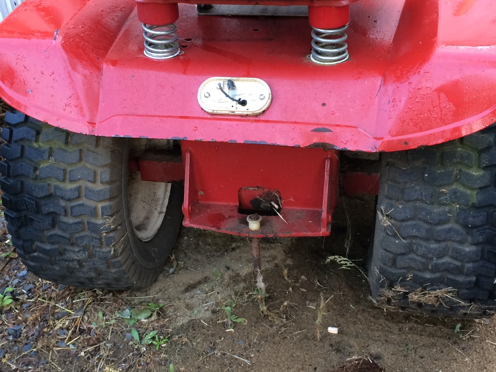

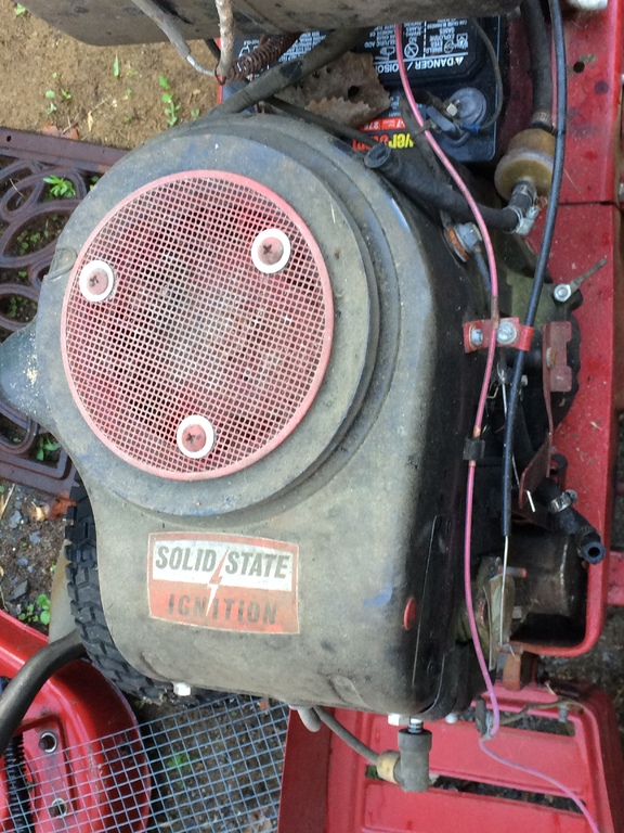

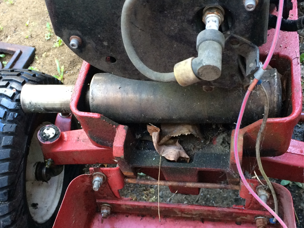

Popasmurf 17 #12 Posted June 19, 2017 Ok gang, here are some pictures of my tractor. I hope it helps figure out what I really have so I abc order a new carb and get her running. Thanks. Share this post Link to post Share on other sites

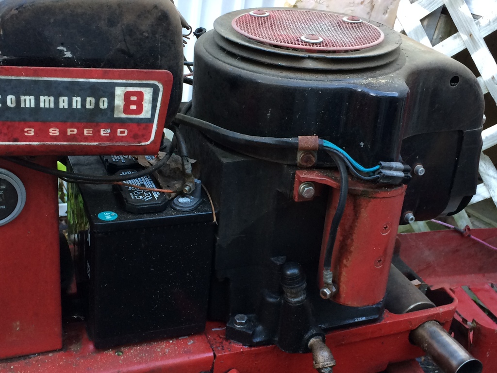

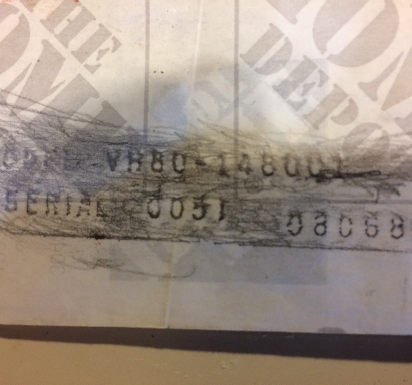

Popasmurf 17 #13 Posted June 19, 2017 Here is the info off the motor if anyone can figure out what the motor is and what I need to know to order a new carb and spark plug. Everything else seems to work as it turns over just fine. 1 Share this post Link to post Share on other sites
pfrederi 21,306 #14 Posted June 19, 2017 (edited) It is a Tecumseh vertical shaft 8hp. To get parts you need the VH80 and 148001 Serial # also Do you have spark when it turns over?? If not hold off on spending money on a carb. If you have no spark then the solid state ignition may have gone bad. it is expensive to replace. I would check that out before i dropped money on a carb as you may decide to replace teh engine. If you are mechanically/electrically inclined are some work arounds to replace the Solid state ignition. You have to research on teh web. Edited June 19, 2017 by pfrederi 3 Share this post Link to post Share on other sites

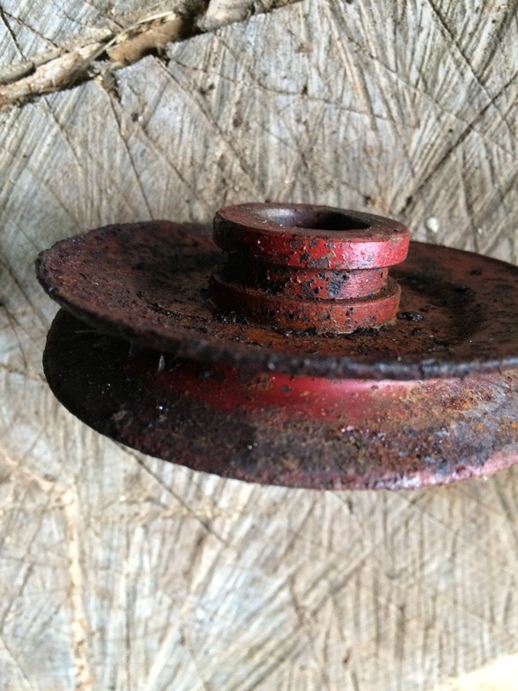

Popasmurf 17 #22 Posted June 21, 2017 11 hours ago, Professor1990 said: Nice looking V8 you have there...had one identical to it for a while. Very capable machine for only being 8HP and a vertical shaft. The Tecumseh can be a bit finicky to get running just right, but with a little patience and tinkering you should be able to have her running like new again...and I'm working on the mower deck and need 2 new pulleys if anyone has any idea where to find them that would be a huge help. Thanks Share this post Link to post Share on other sites
RedRanger 1,470 #23 Posted June 21, 2017 You might just try sanding/polishing those. They don't look too bad, unless they are very pitted or bent? I'd sand blast them or hit them with a wire wheel and see what they look like. Rough surface will eat belts, but if you can get the rust off and sand/polish/wire brush the belt surface, they might work fine. 1 Share this post Link to post Share on other sites
Popasmurf 17 #24 Posted June 21, 2017 1 hour ago, RedRanger said: You might just try sanding/polishing those. They don't look too bad, unless they are very pitted or bent? I'd sand blast them or hit them with a wire wheel and see what they look like. Rough surface will eat belts, but if you can get the rust off and sand/polish/wire brush the belt surface, they might work fine. Unfortunately they are rusted away on the bottom sides😢 Share this post Link to post Share on other sites
Popasmurf 17 #25 Posted June 21, 2017 I found that the model # for this unit with the Tecumseh motor should end in "2" not "1" which tells me there was a motor swap some where along the line . I found the pulleys. If anyone wants a great source for Toro / wheel Horse parts with knowledgeable folks that actually return a call... 2 Share this post Link to post Share on other sites
