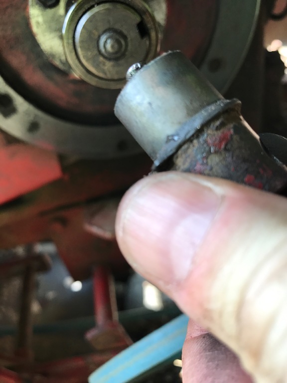

zeke37 24 #1 Posted June 18, 2017 OK so the stud has sheared. EZ out? is it done for? any info appreciated. Share this post Link to post Share on other sites
WHX?? 56,851 #2 Posted June 18, 2017 EZ out should get that out. Start by filing a flat spot to get a good center punch in the center. Drill a small hole working your way up ez out size. Your favorite penetrant and/or heat may be required. 3 Share this post Link to post Share on other sites
wallfish 20,053 #3 Posted June 18, 2017 Seems to me that EZ outs work anything but EZ.. Weld a nut to it and back it right out 10 Share this post Link to post Share on other sites
squonk 46,886 #4 Posted June 18, 2017 Isn't that the stud that's supposed to help release the PTO clutch that has been eliminated on most of them? Might just be able to leave it. 2 Share this post Link to post Share on other sites
WHX?? 56,851 #5 Posted June 18, 2017 One of these days I do have to buy that welder! Share this post Link to post Share on other sites

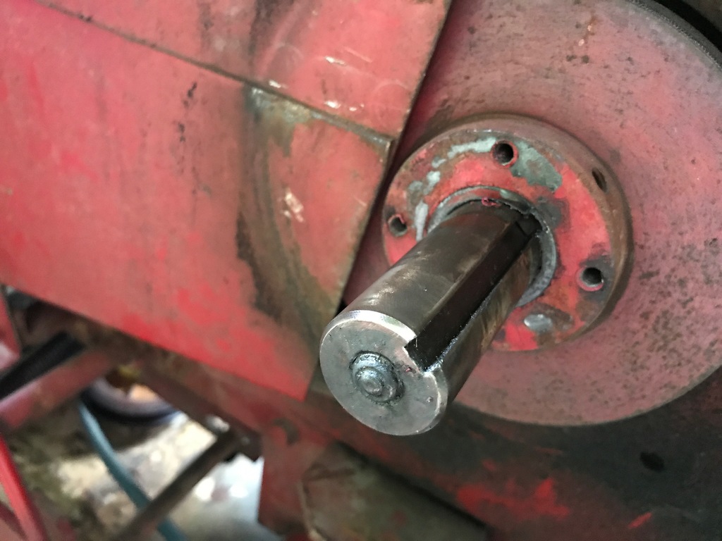

zeke37 24 #6 Posted June 18, 2017 I think the stud holds the PTO Shaft in. It literally fell out of the clutch when I touched it and had a chunk of the broken stud in it. If I am wrong about this I'll be very happy, but I believe the stud is what keeps everything together. Share this post Link to post Share on other sites
Racinbob 12,996 #7 Posted June 18, 2017 I'm thinking like Mike is. Something like that happened to my C160 years ago.....make that 3+ decades. I don't think the owner for the past 17 years ever messed with it and it's still fine today. The bearing race is held captive to the facing and essentially the loop keeps everything else in place in place. Anyways.....that's what I'm thinking but I've slept a bunch of times since then 2 Share this post Link to post Share on other sites
squonk 46,886 #8 Posted June 18, 2017 Yes. My 76 C-160 shows the stud,spring and related parts inside the PTO. Newer tractors shows that stud ect. eliminated. If I remember right mine came apart years ago. I replaced the outer brg. stud the hoop hooks to and the retaining snap ring. i think my worn out stud wiggled out. I would file it smooth. 1 Share this post Link to post Share on other sites

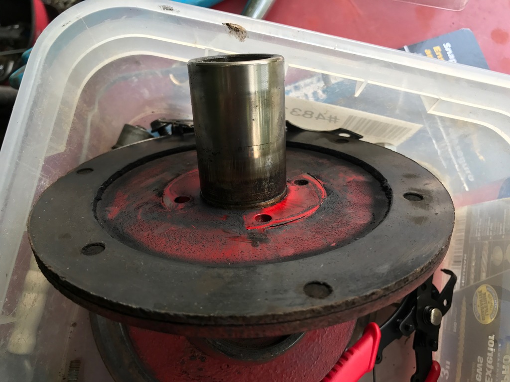

squonk 46,886 #11 Posted June 18, 2017 judging by your fuzzy pic of the clutch disc in the background, it's seen better days. Share this post Link to post Share on other sites
zeke37 24 #12 Posted June 18, 2017 (edited) About to post a better pict,but would a worn out clutch plate cause a bog on tall grass? I plan on replacing it immediately but am wondering if I am addressing the problem. Edited June 18, 2017 by zeke37 Share this post Link to post Share on other sites
squonk 46,886 #13 Posted June 18, 2017 When you say bog, do you mean the blades are bogging down or the whole tractor? Share this post Link to post Share on other sites
zeke37 24 #14 Posted June 18, 2017 (edited) just blades, pto stops moving, engine is still running strong, and when I tighten the belt it stops as well, although no notice in engine. Edited June 18, 2017 by zeke37 Share this post Link to post Share on other sites

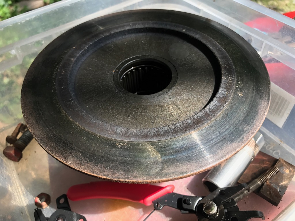

squonk 46,886 #15 Posted June 18, 2017 (edited) Sounds like the disc is slipping to me. If it was gripping well, the engine would slow down and labor with the blades. Lets see a pic of the PTO bell surface that presses against the disc. I see uneven wear on that disc. Your bell may be worn out. Edited June 18, 2017 by squonk Share this post Link to post Share on other sites
zeke37 24 #16 Posted June 18, 2017 looks like it is scored a little bit but is it worn out? how can you tell? I do see some drop from the inside to the outer edge. could this be machined out or is it done? Mike I really appreciate your wisdom and time helping me out. Share this post Link to post Share on other sites
squonk 46,886 #17 Posted June 18, 2017 Looks like it got hot and is warped. If I remember right someone on the forum had one machined once. Maybe @wallfish? If not they are always on E-bay. Share this post Link to post Share on other sites
