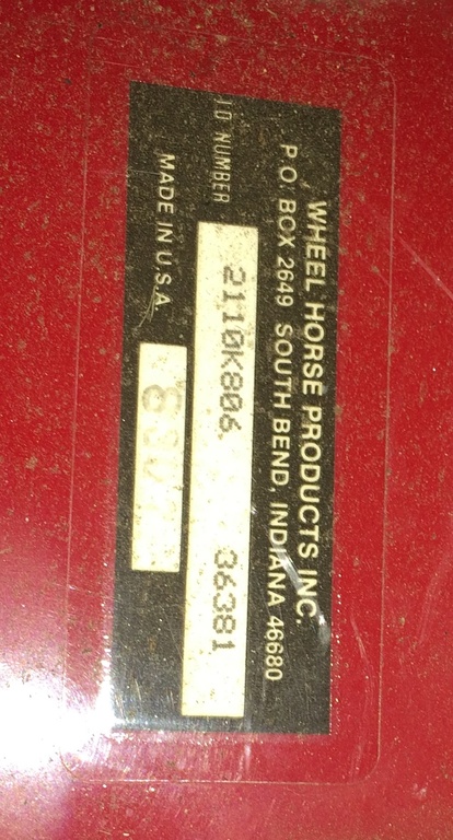

gwest_ca-(File Mod) 12,324 #7 Posted June 20, 2017 Post the numbers off the ID decal. Many changes between 1985 and 1990 that could have been purchased new in 1989. Model # Serial # Build date # Garry Share this post Link to post Share on other sites
Maintenance Man 0 #8 Posted June 20, 2017 hows this Share this post Link to post Share on other sites
gwest_ca-(File Mod) 12,324 #9 Posted June 20, 2017 Each circuit has it's own diagram for late production. (Lights will work without the engine running) Garry Share this post Link to post Share on other sites
