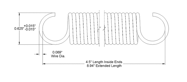

salty57 2 #4 Posted June 17, 2017 Need for 857 but will work for 856, 867, 875, 876 etc. brake clutch spring part number 5714. Could have one made but picture in manual only shows one end and no dimensions. Desperate need so can mow lawn that is now 24+ inches tall. Share this post Link to post Share on other sites

rmaynard 17,644 #6 Posted June 17, 2017 (edited) Here is a drawing from McMaster-Carr of the 9433K111 spring as mentioned in the previous post. I have used these on many models. Edited June 17, 2017 by rmaynard 3 Share this post Link to post Share on other sites
salty57 2 #7 Posted June 17, 2017 Wow I seriously appreciate the quick responses. Placed the order on McMaster Carr already. Deal with them for work and didn't think about them but would not have known what I needed without you since the spring fell apart completely and couldn't find all of it.... Thanks again Salty57 1 Share this post Link to post Share on other sites
