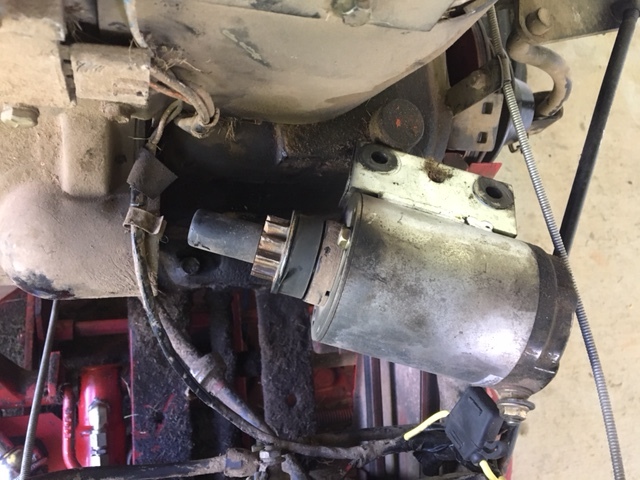

ottsm 23 #1 Posted June 17, 2017 I have a 14HP Kohler engine for my Wheel Horse. I had issues with the starter not engaging and realized the two bolts that hold the starter to the engine block were loose. I tried tightening them and I cold only go so far. Next I tried backing them out and could only get so far. I'm kind of stuck in between, perhaps someone put a heli coil in them and things are just galled up, I can't really tell. I'm afraid I'll just snap the bolts off or totally strip the block out. Anyone else have this problem? Share this post Link to post Share on other sites

ottsm 23 #14 Posted June 18, 2017 What is happening is that the starter is loose and sometimes doesn't fully engage. I can hold the starter tight against the block it starts fine. But because of this I'm sure if I took the starter off the teeth are probably worn because when it doesn't fully engage the teeth slip and grind. This is why the problem needs fixed. Share this post Link to post Share on other sites

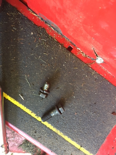

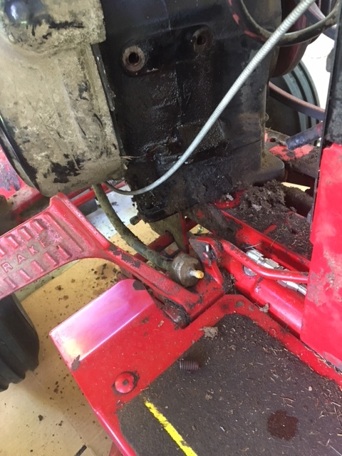

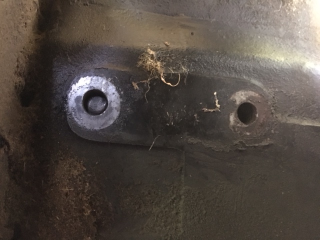

ottsm 23 #19 Posted June 25, 2017 Bolts are out, soaking in Kroil for several days helped as did wedging. One bolt was actually broken and I had to use an extractor. I rechased the threads and the new bolts I put in seem to hold. I'll be watching them for awhile to see if they back out. The pictures show the before and after. 3 Share this post Link to post Share on other sites
