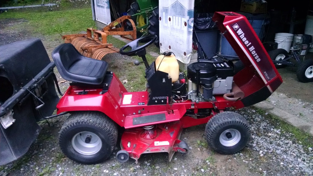

jetwrench 4 #1 Posted June 17, 2017 Discovered this Wheel Horse 212-H for sale locally, which was posted as having an engine that will not start with no explanation relating to the severity of the failure. It appears after speaking with the owner that the unit was running normally, started to backfire and ultimately shutdown. When attempting a re-start it appeared the engine was spinning free with little or no compression available to limit the crank speed and would not start. Having limited mechanical ability the owner felt the problem was more severe than he was comfortable undertaking suggesting the problem may very well be associated with a major internal component failure. It appears the owner made no attempt to troubleshoot any further to verify the integrity of the Crankshaft/Connecting Rod Assembly or Camshaft by at least removing the spark plug or valve spring cover just to check for piston or valve movement, so from this point forward any suggested possibility for the no start condition is pure conjecture. The Engine in question is a 12HP Briggs and Stratton Model 284707 Power Built. If further troubleshooting reveals the engine has a major problem that requires tear down or replacement to resolve, what would be a fair price for the unit as is considering its condition? Additionally, what are the more common problems or component failures associated with this specific model or type engine? 2 Share this post Link to post Share on other sites
Digger 66 3,530 #2 Posted June 17, 2017 48 minutes ago, jetwrench said: When attempting a re-start it appeared the engine was spinning free with little or no compression available to limit the crank speed and would not start. Welcome to Red Square . From your description ... It sounds like a broken valve spring . I have heard of timing issues with these caused by a sheared ( or damaged ) flywheel key . It appears to be a well-kept machine . Offer him a couple hundo for it , take her home & start digging . Worse case , a new motor is maybe 250 bucks ? 1 Share this post Link to post Share on other sites

953 nut 70,341 #4 Posted June 17, 2017 When a connecting rod breaks it is generally more dramatic than a bit of backfiring! If you remove the spark plug you should be able to hear/feel a bit of air movement as the engine is turned over, if not then the rod is the likely problem. If you are going to do the work your self it will be an adventure, if you plan to pay a service facility to do it the likelihood is they will want you to buy a new engine for $ 700 plus installation labor. Chances are that no one is going to offer him more than $ 100 in the present condition. 3 Share this post Link to post Share on other sites
SPINJIM 1,998 #5 Posted June 17, 2017 (edited) I agree; sounds like a valve problem. You shouldn't have to dig too deep (tie rod) to fix it. I'd offer him $100, and maybe be willing to go to $150 because it looks like a well maintained machine otherwise. Did the owner keep the oil level up ? I don't think the seller will find many people willing to go to $200 for a non-running mower. Good luck, Jim PS - Let us know the outcome. We always like to know how good or bad our advise was. Edited June 17, 2017 by SPINJIM 2 Share this post Link to post Share on other sites
SylvanLakeWH 32,823 #6 Posted June 17, 2017 Everyone else already has it covered...non-running - no more than $100. Looks good otherwise. Share this post Link to post Share on other sites

Racinbob 13,286 #12 Posted June 18, 2017 I'm thinking the owner would accept a low offer but even at $200-$250 I don't see it as a bad deal. It looks real nice and then there's the Wheel Horse steering wheel and I'm pretty sure that's a logo seat........ 2 Share this post Link to post Share on other sites
