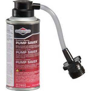

Racinbob 12,817 #10 Posted June 17, 2017 Excellent info Joe. Thank you. After going through 3 pressure washer, 2 Briggs and 1 Honda I decided to go with a horizontal shaft unit. 1 of the Briggs and the Honda lost the engines. The pump casting broke on the other Briggs. I now have a Generac and so far, so good. It seems to run 'easier' to me. One thing I do after each use is to squirt it with this: 3 Share this post Link to post Share on other sites
