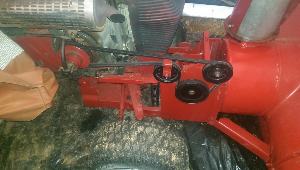

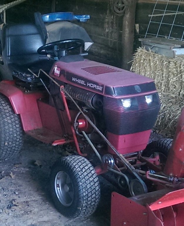

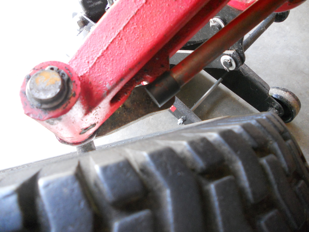

WVHillbilly520H 10,377 #3 Posted June 16, 2017 (edited) That's the 520 swept forward axle correct? It's for the mower/blower PTO belt clearance, or for tie rod clearance when turned full lock, Jeff. Edited June 16, 2017 by WVHillbilly520H 3 Share this post Link to post Share on other sites

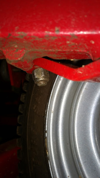

Cee245 850 #11 Posted June 17, 2017 I think I've figured it out. If you go out to your tractor and turn the wheel all the way left. Look on the flywheel side (left) and then look underneath, you should see where the part that holds the tie rod would bind on axle if not for the notch being there. Looks like it helps with turning radius. Cory 5 Share this post Link to post Share on other sites

squonk 45,083 #14 Posted June 17, 2017 None of my 3 tractors has that notch. but the location lines right up with the PTO belt to mower deck travel area. Just like in Hillbilly's first pic. If the belt is loose enough it will flop and rub against the axle. Also if you use too short a PTO belt the mule drive pulleys may contact the axle. I have seen this happen. Perhaps WH decided to give a little room in that area to keep the belt and pulleys from being damaged. Share this post Link to post Share on other sites

squonk 45,083 #17 Posted June 17, 2017 Ok. Looks like Hillibliiy's pics are of different notches than Mikee's. (sent from in front of the A/C with crapatalk) 3 Share this post Link to post Share on other sites

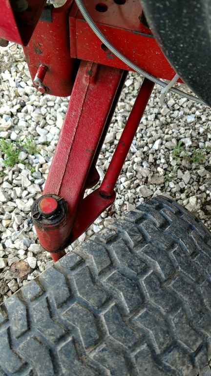

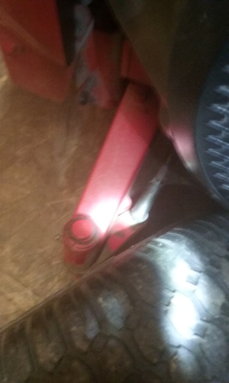

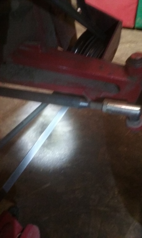

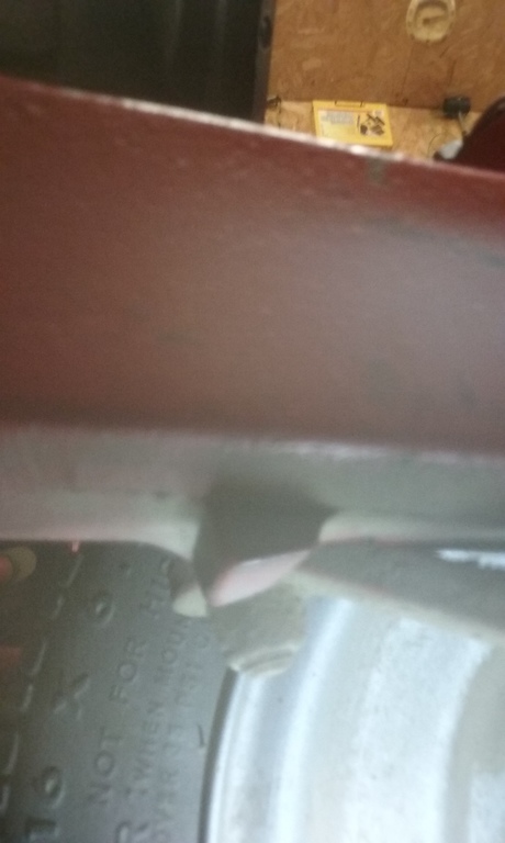

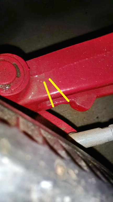

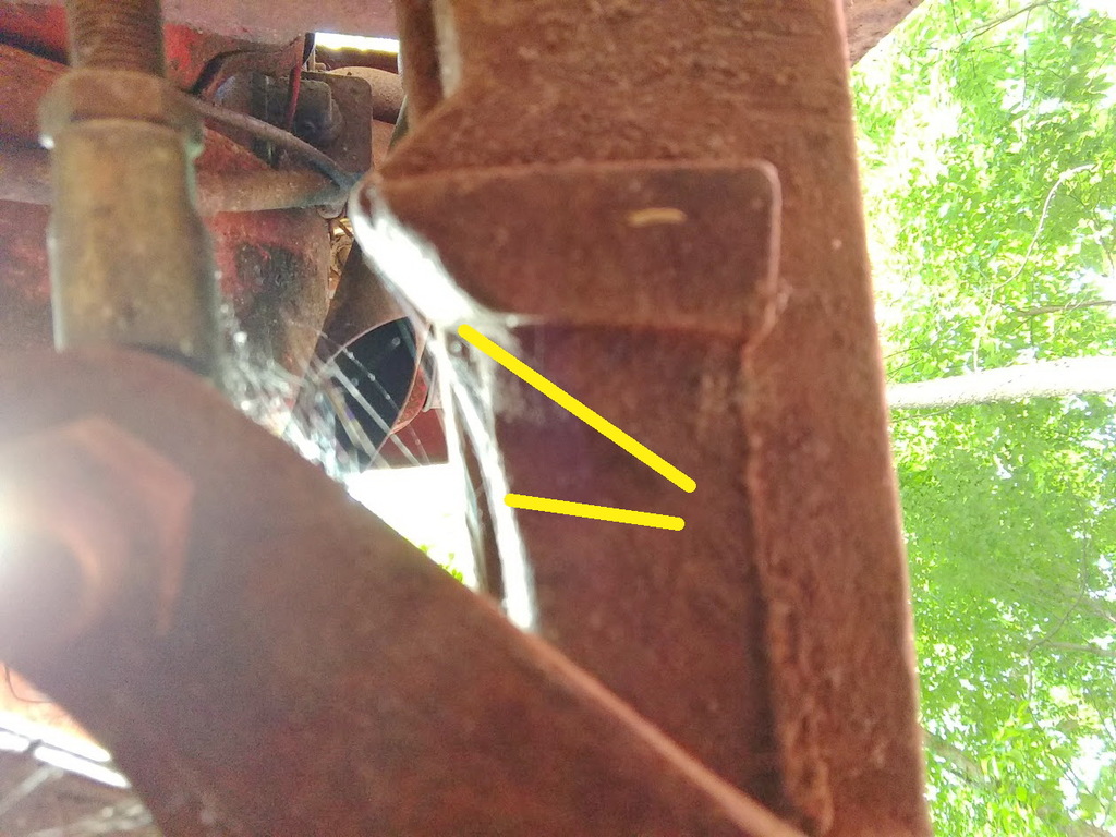

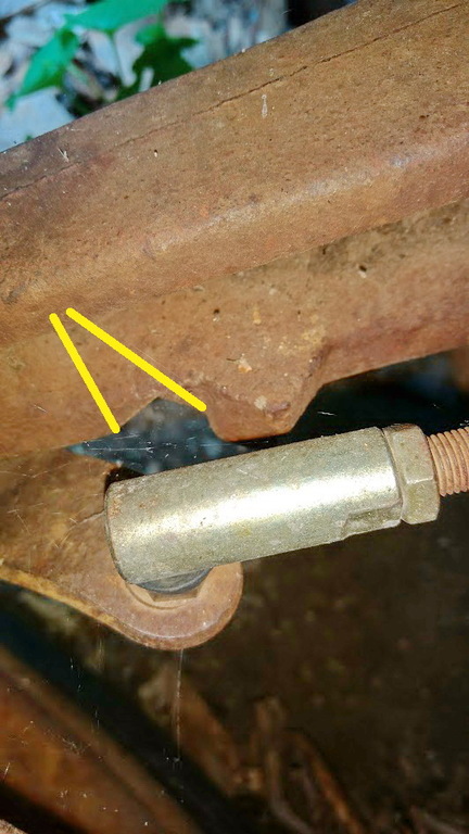

rmaynard 16,771 #18 Posted June 17, 2017 (edited) So I'm still confused. I went out to the shed and pulled two horse out. The 1977 B-100 and 1968 Commando 8. Both have the same axle, both have the notch. The notch are on the underside and are depicted by the yellow lines. With the wheels turned left to the full extent, the spindle arm of the B-100 does not enter the notch. The Commando 8 is the same. I tried to get a shot from the underside of the B-100 as well. If the spindle arms are disconnected from the tie-rods, yes, they can move into the notch, however under normal operating conditions that is not the case. I'm still scratching my head. Edited June 17, 2017 by rmaynard 2 Share this post Link to post Share on other sites
Cee245 850 #19 Posted June 17, 2017 Not sure @rmaynard On my 97 416, the spindle arm enters the notch most noticeable from underneath. Now, if you use the steering wheel to turn all the way left, the spindle arm doesn't enter the notch as much as grabbing the tire and pulling it a little further into the notch. I just did this... try it, and let me know Cory 1 Share this post Link to post Share on other sites
Racinbob 12,508 #20 Posted June 17, 2017 That's weird. My 160 wouldn't hit the stop if not for the notch. I lowered it to the ground and the same thing. Same with the 500 Special. Bob, what is physically stopping your steering? 2 Share this post Link to post Share on other sites
rmaynard 16,771 #21 Posted June 17, 2017 I have to agree with Cory that the notch is for spindle arm clearance, however, I turned the steering wheel and pulled the tire on both tractors, and the results were the same, not even close to the stop or the notch. However...the 416-H is a different story. Thanks for starting an interesting thread. There's always something new to be learned. 5 Share this post Link to post Share on other sites
squonk 45,083 #22 Posted June 17, 2017 I rechecked my axles after I was confused by Hillbilly's pic of the notch on his PTO side. My C-160 and 1267 have the notch but my 520 which does not have the original axle on it does not. 2 Share this post Link to post Share on other sites
WVHillbilly520H 10,377 #23 Posted June 18, 2017 Sorry for the confusion, from the original pic the axle looked slightly skewwed (or swept) to me but on the same token I did say... On 6/16/2017 at 3:32 PM, WVHillbilly520H said: , or for tie rod clearance when turned full lock, Jeff. Jeff. 1 Share this post Link to post Share on other sites
