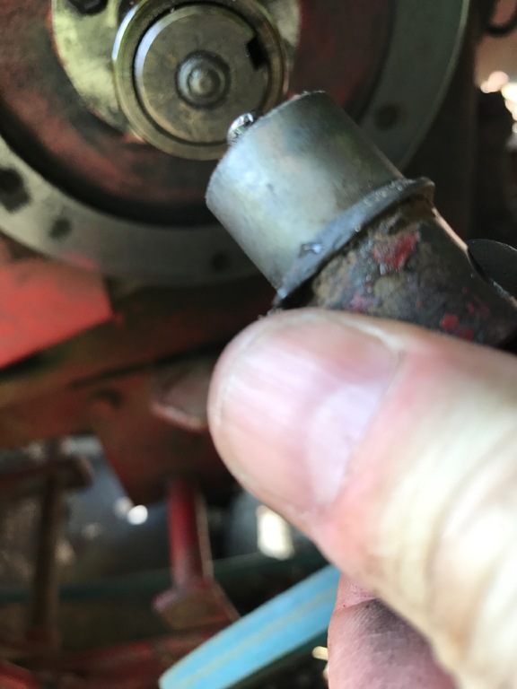

zeke37 24 #29 Posted June 17, 2017 I am now holding the PTO shaft in my hand. Sure there are other parts to be replaced. How far should I go? I'll send a pict as soon a it becomes available. -Thanks....Tim Share this post Link to post Share on other sites

zeke37 24 #31 Posted June 17, 2017 Hello- think I figured it out., the PTO shaft seems to have sheared the bolt in. I have removed the pulley. what next..don't want bang on anything too much,.....any info is much appreciated... Share this post Link to post Share on other sites
953 nut 67,944 #32 Posted June 17, 2017 10 hours ago, zeke37 said: Yes it did, and i just downloaded a drawing of the mule drive and spacers and it is clear that I am missing one. So if the PTO stops when I am mowing tall grass is there something else I need to look at? Thanks again. If the spacers are missing from the PTO your pulleys are causing a significant drag which probably contributed to the clutch problem. You need to address both problems. Share this post Link to post Share on other sites
