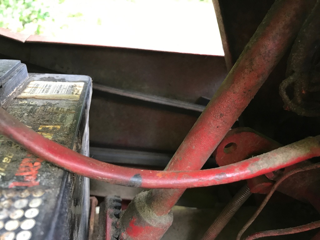

zeke37 24 #1 Posted June 16, 2017 Wondering- is this the Drive Belt? After rebuilding the deck and new belts still lacking power. Happened to notice that this belt is loosy goosey but is not in bad condition. Can I tension this or does the whole thing have to come apart? Share this post Link to post Share on other sites
Texas Todd 1,026 #2 Posted June 16, 2017 That is the drive belt. The idler pulley should apply tension to it when you release the clutch pedal. It should only be loose if the idler pulley isn't in place with the spring putting tension on the belt. Or the clutch is held down. Share this post Link to post Share on other sites
zeke37 24 #3 Posted June 16, 2017 so can i increase the tension. it is really loose. Share this post Link to post Share on other sites
gwest_ca-(File Mod) 12,281 #4 Posted June 16, 2017 I believe this C-160 has a hydro transmission Garry Share this post Link to post Share on other sites
953 nut 66,634 #5 Posted June 16, 2017 Was the old belt tight and working properly? The spring or tensioner that applies tension is a fixed piece, are you sure the new belt is the correct size. This manual could be helpful. Share this post Link to post Share on other sites
Texas Todd 1,026 #6 Posted June 16, 2017 4 minutes ago, gwest_ca said: I believe this C-160 has a hydro transmission Garry Woops. Disregard my previous comment! Share this post Link to post Share on other sites
zeke37 24 #7 Posted June 16, 2017 so maybe a new spring? I went through rounds on the belt. seems good 1/2" by 84" I think. It is the drive belt. Really floppy. No resistance upon compression. I tried to video but can't do it for some reason. but that belt is as loose as can be, and when I try to cut tall gras the blades stop spinning. Share this post Link to post Share on other sites
R. L. Addison 300 #8 Posted June 16, 2017 (edited) Has someone replaced the drive pulley on the engine? Or the idler pulley? I have a C141 that has thrown the belt off on occasion, and I think it may be for that reason. The top side of that belt will not be, nor does it need to be, as tight as the bottom as the power is supplied through the pull of the engine. This belt runs clockwise as it is seen in this picture, so as long as it is tight enough to stop any slippage, it should be good to run. That is not to say that it should flop around when engine is running. This belt drives the transmission, and has nothing to do with the mower blades on a C160. That belt goes from the engine forward around "mule drive" and down between tractor & mower deck to drive the mower blades. Edited June 16, 2017 by R. L. Addison Share this post Link to post Share on other sites
zeke37 24 #9 Posted June 16, 2017 not sure about the history of the drive belt.....I bought this from a person who kind did whatever he could to make the mower run. I have a 7473 0n hand. Is this the correct belt? It was strong before the spindles failed, now very little energy. Also I think that I am confused as to what id the "drive belt" and to what is the belt that goes from the PTO pulley to the mower deck. Perhaps y'all can straighten me out on that. I am looking at the diagrams on line but am still having a hard time figuring it out. 1 Share this post Link to post Share on other sites

zeke37 24 #11 Posted June 16, 2017 the mower deck, the tractor is fine, new belts, but when I hit a high patch of grass she bogs down. never did that before. and the drive belts is clearly not right. so my question is is there a way to tension that drive belt? Share this post Link to post Share on other sites
nylyon-(Admin) 8,964 #12 Posted June 16, 2017 Does the engine bog down, or just the deck slow down? If the deck, you can tighten the trunion on the PTO if it's slipping at the PTO. Share this post Link to post Share on other sites
953 nut 66,634 #13 Posted June 16, 2017 15 minutes ago, zeke37 said: question is is there a way to tension that drive be The MOWER drive belt! Your mule drive has a knob on the front to tension the belt, Turn it counter clockwise to tighten, Look at the manual I attached earlier. Share this post Link to post Share on other sites
zeke37 24 #14 Posted June 17, 2017 Done that. Still bogging down. The belt pictured is interior an is loose as can be. The mower seems fine the deck bogs down. My belt tension from mower to deck is good. Share this post Link to post Share on other sites

zeke37 24 #17 Posted June 17, 2017 I've done that and the blades quit spinning so I had to turn the trunion back, but am curious about the spacers on the mule. I have one on the outer side and thought that the inner one was attached to the inside pulley. would missing that be enough to slow the mower so dramatically? Also would the inner drive belt being so loose have anything ton do with loss of power? This mower has been rigged by the previous owner and Im am having to work backwards to get it running smoothly again.I really appreciate all of the information that y'all have been offering me. Share this post Link to post Share on other sites
Ed Kennell 46,233 #18 Posted June 17, 2017 1 hour ago, zeke37 said: Done that. Still bogging down. The belt pictured is interior an is loose as can be. The mower seems fine the deck bogs down. My belt tension from mower to deck is good. You say the mower ( I assume you mean tractor) seems fine. You say Belt tension from the tractor to the deck is good. The third belt is under the deck belt cover and connects the two side blade pulleys to the center drive pulley. Is this the belt that is loosey goosey? This belt has a spring loaded tensioning pulley that keeps the belt tight on all three blade pulleys. 3 Share this post Link to post Share on other sites
