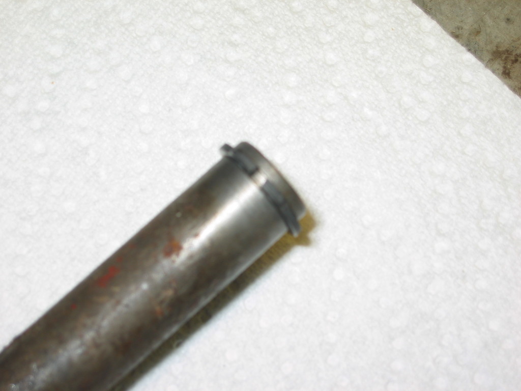

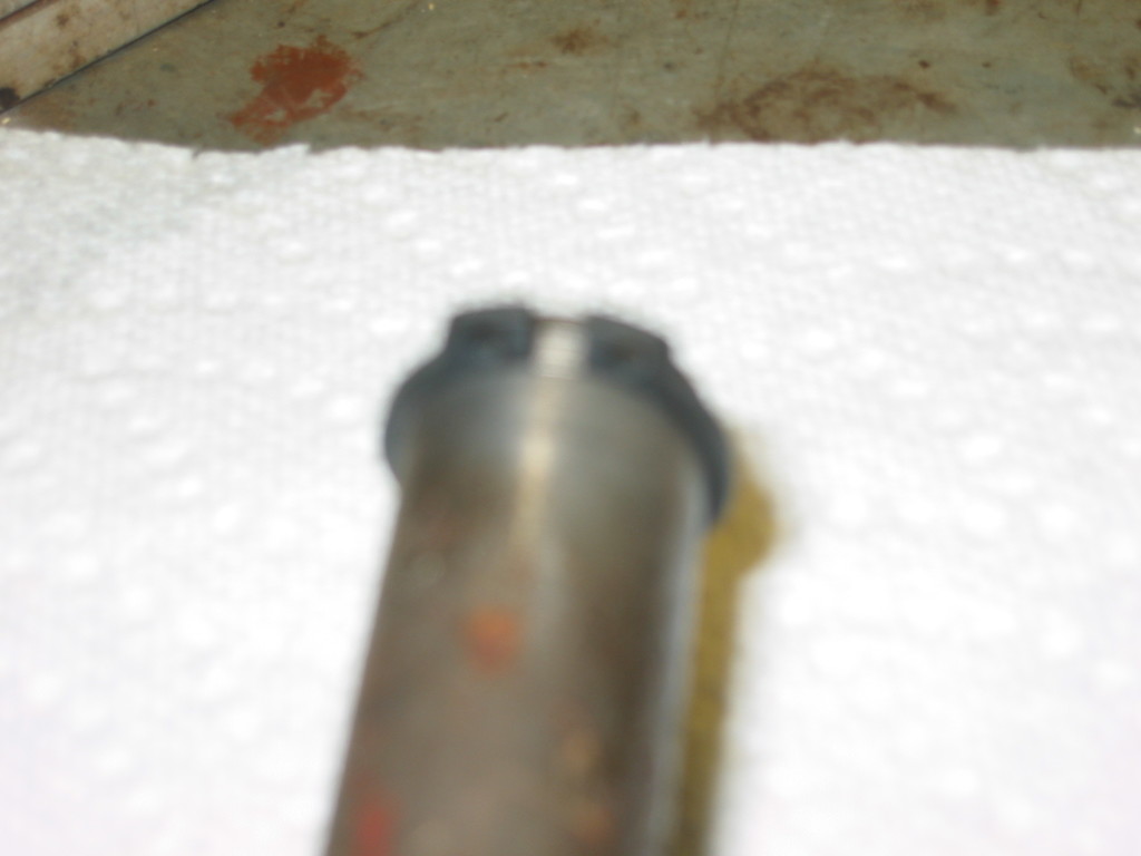

Racinbob 13,200 #1 Posted June 16, 2017 (edited) I've been giving the C-160 a much needed going over and found a multitude of things that needed to be done before I put her back in service. I pulled the front wheels to clean up and replace the bearings. The original B/C series utilized a bolt in the end of the axle but these have been replaced since it was mine last. The axles now use an external snap ring. After I got all the grease cleaned off I noticed that the groove in the axle was much wider than usual and required a wider snap ring. The correct one is about 1/16" thick and one axle was correct. the other one had a 'typical' snap ring that was too thin. I looked at a couple other models looking for one that used these and didn't find one. Rather than searching all the models known to Cecil Pond can any of you guys give me a part number for this wide snap ring? I can double up with what I have while i finish up my repairs have but I don't want to work it like that. Edited June 16, 2017 by Racinbob Share this post Link to post Share on other sites

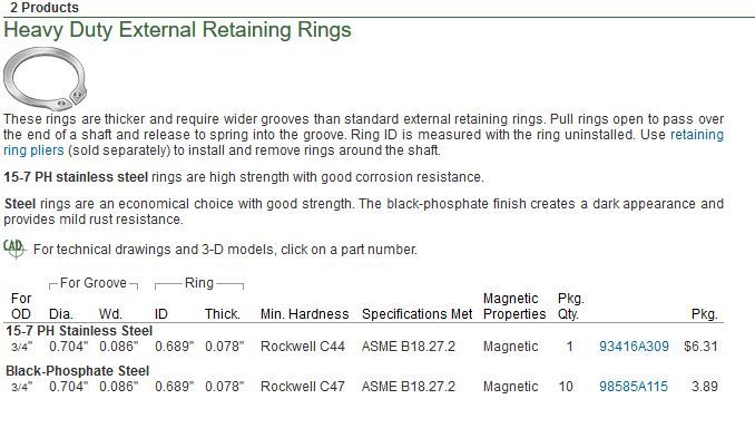

pfrederi 21,176 #2 Posted June 16, 2017 (edited) Buy a box of 10 for less than the part will cost. Be fixed for life https://www.mcmaster.com/#external-retaining-rings/=183hazy Edited June 16, 2017 by pfrederi 6 Share this post Link to post Share on other sites
squonk 48,156 #3 Posted June 16, 2017 Yup! Heavy washers, snap rings, axle keys, funky headed bolts, McMaster-Carr is DA BOMB! 3 Share this post Link to post Share on other sites
Racinbob 13,200 #4 Posted June 16, 2017 It no longer amazes me that I learn something new everyday on this forum. I've never run across these things before. My first reaction when I saw the wide groove was but a closer look told me it was made that way. Paul is being so kind to fix me up for now but I need to keep McMaster Carr in mind. A big to Paul. 4 Share this post Link to post Share on other sites
