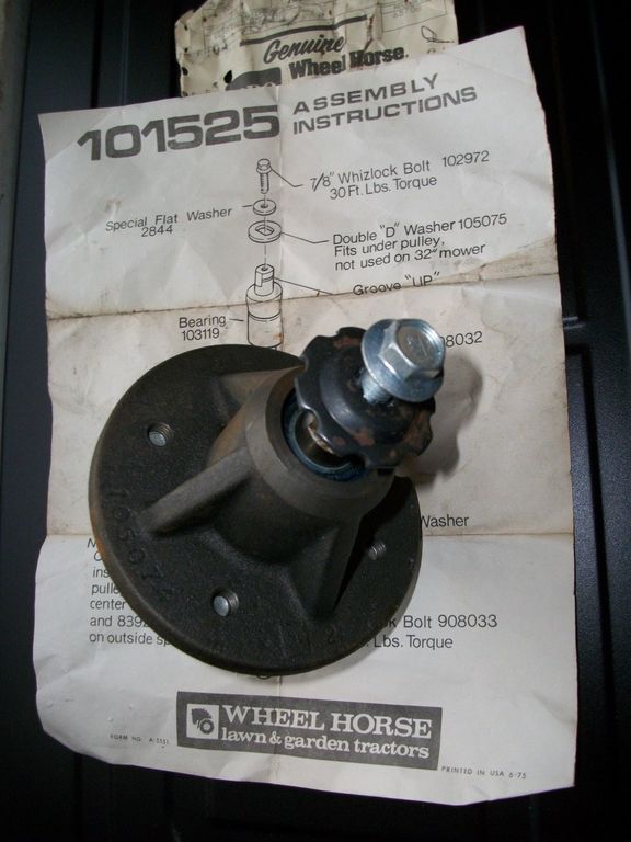

daveoman1966 3,884 #2 Posted June 16, 2017 This is one of the decks using the Double-D spindle assembly and I have a few good used spindles available. Here is a SAMPLE pic of the spindle(s) I have. I ahve a couple of the pulleys for left or right side, but I do not have the 2-belt center pulley. for further info, contact me via email... my email is: daveoman@windstream.net 1 Share this post Link to post Share on other sites

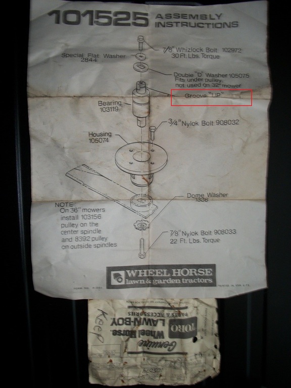

gwest_ca-(File Mod) 12,460 #3 Posted June 16, 2017 Sorry all we have is a parts list with no illustration Garry Share this post Link to post Share on other sites

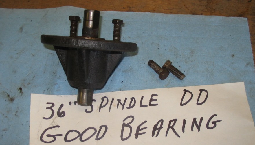

Ed Kennell 47,016 #4 Posted June 16, 2017 It does not appear this deck has the DOUBLE D spindles and pulleys. I have a 36" RD parts deck that I could remove these parts from. PM me If interested. Share this post Link to post Share on other sites

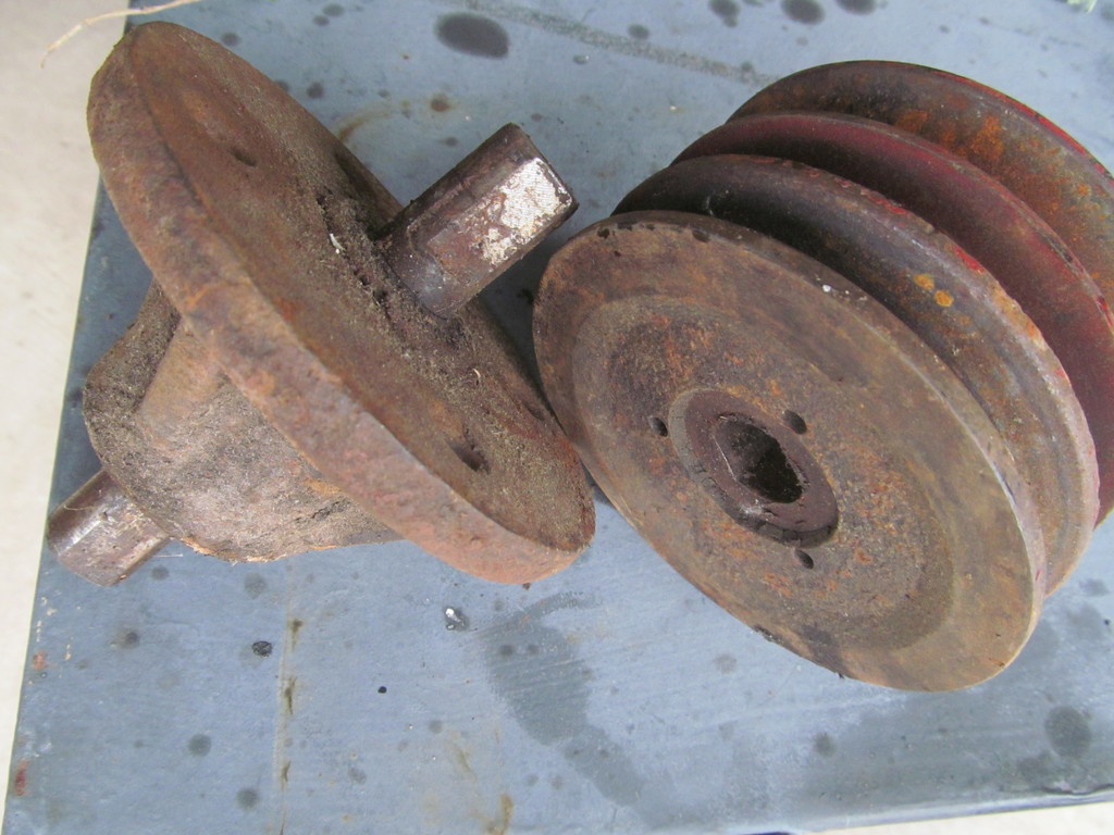

Indiana_Steve 125 #5 Posted June 16, 2017 Definitely need new front double drive pulley. Thinking of replacing bearings in the spindles. Is this a good idea? Share this post Link to post Share on other sites
Ed Kennell 47,016 #6 Posted June 16, 2017 Steve, just to clarify the nomenclature: The term DD or double D refers to the two flats on the spindle ends and the matching shape of the hole in the pulleys and blades. The single outboard pulleys and the two sheave center pulley will have this shape. You can see this shape in Dave's picture above. Having said that, according to the manual that Garry posted above, your deck does not have the DD type spindles. I am not sure if your spindles have the replaceable bearings Some of the spindles require a bearing/shaft assembly. Here is another picture of a DD type spindle and pulley. 2 Share this post Link to post Share on other sites
Indiana_Steve 125 #7 Posted June 17, 2017 Ed that's what I have. The pulley had come loose and the spindle shaft wore out the pulley. The shaft doesn't look bad. Have to re-thread the bolt holes for the pulley. Apparently PO didn't realize what all the noise from his deck was. Anyway, looks like bearings all around. Looks like you just push out shaft to replace them. 1 Share this post Link to post Share on other sites
daveoman1966 3,884 #8 Posted June 18, 2017 You are right on how to replace the bearing and it si # 103119. The old bearing will only come out one direction....and be careful not to break the casting as it is pretty thin at one end. You need to take the spindle cup off, then push the bearing up thru the casting. If you can't get the spindle cup off, thread in a short 3/8 hex bolt and MAYBE you can push thru the spindle cup and the casting. A hydraulic press works best. Share this post Link to post Share on other sites
