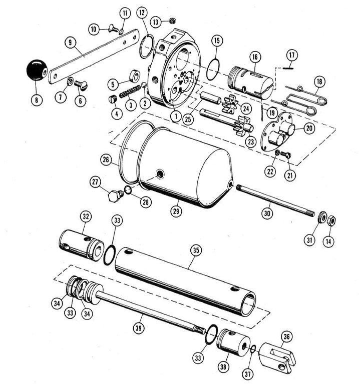

T-Mo-(Moderator) 4,752 #6 Posted June 14, 2017 Looks like I have to open the pump up. The spring is item 18 in the image below, I assume? It looks like Lowell sells them for $25 if this one is broken: https://wheelhorsepartsandmore.com/hydraulics.html#!/Wheel-Horse-Hy-2-Hy-3-spring-new-style/p/84960187/category=23548048 2 Share this post Link to post Share on other sites

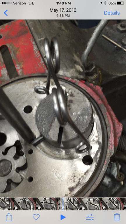

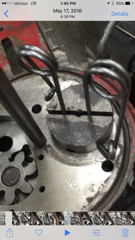

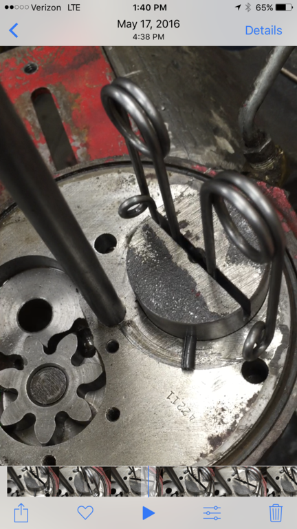

wheelhorseman 3,245 #8 Posted June 14, 2017 (edited) This is what happens on the inside of the pump with a good spring. The middle picture is the netrual position.(screenshots of a video) Edited June 14, 2017 by wheelhorseman 4 1 Share this post Link to post Share on other sites

kpinnc 17,144 #10 Posted February 6, 2022 50 minutes ago, Tinman1962 said: How do you go about opening the pump cylinder I believe I have a 1054 A thanks for everyone's help Scroll back up to the exploded view. Remove the nut #14, and the reservoir will come off. 1 Share this post Link to post Share on other sites

953 nut 64,085 #12 Posted February 6, 2022 7 hours ago, Tinman1962 said: opening the pump cylinder I believe I have a 1054 A Remove the fill plug and drain as much fluid as you can. Place the cast steel pump in a vise with the reservoir facing upward. Remove the nut on the end of the center shaft and your reservoir should pull off, may hav.e to unscrew it a bit. Lowell @wheelhorseman has all the parts you'll need 2 Share this post Link to post Share on other sites
