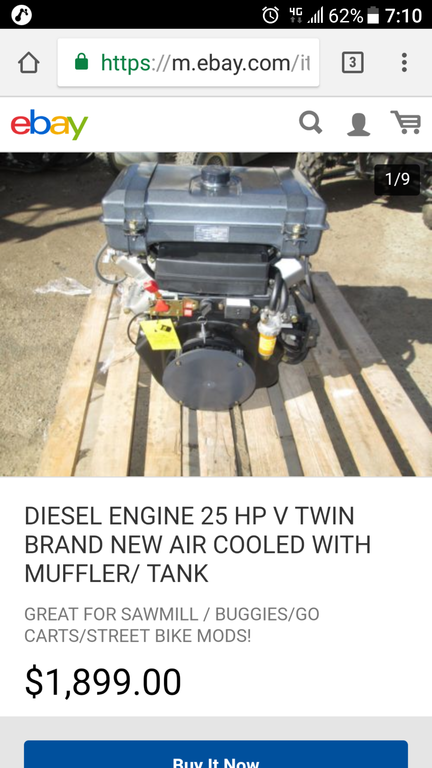

Skipper 1,790 #10 Posted September 21, 2017 (edited) Dos anyone have actual experience with the clones? I hear only people talking about what they have heard from a neighbors cousin. It would be cool with some real intel, and not just hearsay. My point is, that these clones are sitting in a great big number of genset's, pumps etc. If they are that bad, I would imagine there would be more hands on reports of it? I'm not trying so say they are good. I just do not know, and I have been thinking about swapping the big twin diesel clone in for a long time, but again, I have found absolutely zero first hand reviews. It's an engine like this I'm contemplating: https://www.alibaba.com/product-detail/25-Hp-Runsun-Diesel-Engine-Air_50019609195.html?spm=a2700.7724838.2017115.297.c4e09acytmJtd So if anyone has first hand intel, please enlighten us Edited September 21, 2017 by Skipper 1 Share this post Link to post Share on other sites

WVHillbilly520H 10,378 #12 Posted September 21, 2017 I have thought about this twin for a 520 diesel conversion , before all the nay sayers, a Briggs or Honda replacement would be about the same price, and this engine has an 1 1/8" shaft and probably won't ever run out of torque, Jeff. 1 Share this post Link to post Share on other sites
artfull dodger 440 #13 Posted September 21, 2017 I would just make sure you can "end load" the PTO bearing on that Vtwin diesel. The Yanmar engines that the single cylinders are cloned from cannot handle the end load that is applied to the crankshaft when the Wheelhorse PTO clutch is disengaged. Of coarse, you can go over to a electric PTO clutch and solve that problem. I do not know anybody that has taken the chance on that V twin diesel yet. The singles are hit and miss. Carroll Stream Motors out of Michigan seems to have about the best reputation in the USA for quality on thier clones. They also have the "Chonda" clone gas engines(Honda clones). The biggest thing is to first drain any crankcase oil out that is in them, then only run them a few min at idle after filling with oil, and change it again and flush the oil pickup screen if so equipted(some have this feature). Getting any remaining debris out of the crankcase is key to giving them a fighting chance. I had two of the Carroll Stream 4.5hp diesels(no longer imported due to EPA regs) and both ran fine after dealing with a few minor fuel leaks/loose fittings. One is in a RS members round hood somewhere in northern Indiana. I chose to go with a genuine(which I have less $$ in than a clone) as my horse at that time was a worker and source of income. Potentially throwing away a bit over 500 bucks on a clone that might or might not live more than a few hours while cutting grass was not an option. Mike 1 Share this post Link to post Share on other sites
