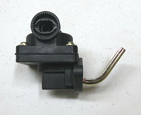

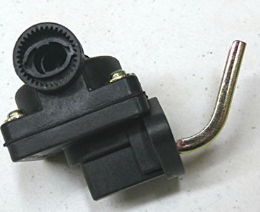

rmaynard 17,585 #3 Posted June 12, 2017 This is a typical mounting position. As Paul said, tilt the pump as depicted below. You can also shine a light into the hole to see where the cam is, and aim the arm over top of it. 4 Share this post Link to post Share on other sites
