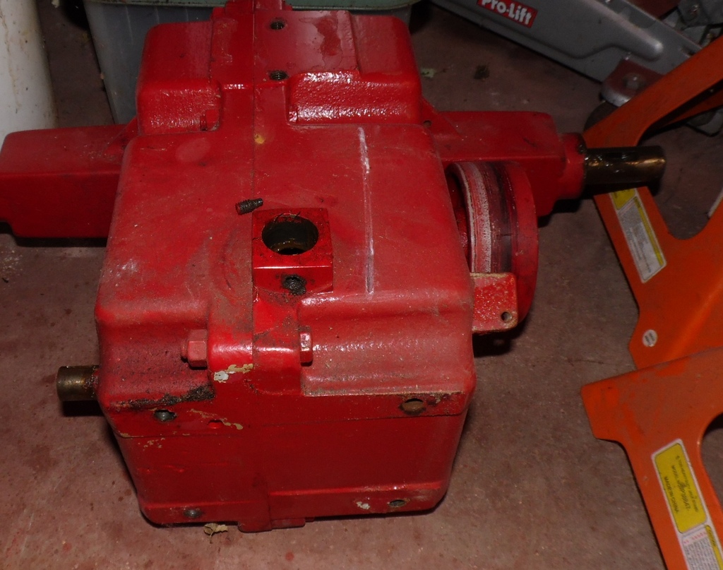

mikeeyre74 290 #5 Posted June 14, 2017 Got the parts here finally. Here's some pictures: This shifter itself comes right out of the socket and I'm not familiar enough with these to know why that is or what holds it in the right place otherwise, but it shifts through all the gears and works as it should otherwise, if you hold the shifter in place. Any idea what this is from now, with that 3900 code on the side? 1 Share this post Link to post Share on other sites

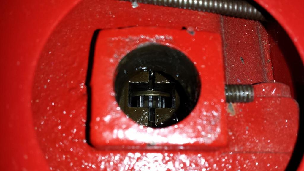

Molon_Labe 731 #7 Posted June 16, 2017 (edited) Pretty sure the 1973 8hp no name used 10" rear wheels with that type hub. There is a dog point screw that holds the shifter. Here's a pic, you can see where the screw goes at the front of the shifter. The screw is laying on top of the transmission. Edited June 16, 2017 by Molon_Labe Pic 2 Share this post Link to post Share on other sites
Lane Ranger 11,814 #8 Posted June 16, 2017 (edited) Those three bolt hubs are off of a Lawn Ranger . Those Lawn Ranger 3 speed transmissions are usually in very good shape as most Lawn Rangers did not get a lot of abuse, wear and tear. That transmission will interchange with other Wheel Horse models with no problem. I use to be able to buy these for $50 or less and bought everyone I could as they are great for other rebuilds. Hubs can change with little problem also. Edited June 18, 2017 by Lane Ranger 3 Share this post Link to post Share on other sites

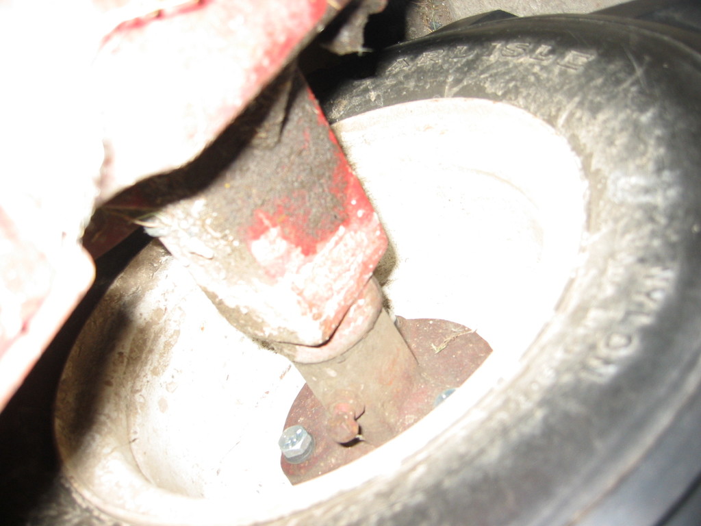

Racinbob 12,800 #12 Posted June 16, 2017 The 1973 8hp 4 speed used 10" wheels but I don't know if they had 3 or 5 hole hugs. I would guess 5 because the 1972 Commando 800 had 10" wheels and 5 hole hubs. The 1973 8hp 8 speed had 12" wheels and 5 hole hubs. @Lane Ranger have you only seen those on Lawn Rangers? That's the first 3 hole full circle hub I've seen but I've never messed with Lawn Rangers. Here's the more common 3 hole hub I was referring to in post #4. 1 Share this post Link to post Share on other sites

Racinbob 12,800 #14 Posted June 16, 2017 The 3900 you asked about is the case part number. Before inserting the shifter make sure the rails are positioned like this. When you run the dog point screw in to hold the shifter tighten it just enough until you feel resistance when you shift the gears then back it off a fuzz. Then, not shown, hold the setscrew and tighten the 1/4" lock nut. 1 Share this post Link to post Share on other sites

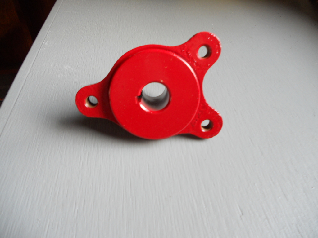

pfrederi 19,940 #15 Posted June 16, 2017 Pics of my L107 hubs. The studs are not original. 4 Share this post Link to post Share on other sites
mikeeyre74 290 #16 Posted June 16, 2017 Ahhhh.... that makes a lot of sense, the smaller hub diameter in the smaller wheel. I didn't think about that. Thanks! Share this post Link to post Share on other sites
stevasaurus 23,619 #17 Posted June 17, 2017 There are some numbers & letters up by where the shifter goes in. This is the casting date. It may not be able to tell you what transmission you actually have, but it could tell you which ones you do not have. Here is what you have at this point...5025, 5046,5048,5049 or a 5053. These are all basically the same transmission. These are all Section II in the transmission manual. The casting date may help eliminate one or two of these...maybe...understand that these trannys are really all the same as far as parts. 1 Share this post Link to post Share on other sites
