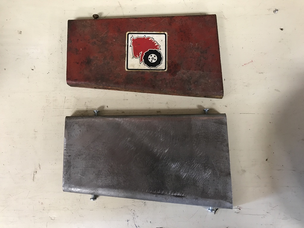

nylyon-(Admin) 9,054 #7 Posted June 12, 2017 OM Thank you! That's the last piece for the 50" Sickle ! Share this post Link to post Share on other sites
