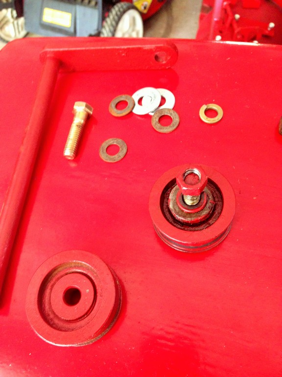

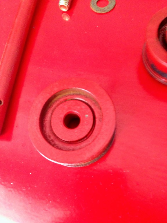

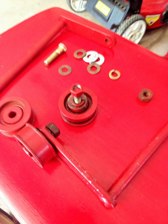

Lane Ranger 12,160 #1 Posted June 10, 2017 I have several RJ Wheel Horse idler pulleys, I would like to know if they can have the bearing in the center replaced? Mine are all sealed and still function but do seem to have a lot of wear as they generally have a little wobble when bolted onto the transmission. If anyone has replaced these bearings I would appreciate knowing and what type or model /size bearing is needed for replacement. Share this post Link to post Share on other sites
buckrancher 2,697 #2 Posted June 10, 2017 the bearing and pulley are the same thing if I am remembering correctly the outer race of the bearing is the pulley Brian 2 Share this post Link to post Share on other sites
evanloock 269 #3 Posted June 10, 2017 1 hour ago, buckrancher said: the bearing and pulley are the same thing if I am remembering correctly the outer race of the bearing is the pulley Brian That's my understanding of the RJ pulley as well. I have a NOS one back in Alabama and recall a bearing co. name and number on the inner race. 3 Share this post Link to post Share on other sites
Lane Ranger 12,160 #4 Posted June 10, 2017 You know I was sure that Brian and Evanloock would be two of the folks to speak about this! And I am sure you guys know. I can read an imprint on one of my 2 inch pulleys that it was made in Philadelphia, PA. Thanks guys! 1 Share this post Link to post Share on other sites
buckrancher 2,697 #5 Posted June 10, 2017 (edited) the bearings are NLA should be "NICE" bearing company if remember correctly I have had good luck cleaning these in solvent and blowing them out with compressed air then if you have a needle tip for a grease gun you should be able to inject some new grease inside the bearing and save it Brian Edited June 10, 2017 by buckrancher 3 Share this post Link to post Share on other sites
VinsRJ 724 #6 Posted June 11, 2017 4 hours ago, buckrancher said: the bearings are NLA should be "NICE" bearing company if remember correctly I have had good luck cleaning these in solvent and blowing them out with compressed air then if you have a needle tip for a grease gun you should be able to inject some new grease inside the bearing and save it Brian 1 Share this post Link to post Share on other sites
